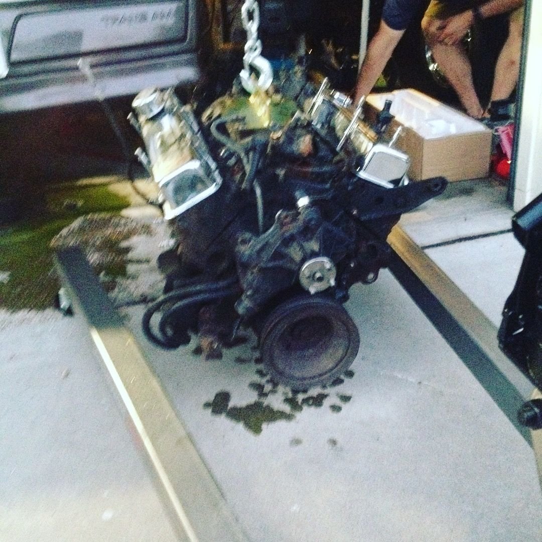

Hello, I appreciate the replies! This is Zack (son), and We just finished removing the engine and transmission yesterday. Decided to go *****-to-the-wall with it as a last second decision, yet I'm looking forward to getting my hands dirty and making this old daytona roadworthy again. Next is to remove the booster (again, because I just put a new one in lmao), petal assembly and come up with a nice (and long) parts list for the project. As for the LG4, any suggestions on a decent heads/cam combo? I've been looking into world S/R torquer 305 heads and a summit k1103 hydraulic flat tappet cam. Also wondering if the stock Q jet woud be okay to use with it, or if it would run too lean... Any better ideas would be appreciated, Just looking for some better low/mid range power and torque to make it a blast to drive (also have to beat my father's 87 vette for bragging rights...LOL).
