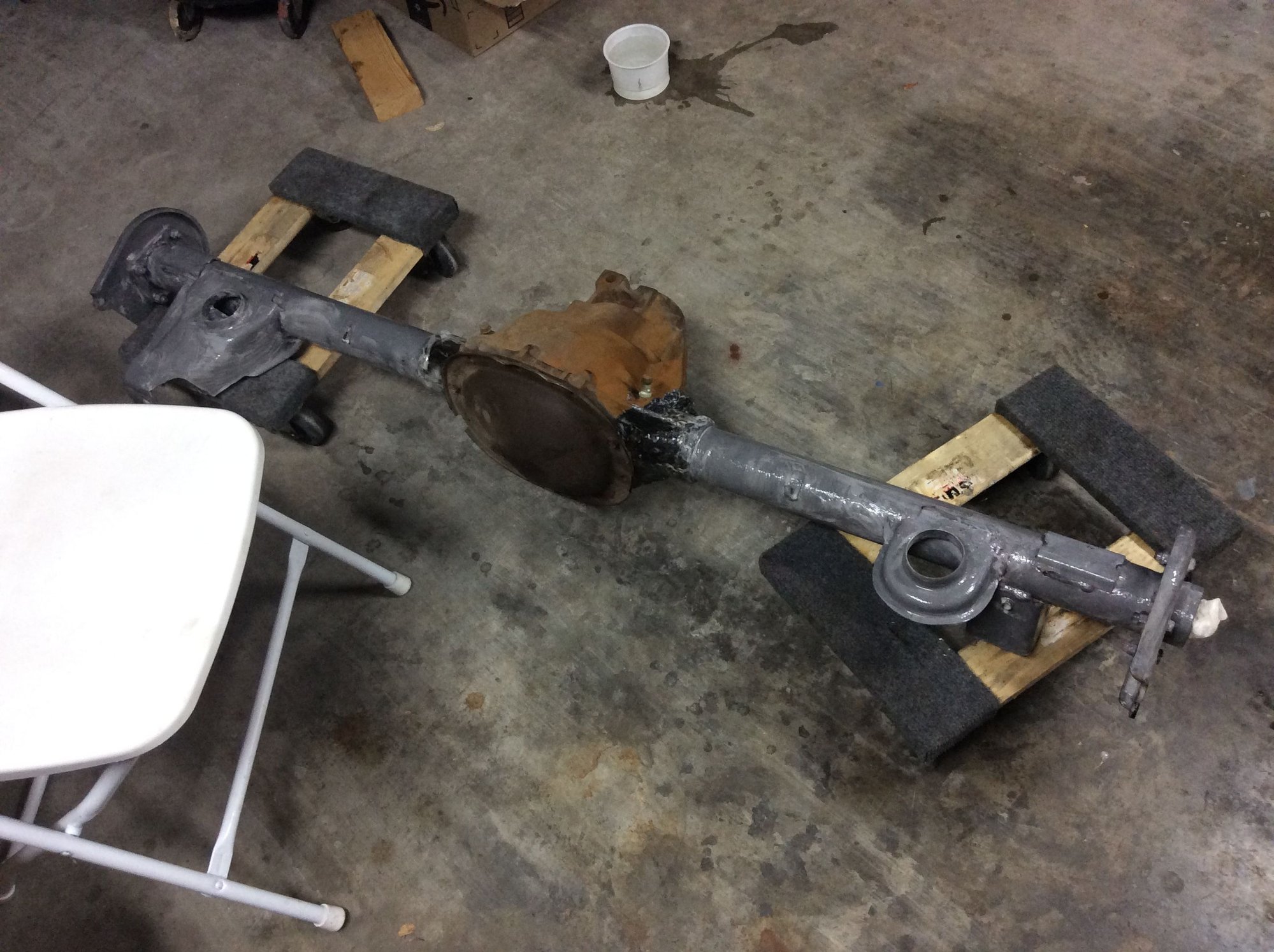

Re: Clean that diff like a monkey!
Navel Jelly works wonders. I haven't used a wire wheel much at all.

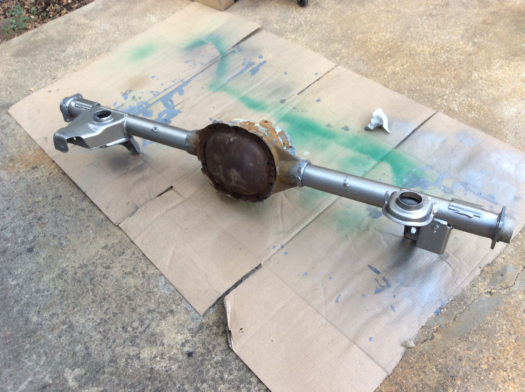

getting closer

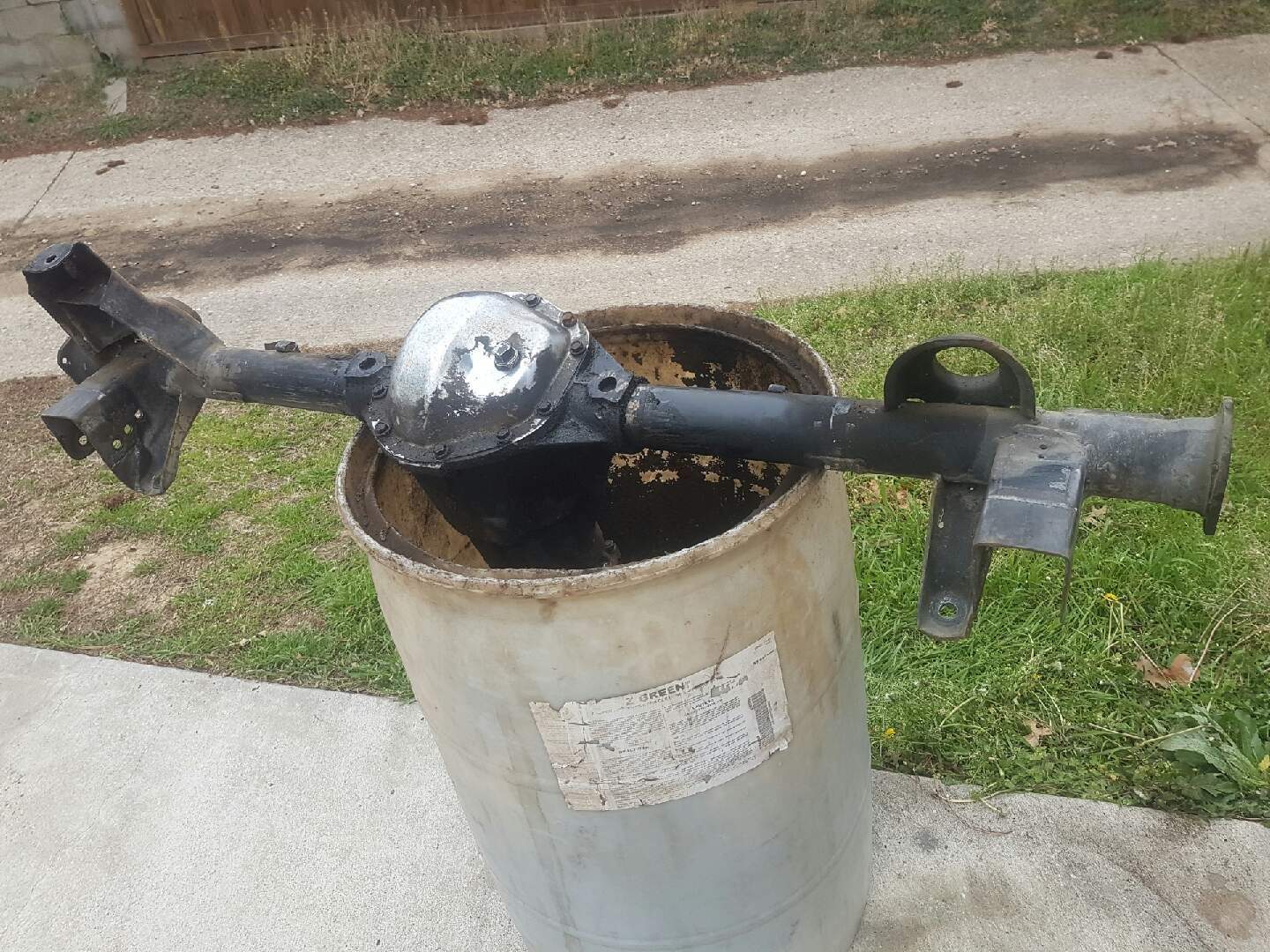

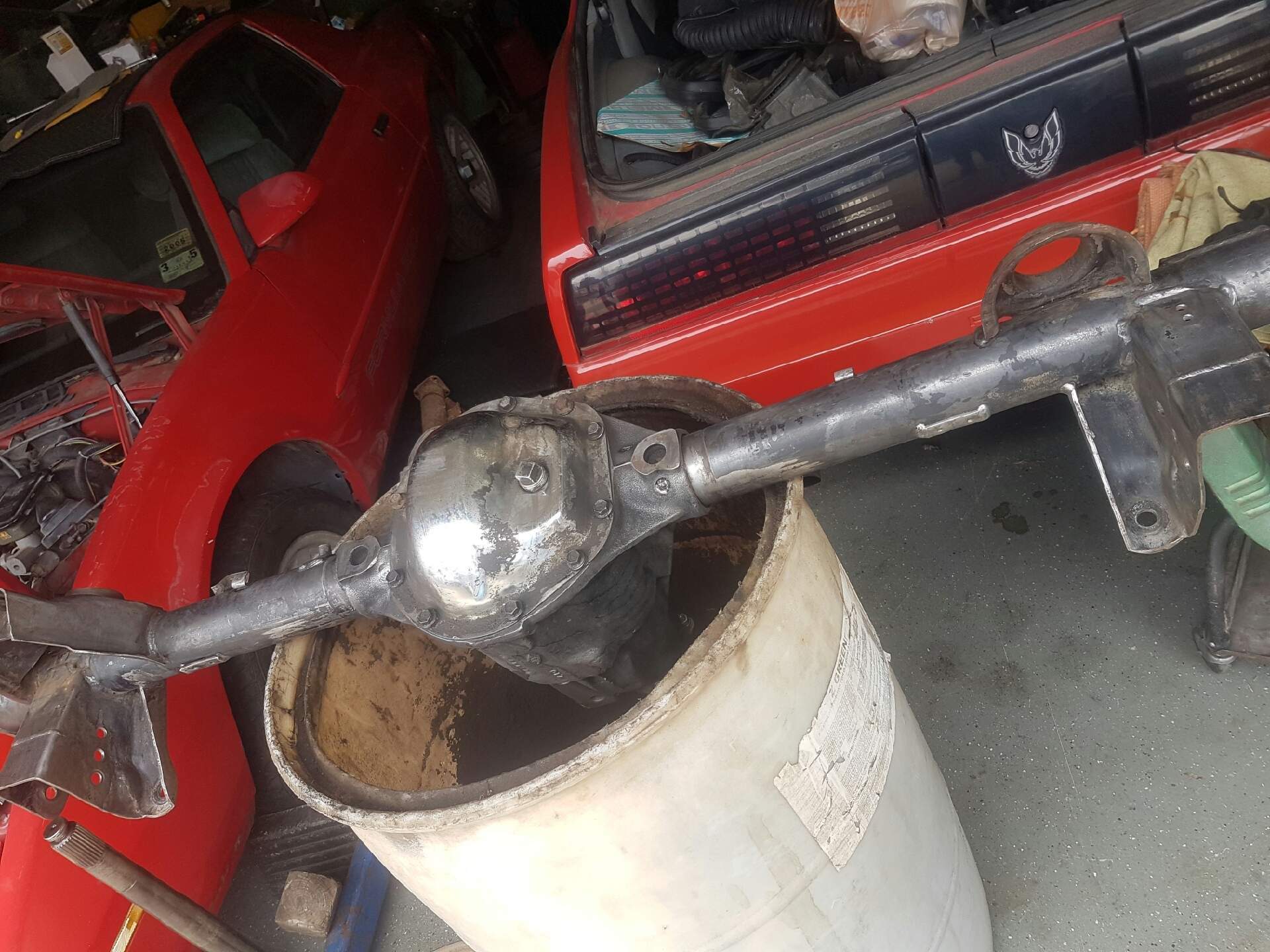

Here is before and after - this was a greasy pig!
the cup brush gets it to bare metal nicely in the areas it wont reach gotta use small hand brushes
and the end product with a rattle can

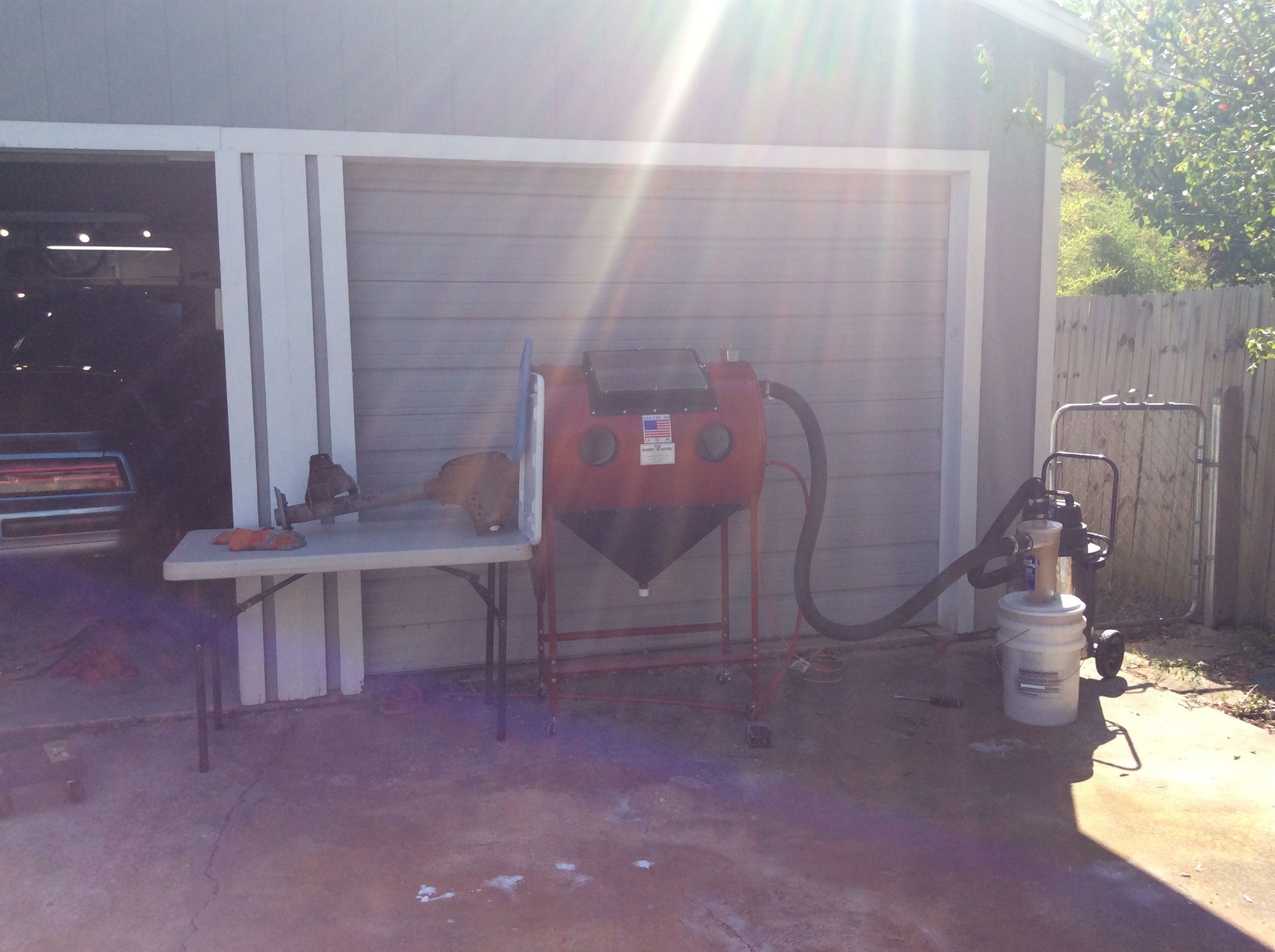

That's an interesting idea to get the housing blasted. I have thought about replacing or making something for the door on my cabinet too.
I ended up using a garbage bag and large tupperware lid combo. worked pretty decent, didn't lose too much media. just gotta secure the bag so it doesn't get sucked in by the vacuum. A big box would probably be better, but didn't have one.
How does that dust collector work? I recently got one but I haven't installed and used it yet.
it works pretty darn good. I tried installing a dust bag in the vacumme, as additional protection to the vac, but it just gets sucked out. maybe I need to zip tie it or something. the dust thing, really does collect debri, and media.
Originally Posted by LiquidBlue
like your 55 gallons support container idea. tough moving this thing around.
years ago I used to support rears with jack stands but one of my knees complained alot one day and decided that I need to stand up so the drum was a good cheap solution, it also catches alot of the crud that scrapes off, and its actually easier to move drum and rear around and back into my shop - sliding it versus lifting Up and down. Alot is my age when I was in my 30s it didn't affect me much and now 60 is around the corner, I have to respect I'm not the animal I used to be

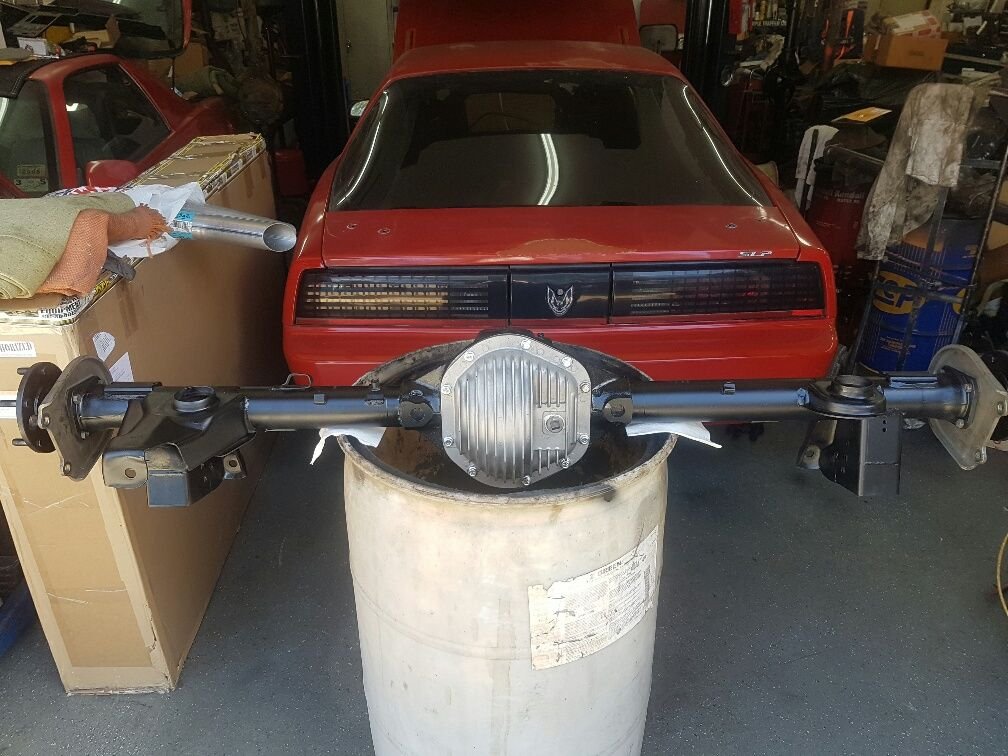

Old Oct 9, 2019 | 06:58 PM
LiquidBlue's Avatar
Joined: Jun 2015
Posts: 2,187
Likes: 243
From: Austin, TX
Car: 90 Formula / T-tops
Transmission: MD8

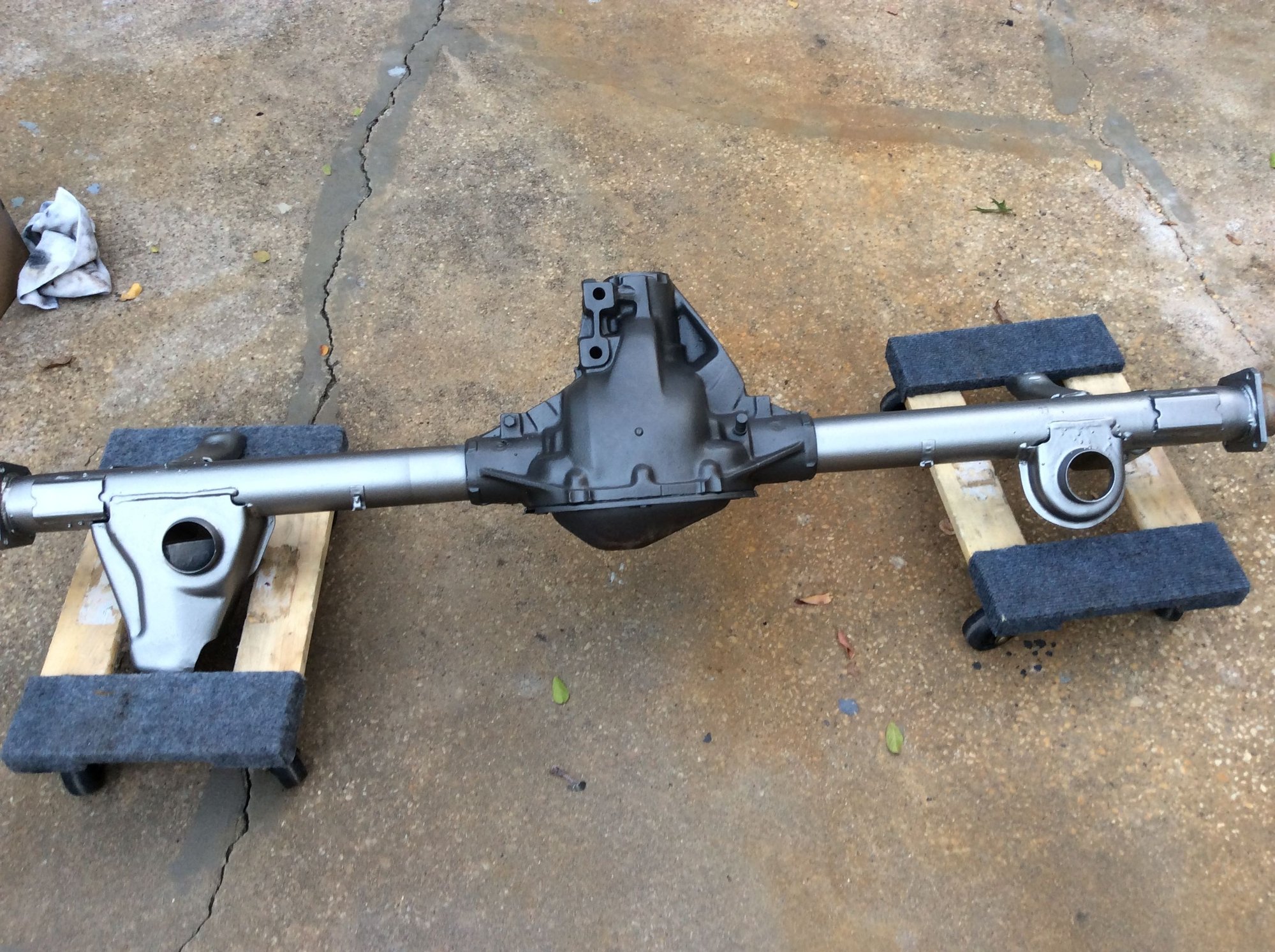

more progress.

Two tone looks good

Looks great. What kind of diff cover is that?
Old Oct 9, 2019 | 08:30 PM
LiquidBlue's Avatar
Joined: Jun 2015
Posts: 2,187
Likes: 243
From: Austin, TX
Transmission: MD8
thanks guys. trying to replicate the natural look that the car is delivered with. POR-15 colors. not nearly as good of a job as breaking out the paint gun, but I'm hoping it will be more durable. The diff cover is stock. I haven't cleaned it up yet. Just wanted to get the diff stop rusting while I rebuild it. will likely need to do some paint touch up by the time I'm done. also go the brake caliper mounts painted with Eastwood cadmium - its too bright, but hey, what can a guy do. now to knock out those axle bearings!
