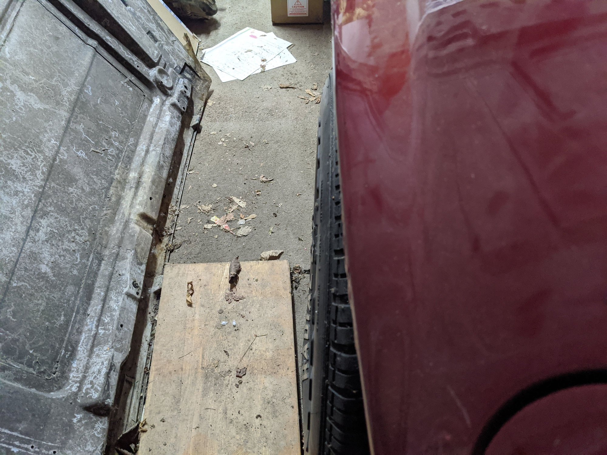

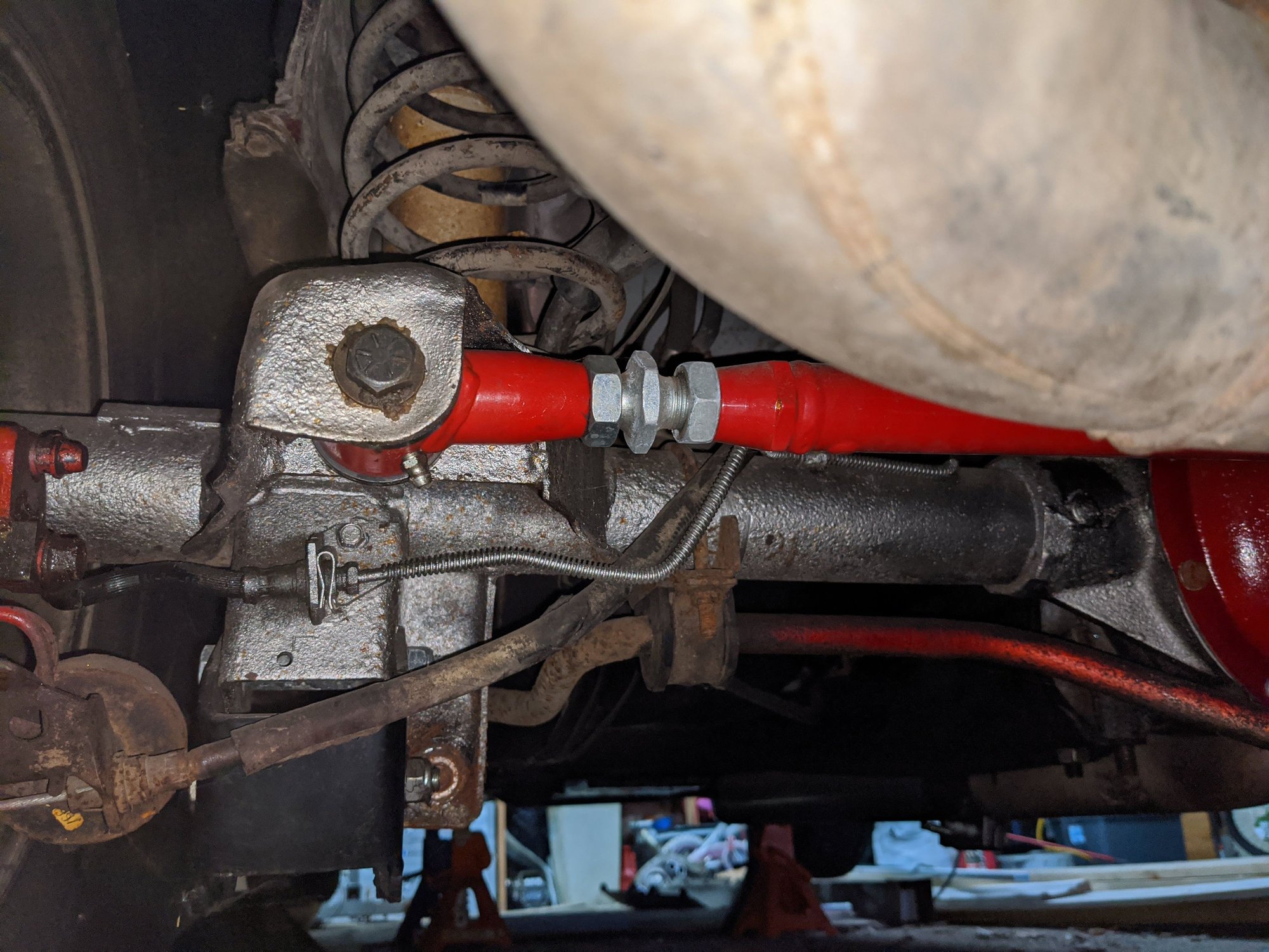

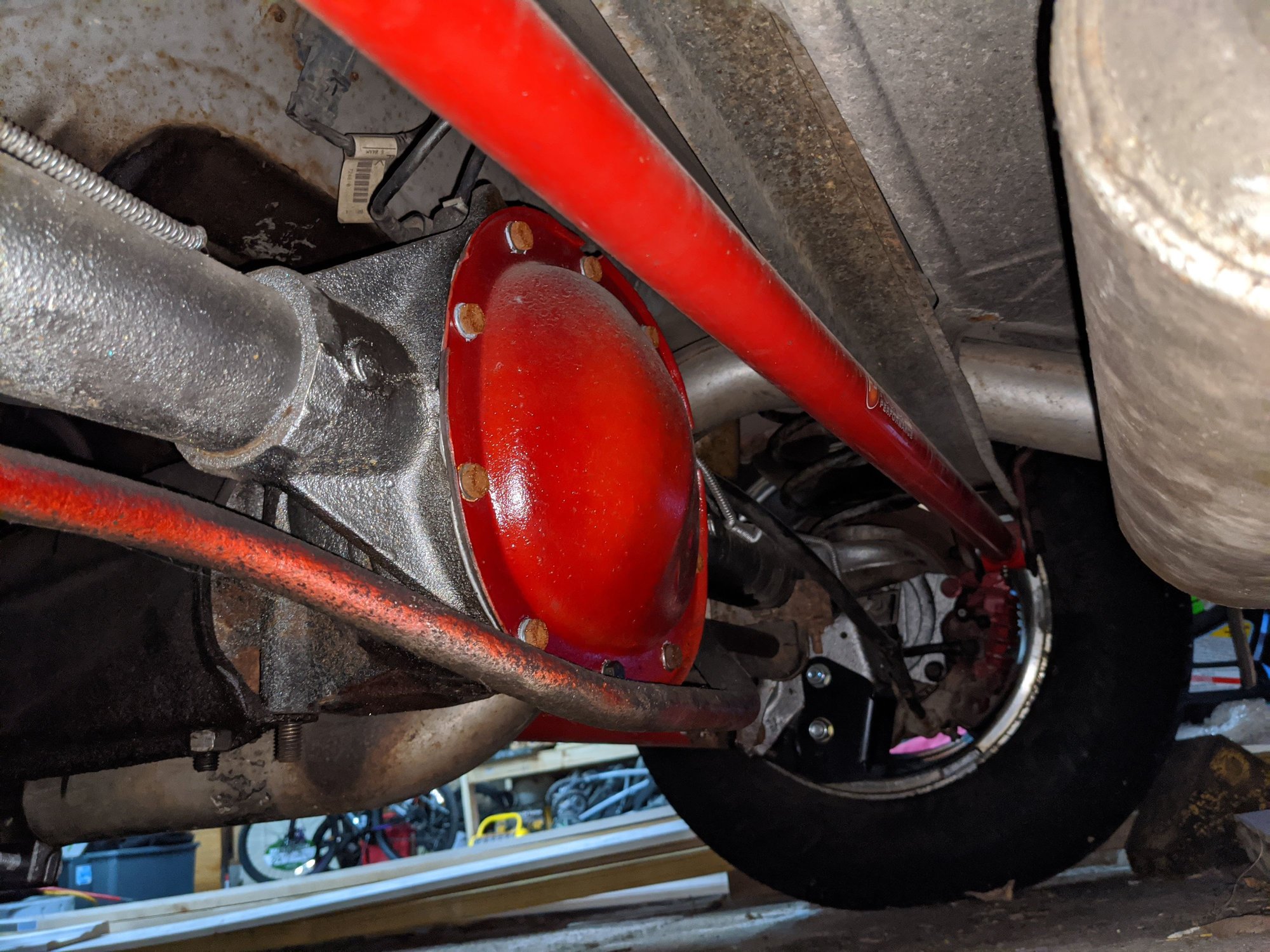

What did you do about the extra length of the rear end? Got any pics?

Went out to the garage to get a couple. I picked up my 4th gen rear for $250 and it came out of a 01 Camaro SS. Mainly I wanted the disc brakes in the back but the 3.42's was a nice addition. The extra width didn't bother me with stock 15 inch wheels.
Never mind the missing nut for the torque arm. It is coming off for a different project.
