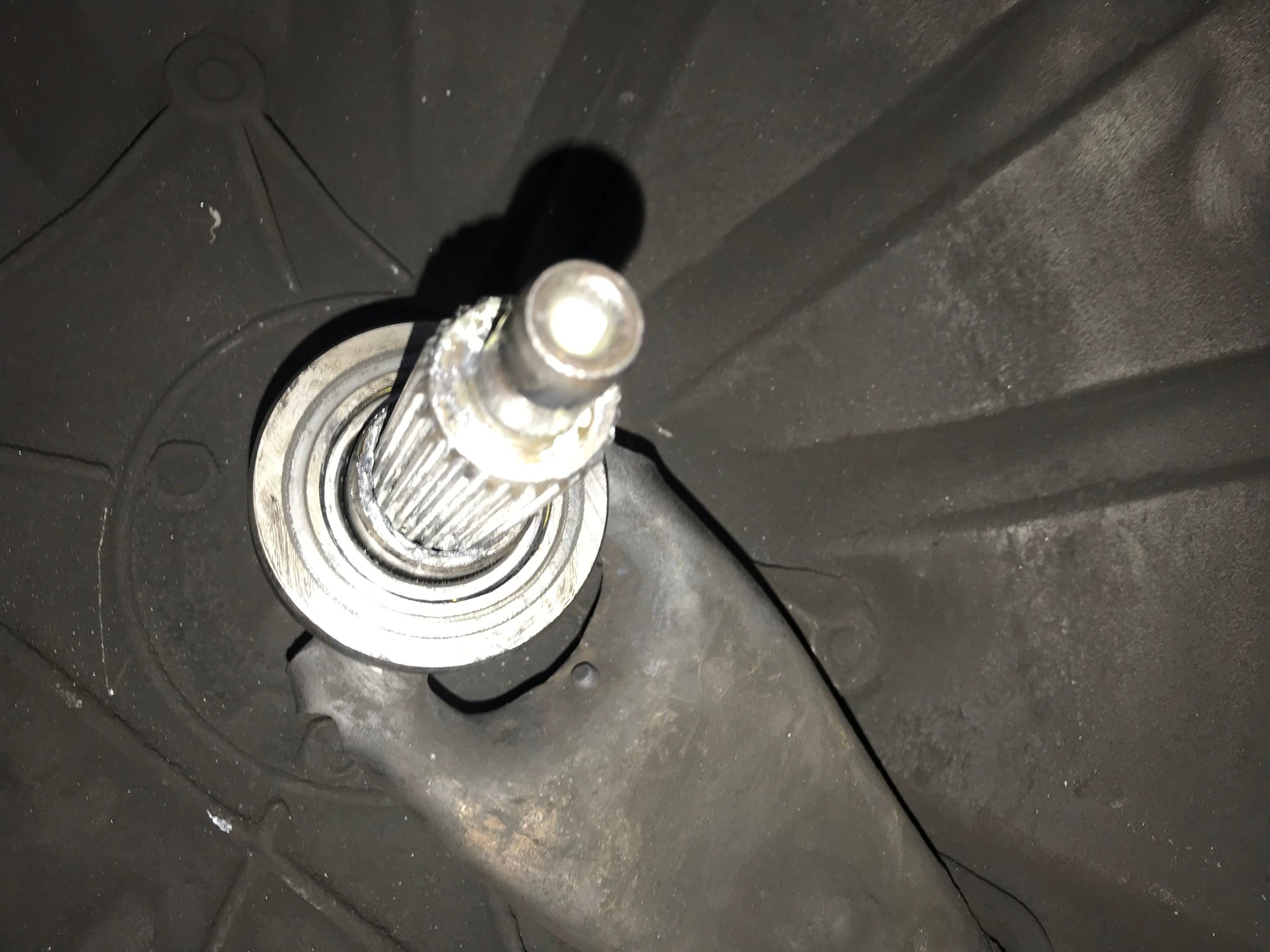

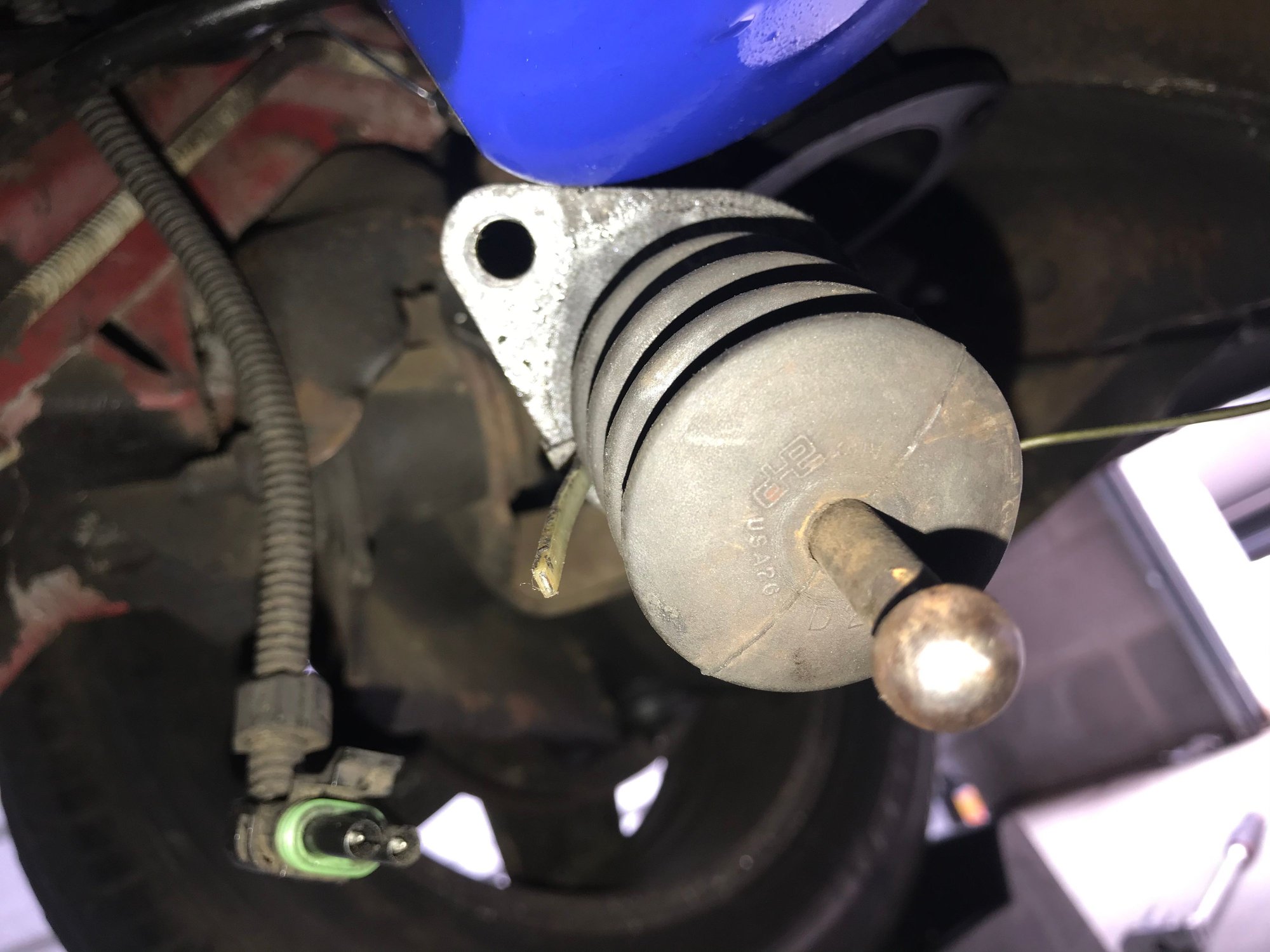

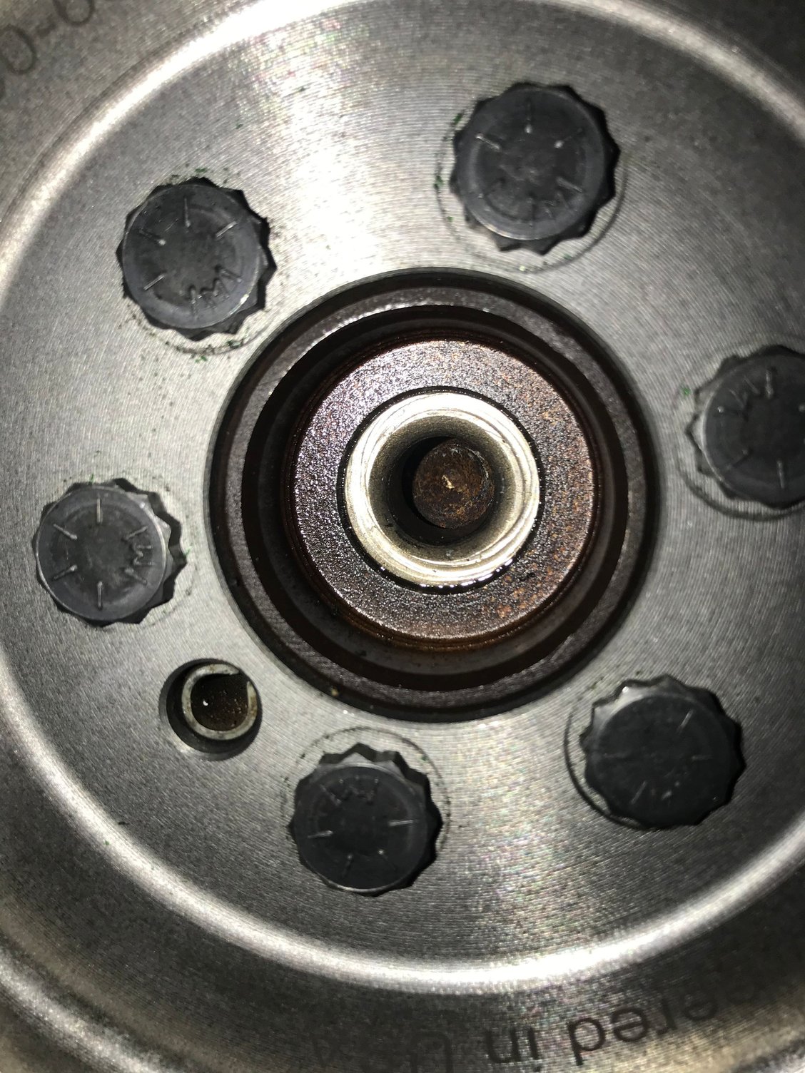

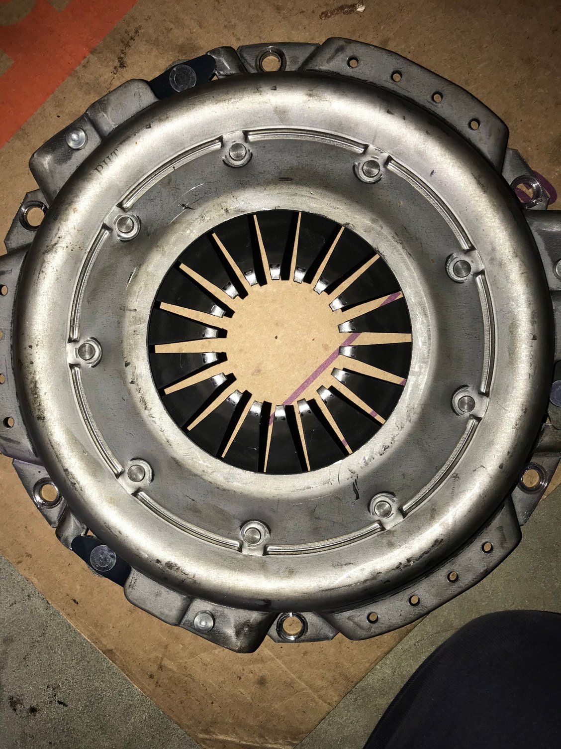

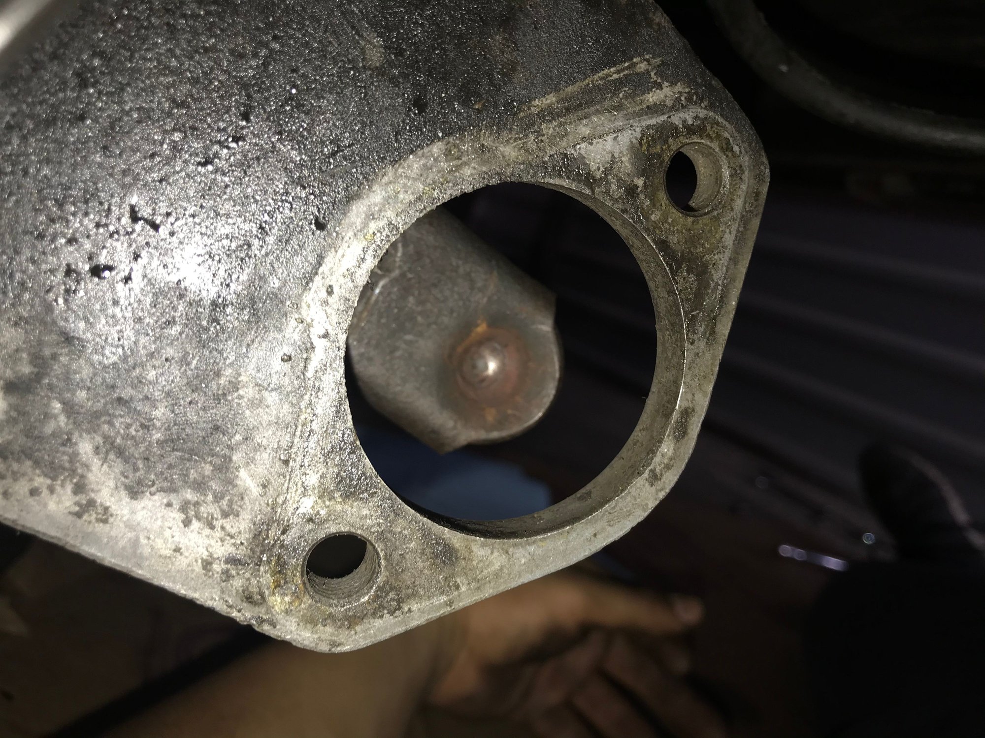

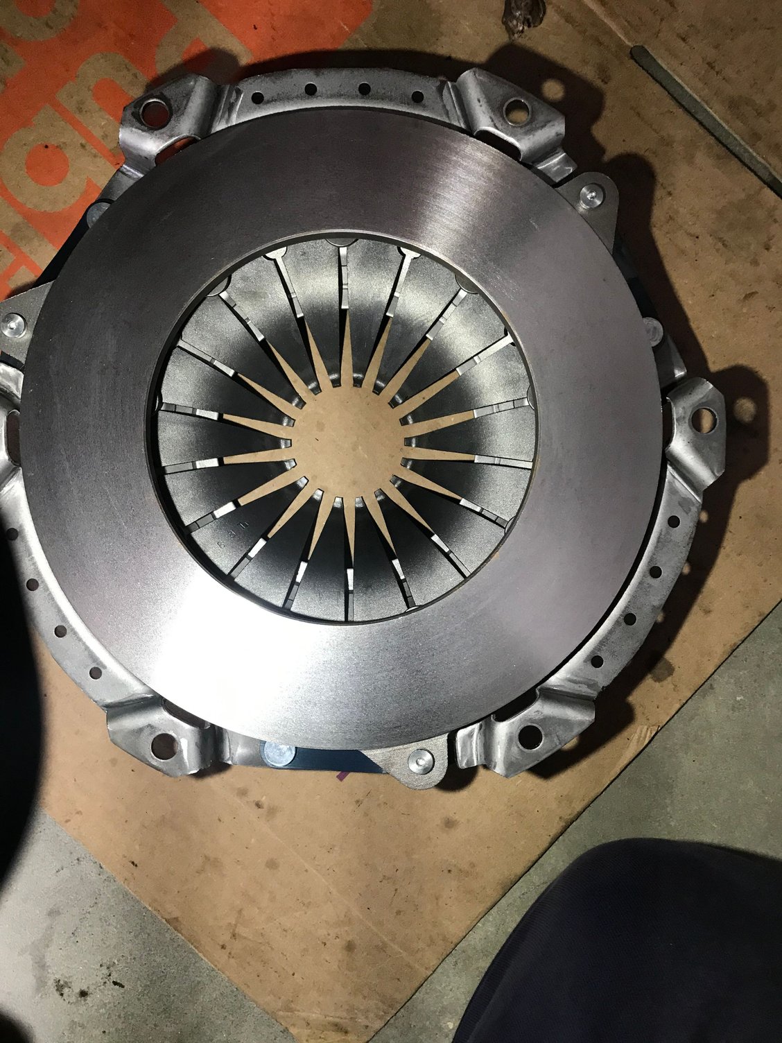

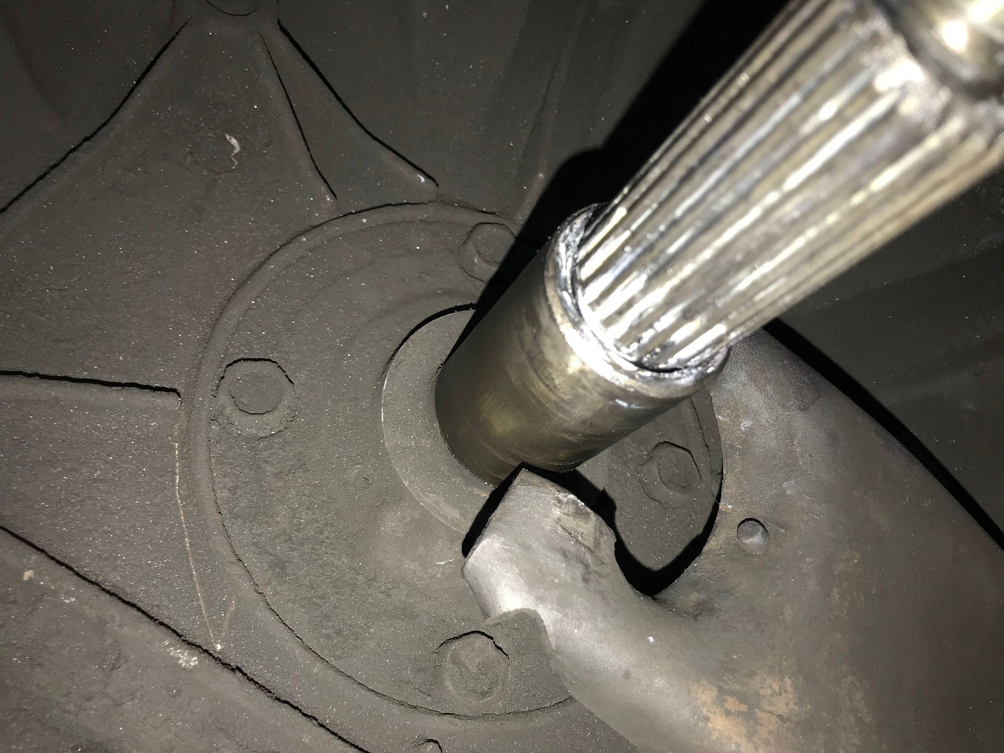

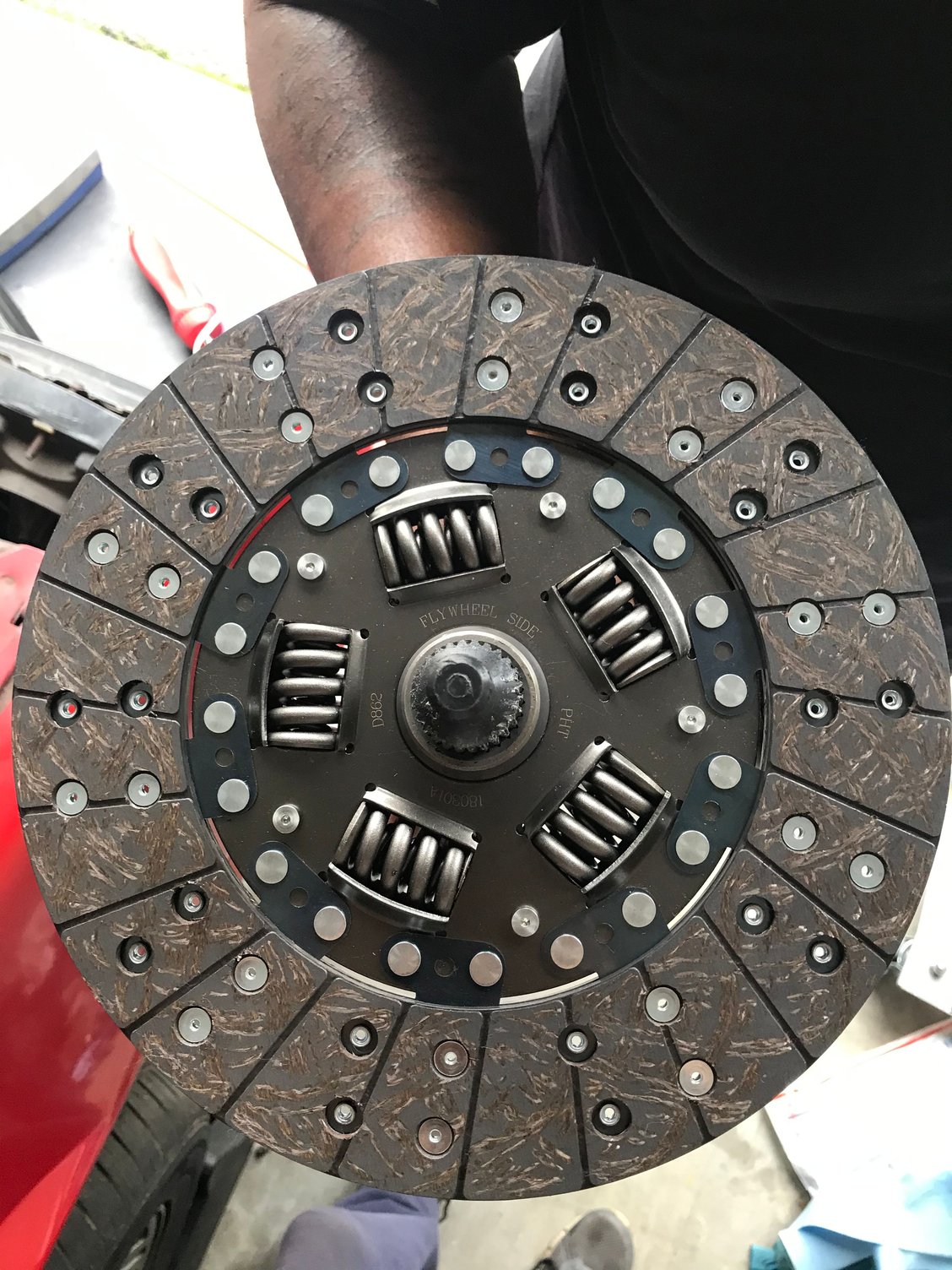

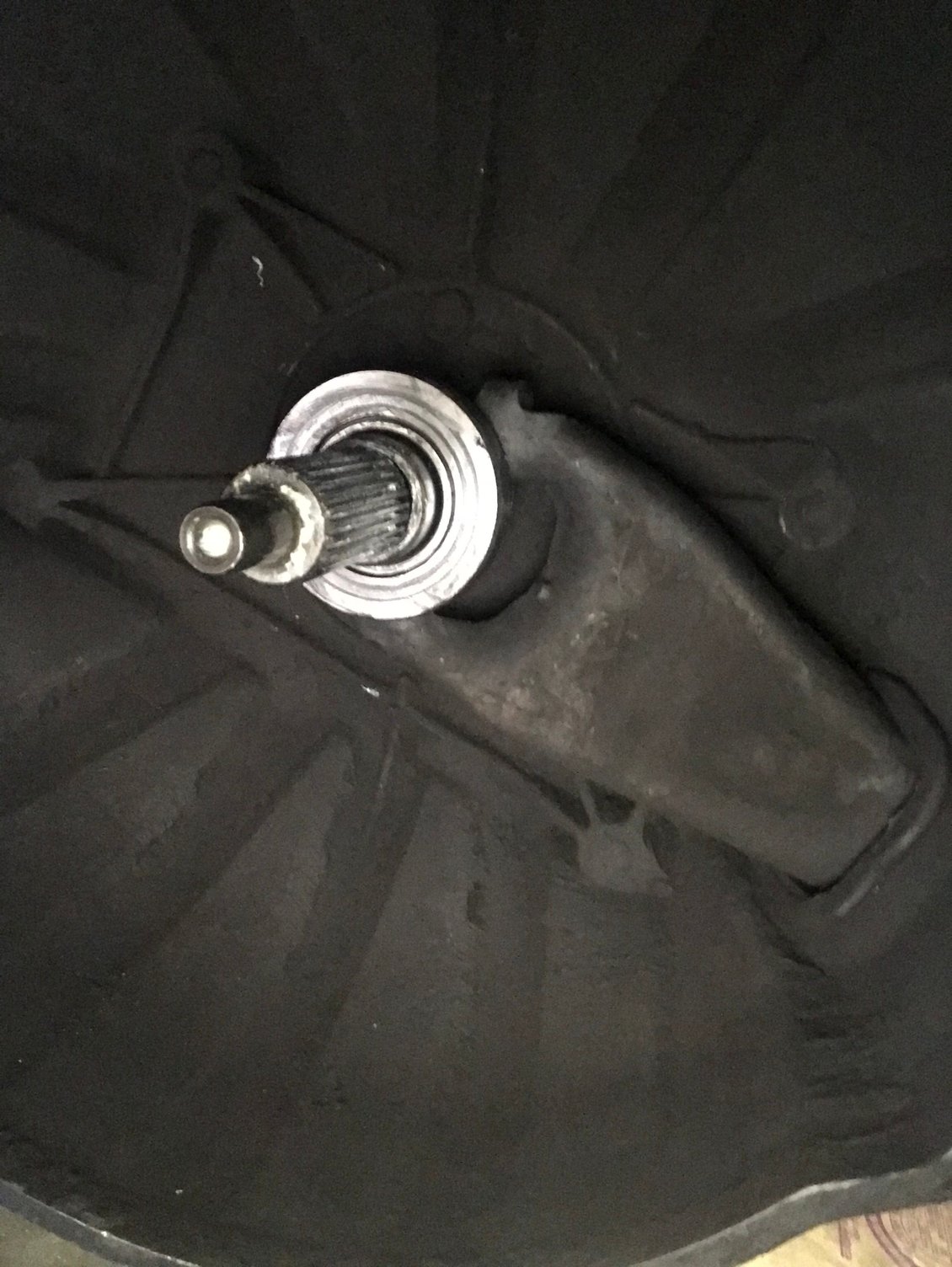

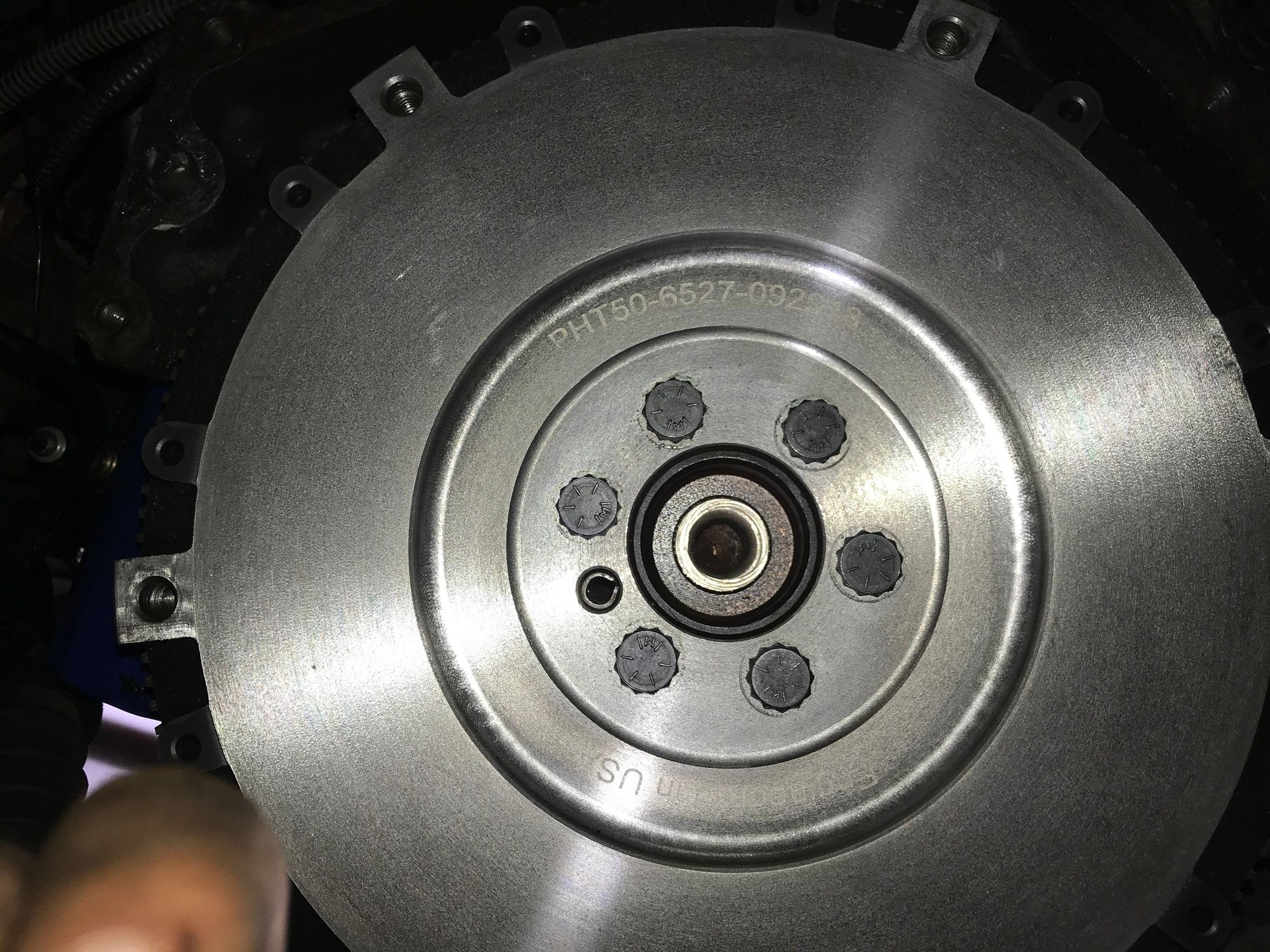

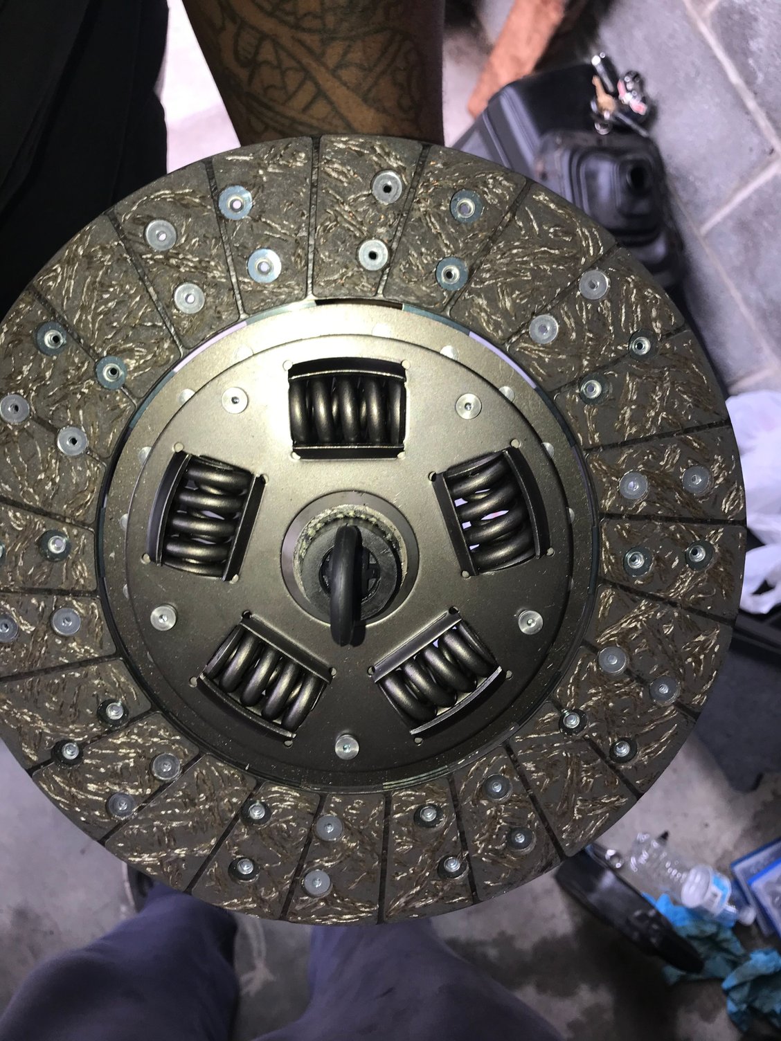

first of all let me Sincerely say thank you for helping me and giving me all this good advice. I unfortunately had taken the trans out by the time you posted your last response. I removed it to inspect all components and verify I didn?t install anything incorrectly. I have attached photos of all components. I noticed no issues except with the pilot bushing. I noted contact marks with the front of the bushing and the input shaft. this could be from when i installed it. or Is this what happened when a clutch is binding on the pilot bushing? Do I need to installed the bushing deeper or is this normal? The clutch and pressure plate both look good. Because I have it all apart again I?m going to install a new pivot ball and fork. After I install this all again I?ll bleed the cylinder one last time and do as sofa suggested if it won?t go into gear and start it in fifth and keep my foot on the clutch for a few minutes. If none of this works I think I?ll light the car on fire lol. Or I?ll replace the slave cylinder.

I have fixed the issue, clutch fork and pivot ball were worn, also the clutch fork was not positioned correctly on pivot ball, hence why the slave rod sat off to the side.
