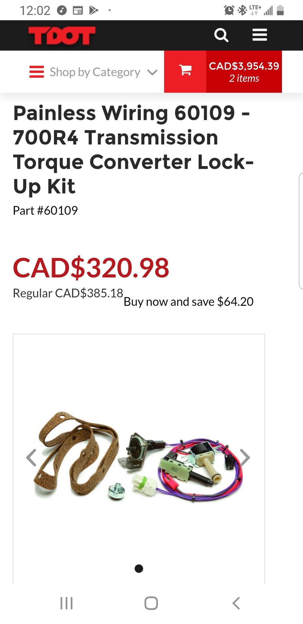

The car will be at first a mostly daily driver in summer and I'd like to take it on few road trips too.
So these kits are specific to the transmission right ?This would be what I'm looking for ? Regardless of the torque converter I get ?
https://www.tdotperformance.ca/painl...ck-up-kit.html

Yikes !!!! That's pricey , but yes indeed that would properly control your lockup converter as a stand alone function with no ECM control (cause it's missing it's VSS , for ex.) .
