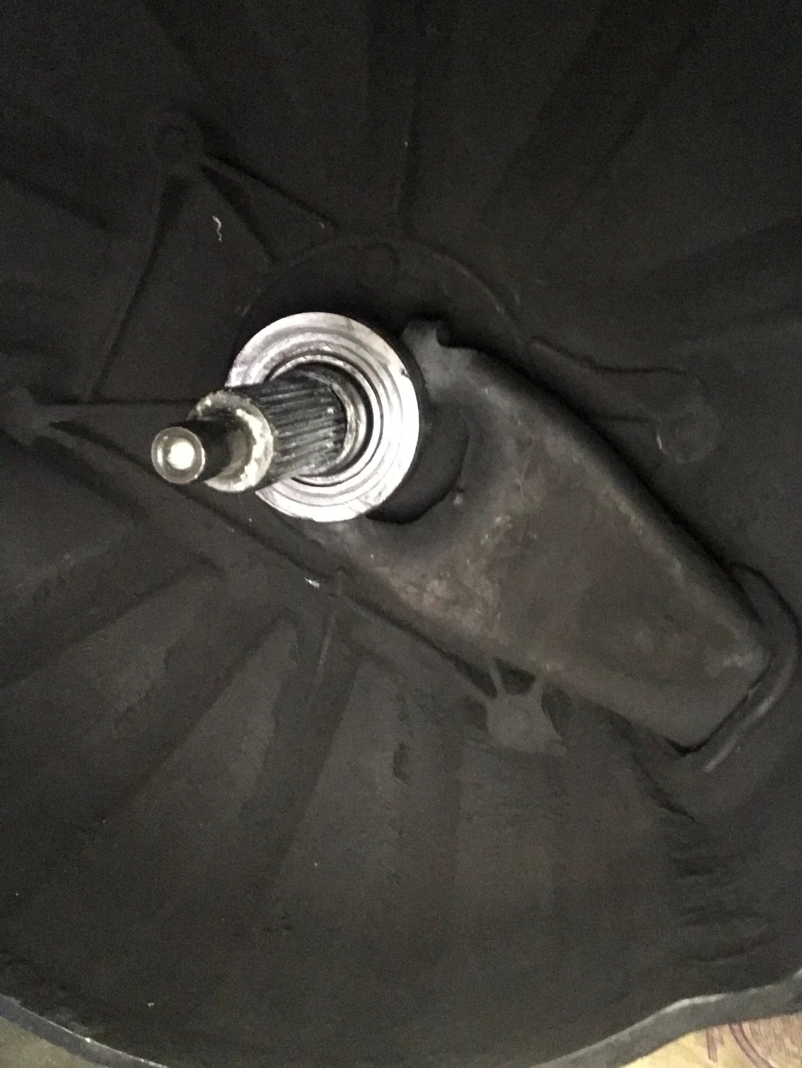

Originally Posted by xXasylumXx
I recently had the same issue and the problem was the clutch fork not sitting on the pivot ball correctly. Maybe your having a similar issue.
Also try bleeding the slave cylinder
if your clutch fork looked like this when you installed it it’s not on the pivot ball correctly

I’m going to check the fork today, if it does look like that will I need to push the fork onto the throw out bearing more then tighten the pivot bolt??
Yes, if you haven’t touched the pivot ball I doubt you’ll need to tighten it because it not adjustable, you just snug it up.
the pivot ball should sit in the dimple on the back of the fork, you might be able to see this without removing the trans if you remove the boot on the clutch fork. You might be able to push the fork into the T/O bearing and it’ll sit in the dimple.
