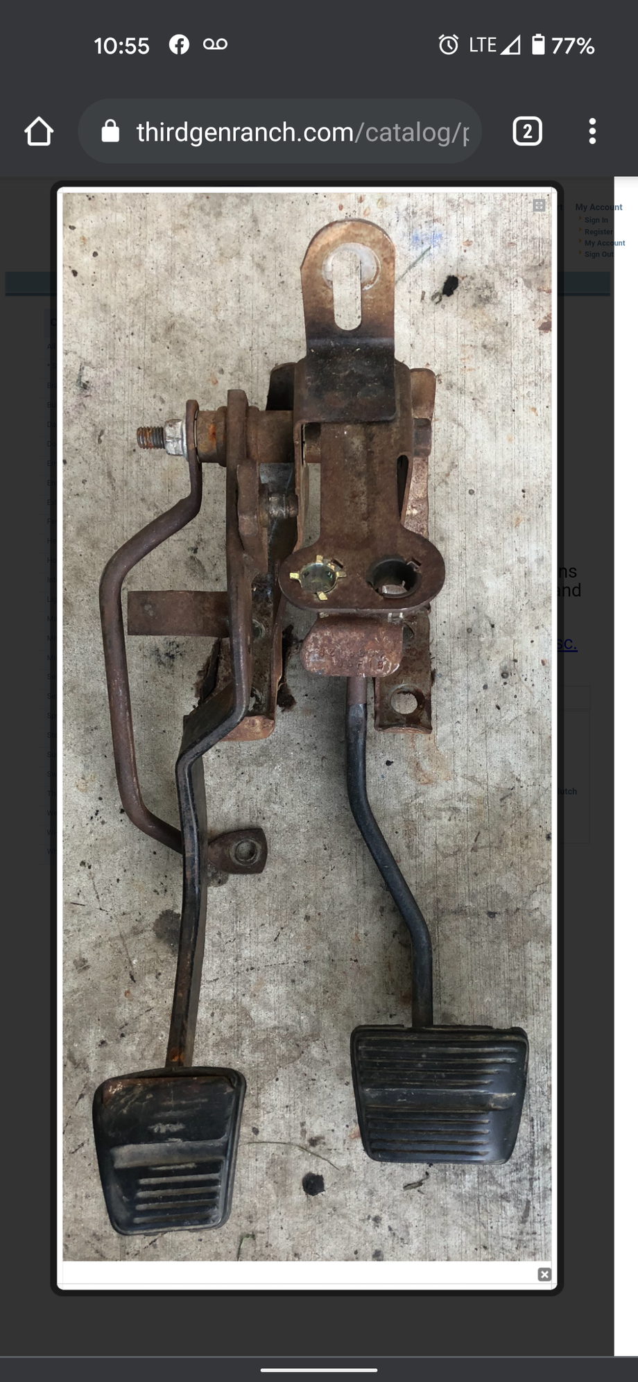

Be sure to inspect the T5 Bellhousing and pedals before purchasing them,.... there is a hydraulic version and a mechanical - "Z"-Bar - version. The hydraulic version of the pedals has a metal rod on each side that is required to mount the clutch hydraulics. You just want to be sure that you've got the right combination of parts at-the-ready before starting the conversion.
Picture of the hydraulic pedal rods...... BE SURE that these rods are placed as shown on the firewall when making your marks to drill the holes. It's VERY important that these holes are in the correct location !!! ( I always temp install the pedals,... mark the holes, remove the pedals, and then deal with drilling/cutting the firewall bolt & cylinder holes out, then re-mount the pedals when done. )

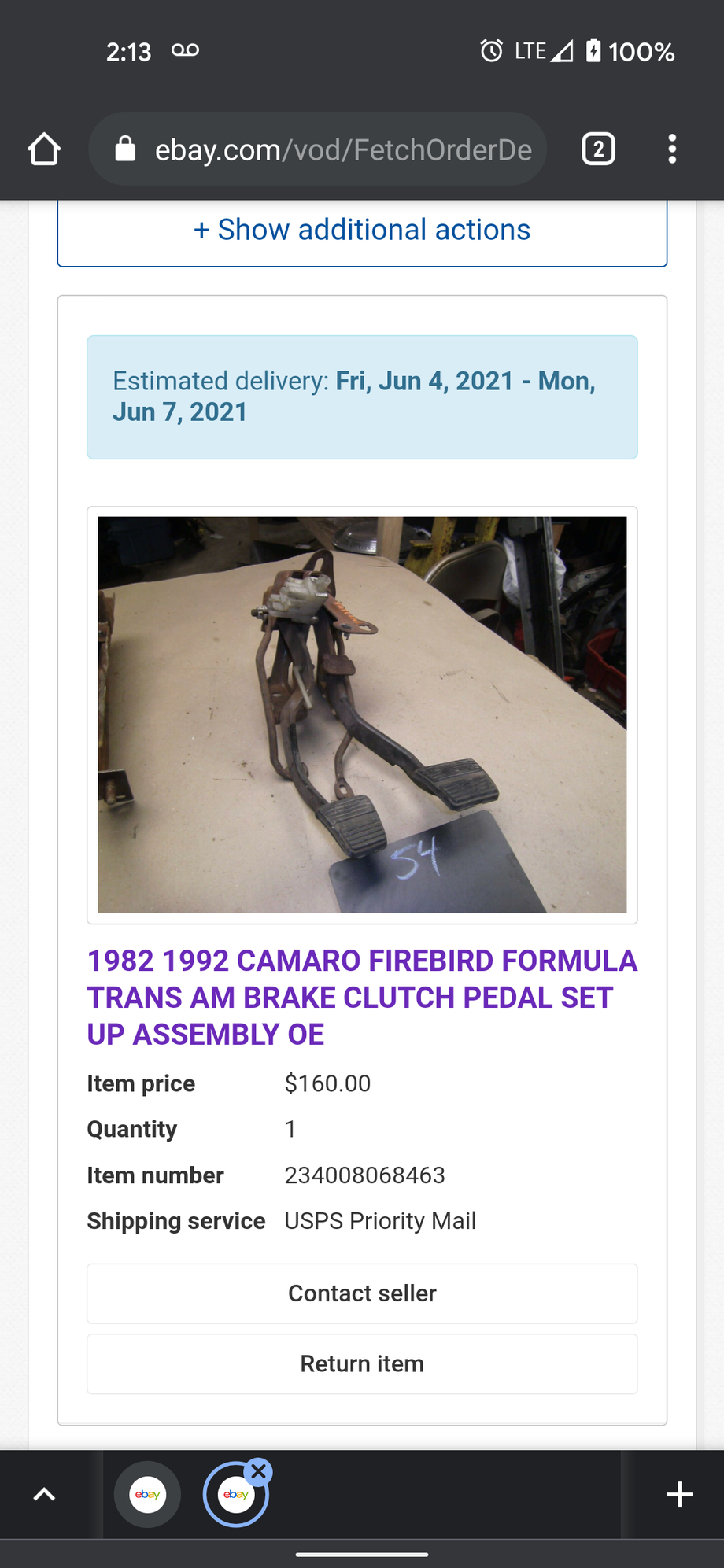

Re: t5 swap
i only see 1 rod on here and the one on hawks motorsports looks nothing like that. Yeah i dont want to buy a ton of parts that wont work. I got the driveshaft figured out, i need one from a 700r4 and i think im gonna go with a UMI crossmember. The stock t5 cross members look identical to the one i have 🤷. I read a thread somewhere that the starter is t5 specific as well?

Yeah you ABSOLUTELY POSTIVELY UNEQUIVOCALLY need that other rod thing as John's photo shows. The thing in your phone screen grab will NOT work right.

Re: t5 swap
found these, only ones i could find with the 2 rods. Thanks for the input on the torque arm, i never thought about it wearing on the mount but yeah that makes perfect sense. I wish i had a total donor car to get everything off of lol. I still have to get a flywheel and stuff as well. Its a 2 pc rms with staggered starter so i gotta pull motor to have the hole drilled for that. If i run a hydraulic tob, i shouldn't have clearance issues with headers should i? My dad has one on his mustang and its just a hose that comes out of bell housing, pretty damn slick i thought.
