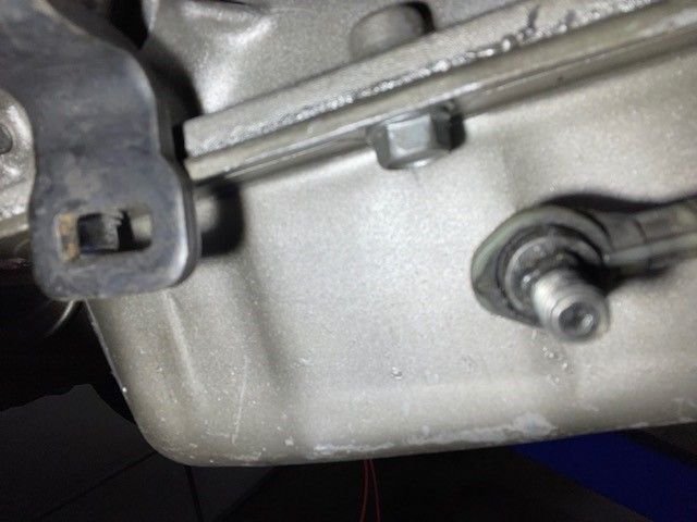

Looking for some insight here on the LS swap where I also swapped trans from 700R4 to 4L60E (which I thought were same housing). Note the gap in shifting linkage. Also bracket is right up against trans pan. One more thing, as for missing neutral safety switch (NSS), my (sorta) Painless wiring harness does not come with the wiring for the NSS, but was told this (https://www.painlessperformance.com/wc/60122) can work in lieu of that, so I have that as well. Anyone have success with that alternative?

Thank you...I look forward to seeing your pictures...as you can see from mine above, there is a good 3" gap I need to close. the linkage bracket is mounted directly to the trans (shifting linkage) shaft and there is only one option there...

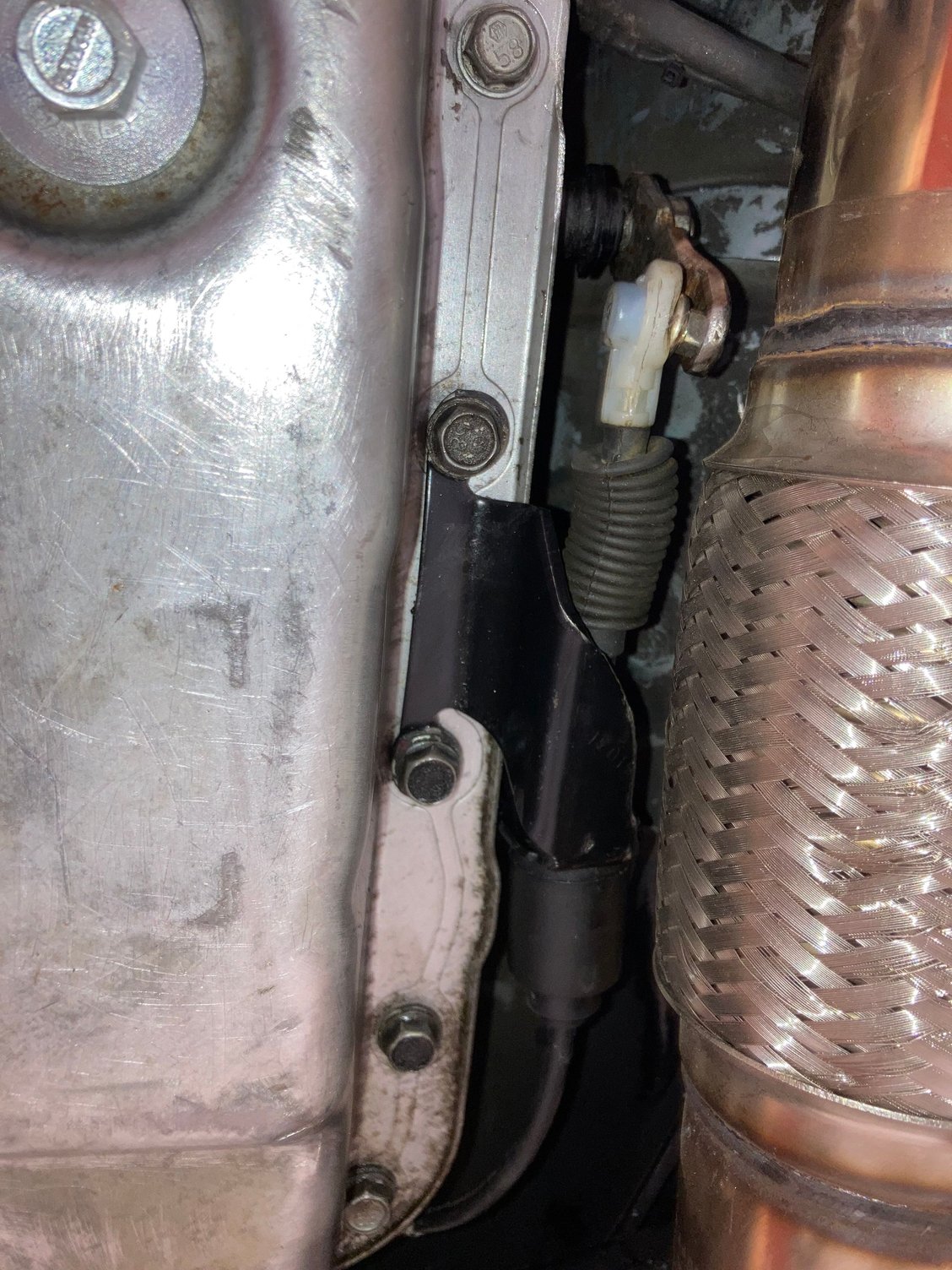

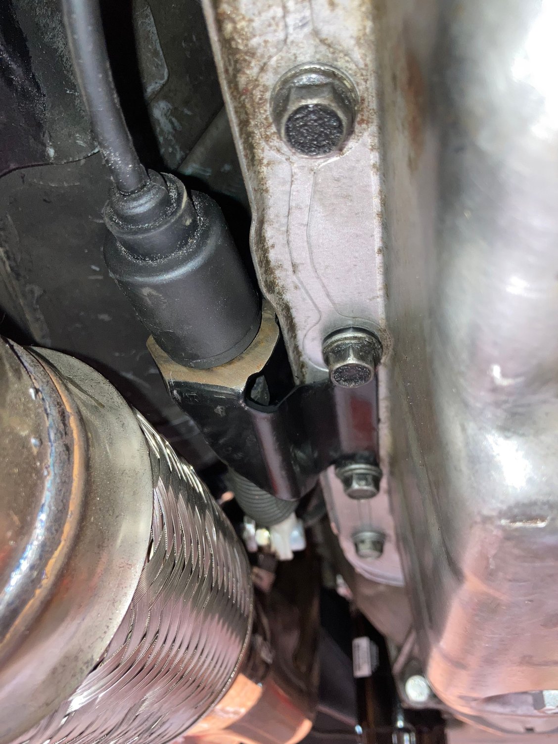

Here you go! If i remember correctly, this is my original shift cable holder.

Thank you. I have that shift cable holder too. They are about the same size, but still doesn't explain the 3" gap. See here:

Very weird, are you sure you have the correct shift cable? FWIW, that cable should be adjustable, but I don think you'll get three inches!

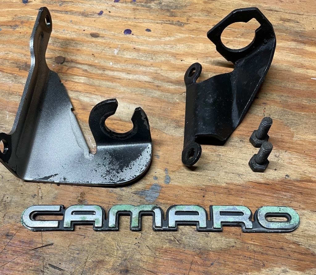

Thought I'd give you all an update...problems solved! Two issues:
(1) The shift linkage trans. shaft bracket...there are a few types offered on the 4L60E/700R4 transmissions. Many factors including (a) column shifter vs. center console shifter, (b) cable type (i.e.: bolt vs. ball/socket), and (c) header locations to name a few will determine which one you need to go with. In my case, I needed to mod it thanks to "wlink14"'s recommendation above.
(2) The shift cable mounting bracket...once again, there are a few types offered on the 4L60E/700R4 transmissions which are determined by many factors. Some are also mounted above the pan and some below...some in the middle of the pan, some at the rear of the pan. In my case, I needed to use the bracket on the right which I picked up at a junkyard for $1.33! Haha! The one on the left, which came with my 4L60E, mounts above the pan and to the rear thus causing my 3" gap issues. The one on the right mounts below and in the middle of the pan.
