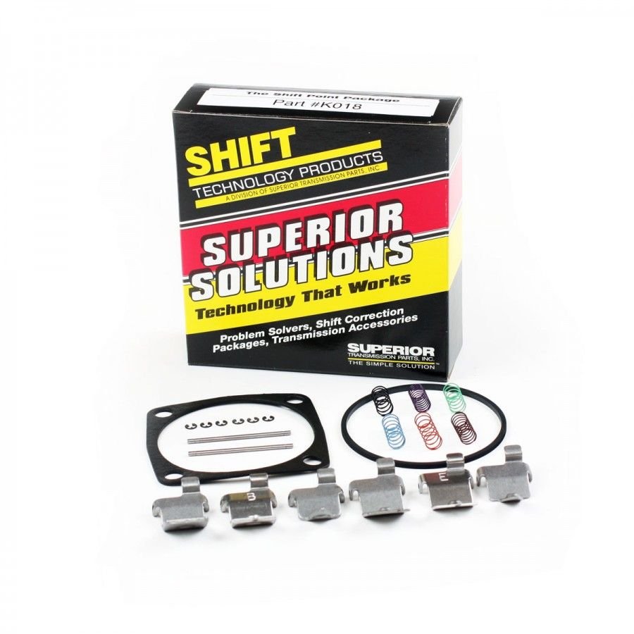

Purchase one of these: Superior Transmission Parts #K018.
