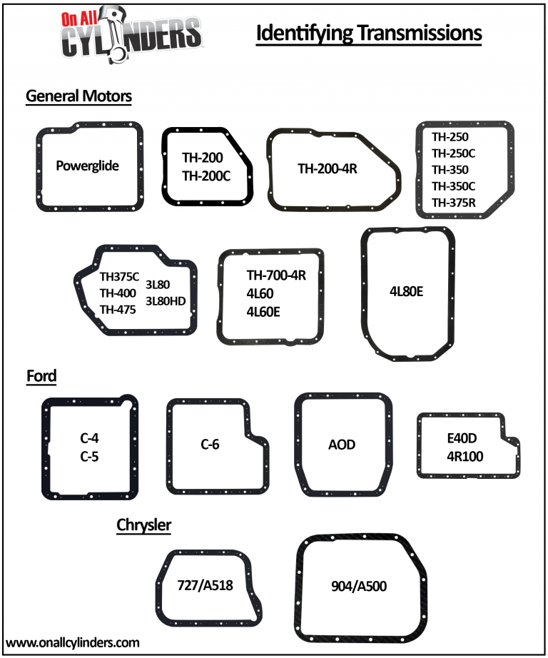

If this is a 82, it's most likely NOT a 200-4R. (which is NOT -R4, like the 700 is) More likely it's a 200C. 2 totally different transmissions.
If it's the 200C as is most likely, it's a complete steaming bucket of monkey plop. Catch me on a bad day and I'll tell you what I and most everybody else think of it. It's weeeeeeek in its design, not adequate for a V8 to begin with. Butt that's a whole other matter.
First order of business is, find out what you've got. Which is extremely eeeeeezy: all ya gotta do is look at the pan and compare to this convenient chart I ganked off the interwebz.
I would note also, that the 200C pan is small, flat, and featureless, whereas the 200-4R pan is quite large, and has 2 "sections" with a sort of pinched-off place between them. Very unusual looking.
