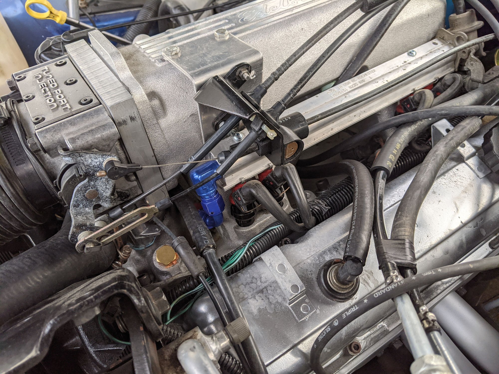

2. TV cable adjustment. I know how to adjust the cable, (push the indent in and pull the cable all the way back, then press gas pedal to the floor and it ratchets itself into place). I have a TPI throttle bracket bolted to a Edelbrock Pro Flo XT intake.
Does the cable need to be adjusted so it goes from fully closed to fully open when the throttle is Closed/WOT, or is it's movement relative to the movement of the throttle?
If that doesn't make sense, I am trying to say that right now with the TV cable adjusted, and the throttle in WOT (engine off), if pull the TV cable it still has some movement.

TV cable is a super important aspect, there is a specific geometry to consider, Its not as simple as pull all the way at WOT
https://www.thirdgen.org/forums/tran...djustment.html

As far as the TV cable. Currently my stock 700r4 is working correctly. I have the TPI throttle body and bracket bolted to the Edelbrock Pro Flo XT intake. I'm sure it is correct but just wanted to double check.
The throttle bracket is the same distance from the throttle body as it would be on the stock TPI intake.

Its probably fine but I don't like to assume anything. There is some issue with geometry on some setups causing issues at part throttle.
If you want to be 100% sure it requires a pressure gauge. There is no way to really tell from just looking afaik.
Im surprised Dana didn't recommend a pressure gauge. Did you at least show him the picture from above? I would make sure he confirms anything/everything
