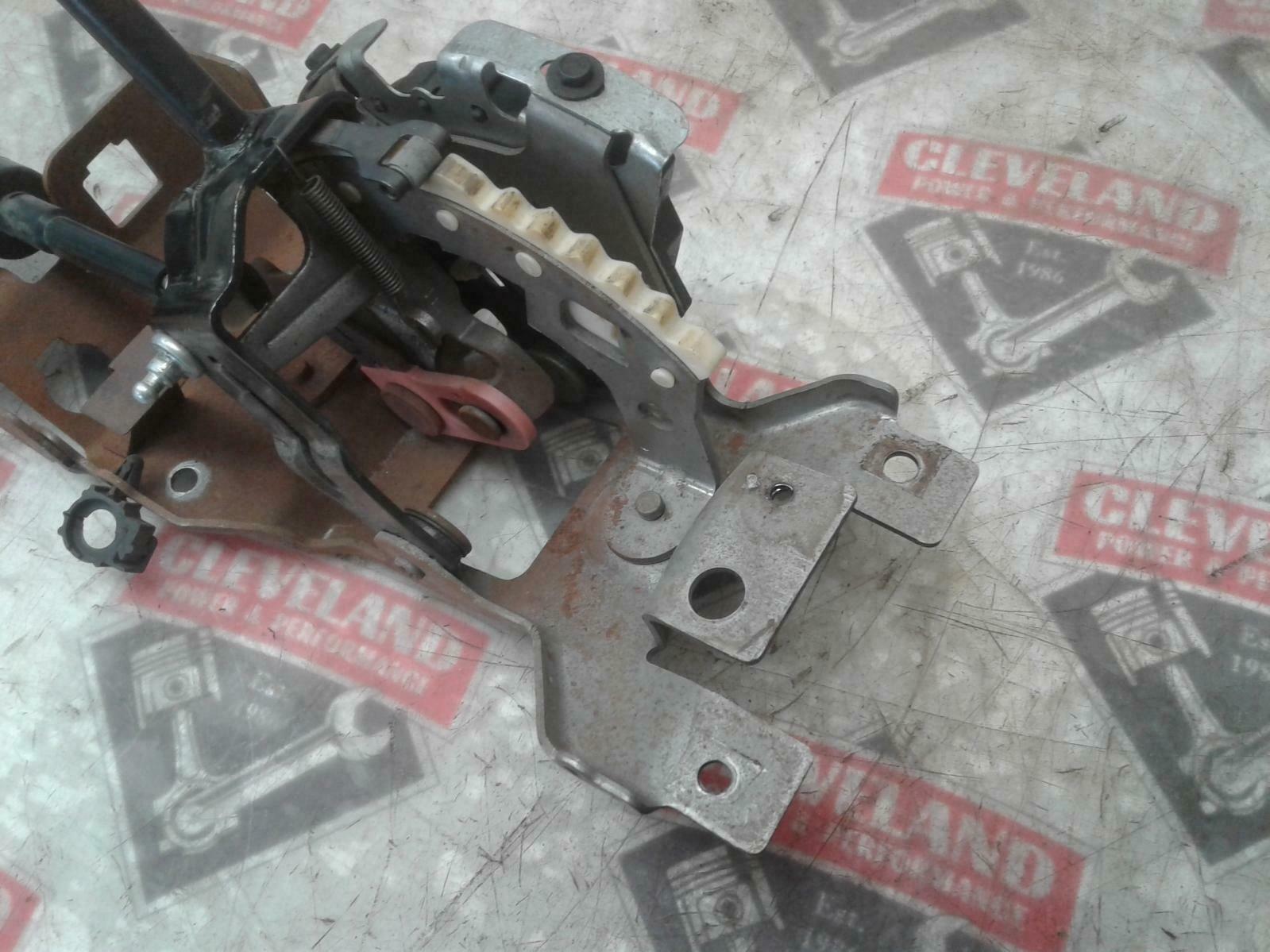

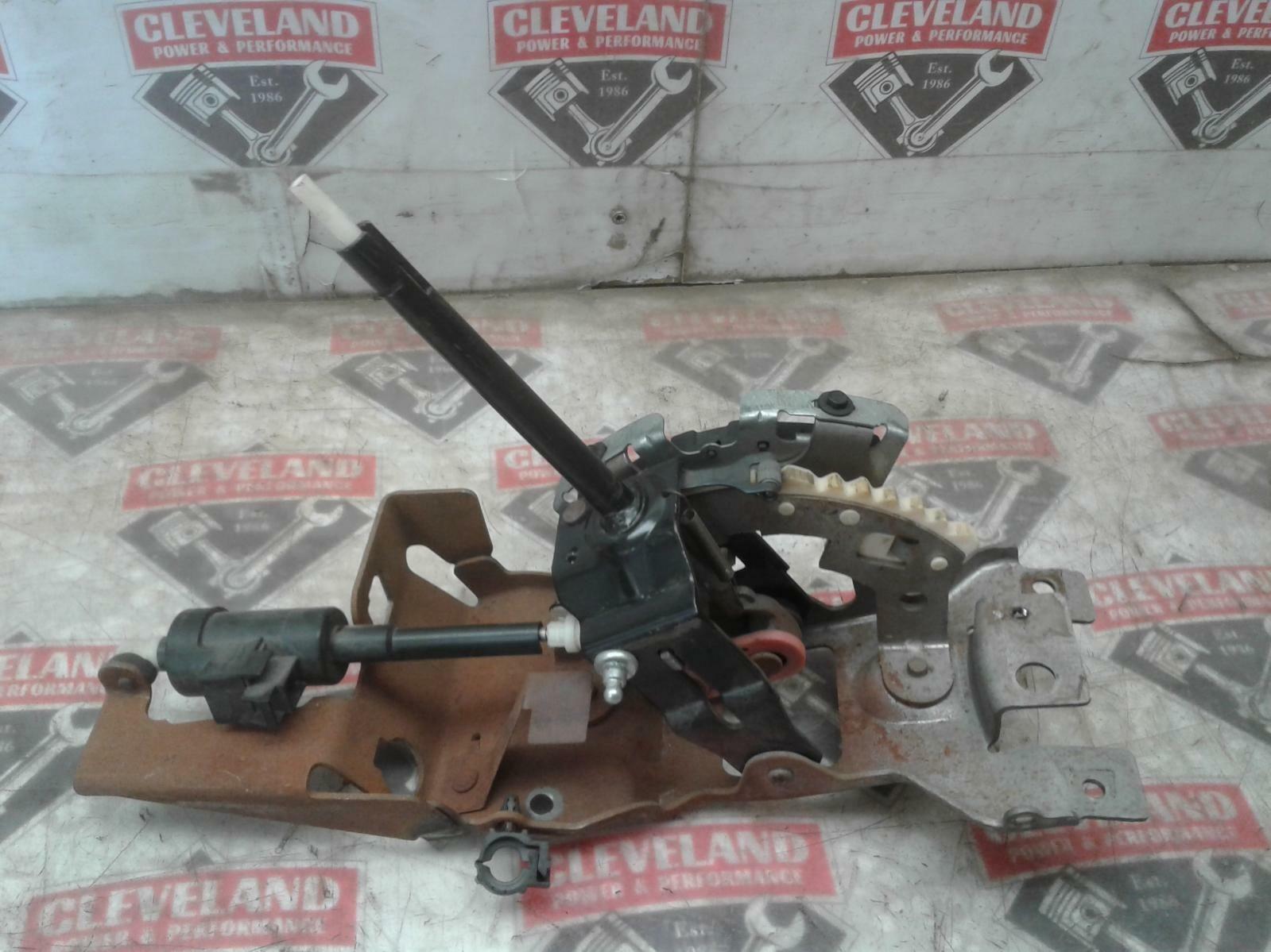

I have no idea if I correctly understood the description of the issue.
If you can put the Gear-Selector into the "Park Position"...
And will not LOCK into place...
That is an issue.
The Detent/ Spring (Button on the Gear-Selector Handle) and/ or the Gate of the Gear-Selector Assembly may be worn-out/ damaged.
For simplicity, I am showing you a 4th-Gen Part (the Components I want you to see are more visible compared to the 3rd-Gen Part).
Gear-Selector Assembly below:
In the Image below:
Look at what almost looks like White-Teeth...
And a Roller that would inter-lock in the spaces between the Teeth.
The White-Teeth are essentially the Gate.
The Spring Detent has the Roller on it.
