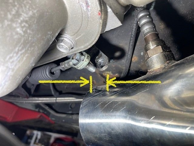

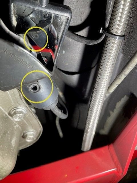

Looking to see if anyone is familiar with this particular gear selector cable design. I need to adjust it as it is off by "1 detent." I have seen this: http://shbox.com/trans/A4_trans_linkage.html (4th gen), but my deisgn (3rd gen) is different in that there is no tab to lift. This is off of a 1991 Camaro RS with 700R4. I have since moved to a 4L60E. Please see images below where one shows the offset and the other shows the gear selector cable at the "adjustment area" where there is a small (approx 1/8"D) circular opening at the bottom and top (as seen in the mirror). I certainly do not want to force or break anything (since it is a plastic housing), so would appreciate any instruction. Thank you!

The gear selector cable is the original (700R4). The 4L60E trans did not come with a bracket or linkage arm, so I had to get creative sifting thru a junkyard. Anyhow, any idea how to adjust this stock 700R4 cable? The plastic housing (in the "adjustment area") just seems slightly different than the "norm!" Thx!

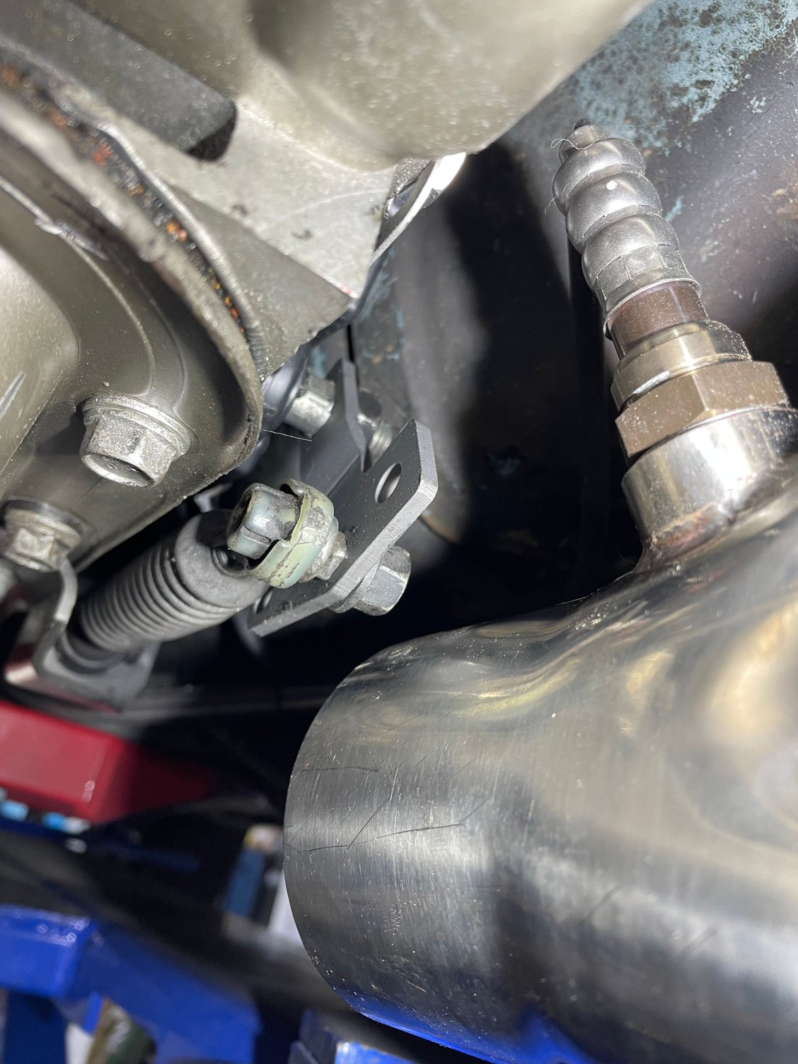

IIRC the linkage arm on the transmission should be slotted to allow for adjustment where the cable installs to it. the pic above shows no slot.
at least for the handful that I've taken apart and put back together.

unfortunately, my 4L60E did not come with that linkage, so I had to grab one from a junkyard. The B&M one pictured above should arrive today, and hopefully those slots will accommodate. Thank you.

Re: Gear Selector Cable Adjustment
Thx all!
@battmann used your recommendation
