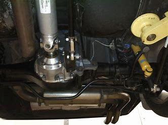

Almost 30yr old moser housing and axles. Moser thru bolt aluminum case, lightened gears etc.
when i 1st got it together, i used a regular 9" pig from a truck with 370 gear or something. I had upgraded the guts to a Detroit locker. After a few hits with the M&H tires, i had cracked the factory pig. Started talking with the ford guys and they said the N pig was strongest factory part.
I spent a few bucks on one and it held up to a lot of abuse. Now they are big bux for resto guys, and i wanted to lighten things up, so i went aluminum.

That's the same setup I have, I got it in 2000 (ish). It was a pain in the *** getting it dialed in but once it was I've been super happy w it since. It's really taken quite a beating also!

I do have a very, very pretty moser. I'll look for some pics of it to post up.
