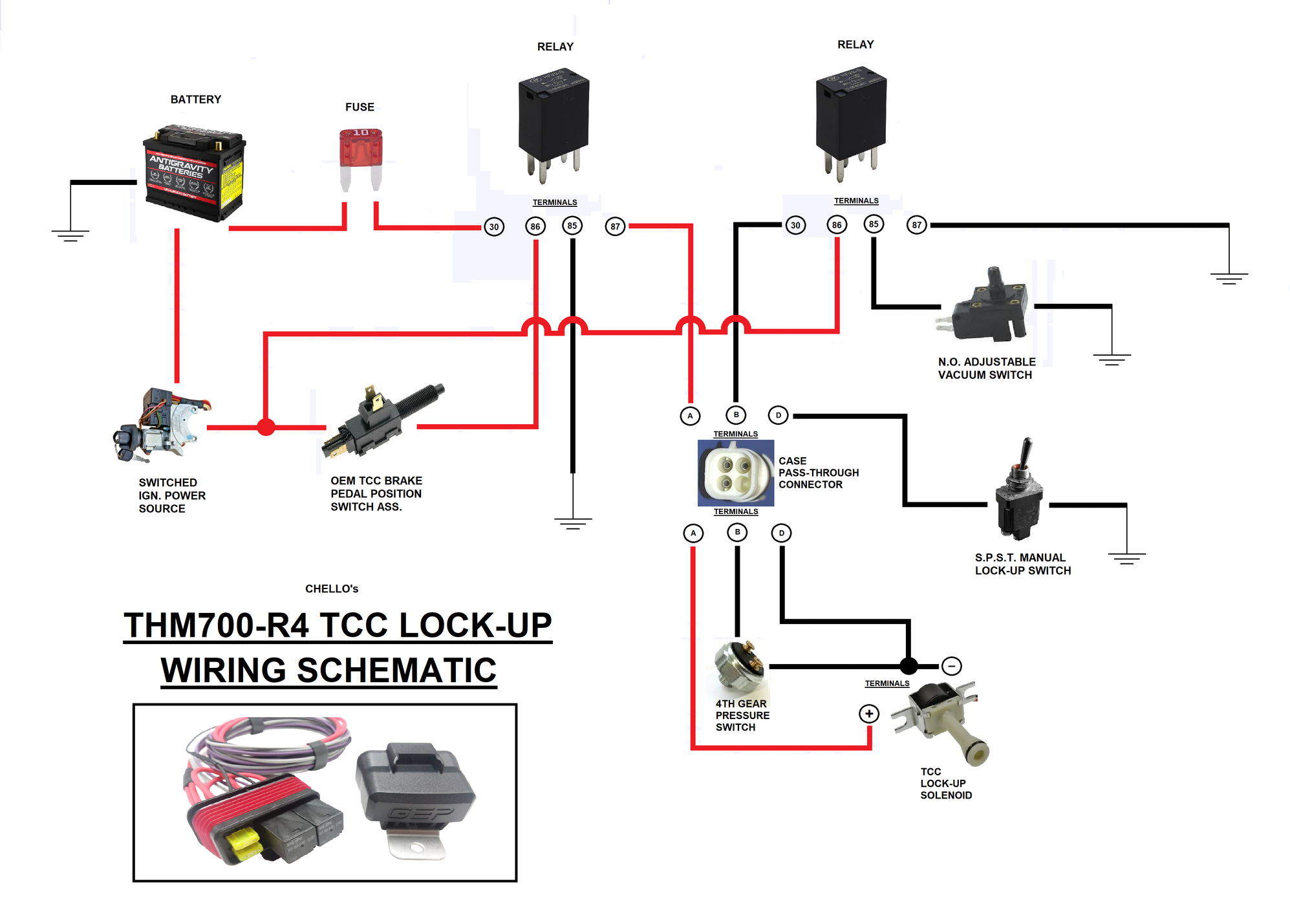

Fortunately with a few basic switches and/ or relays, it is very simple to wire the TCC Solenoid to lock-up at any time desired.
The TCC Solenoid used with the THM700-R4 is a very simple 12v, non-pwm, electrically activated (non-electronic) device.
Using a "normally open" pressure switch on the 4th-gear pressure port of the valve-body, the existing brake pedal switch, and a vacuum switch...
You would be able to make things work as desired.

Below is a diagram of the way we would wire the Torque Converter Lock-up Circuit with modern wiring practices for Non-Electronic (No PCM) Fourth Gear Automatic-Lock-up with the ability to manually activate Lock-up in Second, Third, or Fourth Gear.
This Circuit will un-lock the Torque Converter if the Brake Pedal is engaged, if accelerating/ placing a load on the Engine, or down shifting out of Fourth Gear.
Otherwise while cruising in Fourth Gear, the Torque Converter will Lock-up:

Vorteciroc Is that setup available in a kit form shown here?

We used to produce a complete Wiring Harness with all components...
As well as a DIY kit.
Unfortunately at this time I do not have anything to offer (I was still producing these after my Father passed, but I am also severely ill now, just the same as he was).
