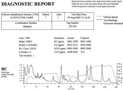

DOH!!! she failed... and by .1 on the HC's
ill go get some new plug wires and higher octane, and then ill go again... 2nd test is free
Old Aug 7, 2002 | 03:47 PM
RPS's Avatar
RPS
Joined: Feb 2002
Posts: 167
From: Sykesville Maryland
this was with quarter tank of 87 octane fuel, the HC's are high due to unburnt fuel.
i have a small exhaust leak before the cc, got to get it welded eventualy,
i have new plugs, new sistributor, new cc, new o2 sensor
i dont even think he checked to see if i had a cc...
Get that leak fixed ... exhaust leaks raise the HC count
