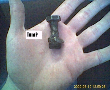

On that plug,
suggestion?
remove it NOW while it's way easy.
You can WAY EASIER
reinsert a NEW plug any time later on!
Welding on larger extension piece to grab, twist works great!
Or get special tool from Snap-on, Mac tools.
Reason it's difficult to remove?
It's cast metal plug, "rusted" into head, by now, by water passage in head it closes off.
Count on friends stopping by & betting who can remove it!
PS Grinding down "something" to fit, is wasted effort.
I gave ya biggest tip & my two times, oh boy.....
Latest one took me about one hour to remove with proper helper!

I remember that damned plug... tried grinding down a bolt to fit into it, might've worked if the bolt was ground down perfectly square and not at an angle. So the plug's square hole got trashed. I had to run home and get my MIG:
