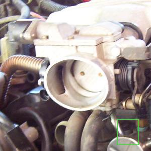

ok, my car's bein stupid. i posted this in the gen. tech engine board but need a second opinion. ok today after i came back from driving for 20 minutes, i turned off my car and steam started pourin outta the top of the hood on the passenger side. it just turned 120,000 miles on wednesday, so i guess it felt the need to celebrate a little by giving me my first problem with it ever. it smelled strong of antifreeze and soon it had drained the water tank dry. i found what was releasing the steam though. in the bottom right corner of the picture is a black cap kinda thing. when i'd push it, the steam would stop, and when i let off the steam would start back up, so i guess there's a crack in there somewhere. also, it didnt start until tonight but my car's overheating BAD. i didnt want to drive my car anymore till i fixed it, but i was at a friends house and needed to come home so i drove it home. i watched the temp needle go steadily up, and after 2 minutes, the temerature had gone from very cool (it was off for 4 hours) to WAY past the 260* mark. i had to stop halfway home so i wouldn't melt my engine into a solid piece. in the gen. tech engine board, one guy said he thought it was my heater valve. is that what yall think too? is that black cap in the bottom right of the pic the heater valve? if not, where is it? i've never messed with any of this before so i'm in the dark completely about this whole issue. any help would be appreciated. i just dont wanna have to resort to takin the car into the shop, but i gotta get it fixed by sunday at the latest or it's goin to the shop. thanks yall

the pic:

damnit...sorry i messed up and hit submit but it wouldnt let me go back and add the pic. so here it is, for real this time: (the bigger box was from before, when i only knew the general area of the leak, but the smaller box shows the exact place)

Unless I'm mistaken...I think that black sucker is some sort of vacuum solenoid or device... Is 260 degrees the red line? If you went past that.....well.....wow. Good luck....I'd expect the motor to be toast..

Heater diverter valve, that's failed on my car too. Pick it up at any auto parts store. Costs like $15 max. Replace, refill, you should be good to go.

ok i just found out some new info..wanna run it by yall and see what you think...
somebody told me:
it could be my thermostat, cause they sometimes get stuck closed. they said the thermostat is what allows coolant to pass through, so if it's closed, the coolant will find another way to move through the pipes (i.e. the steam). also, since the coolant isn't getting through, the engine isn't getting cooled so it heats up quick as hell.
does this sound right to you guys? tommorow i'm goin out to check the thermo. and the water pump
89V6FBIRD - where exactly is the heater diverter valve at? and what does it look like?

That's what you circled in the pic. Or rectangled...

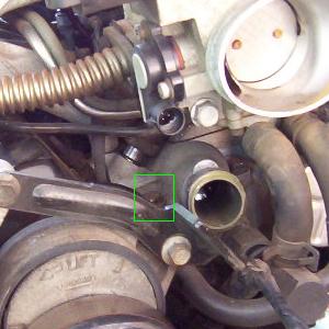

how the HELL do you get the spout that attatches from the radiotor hose to the engine off?i've unplugged wires, taken off the main belt, taken off the induction tubing, and for the life of me, i still can't get any leverage at all on either of the two bolts. anybody got any suggestions, it's been 2 hours of going nowhere and i'm startin to get pissed off

here's some pics of where the bolts are, just for reference:

well guys, the car's goin to the shop. it only took about 20 minutes to take everything off the engine i needed to get to the bolts that hold on the housing for the thermostat, but after 2 hours i had gotten nowhere. i couldn't get the bolts to budge. there wasn't enough room for leverage w/o taking the whole throttle body off. plus a few metal hoses for which i'd have to buy new seals for. and even taking it all off, i'm not sure i could get the leverage to get 'em off. luckily i know a guy that's gonna fix it for free, i'm just pissed i spent so much time and got so close, and then had to resort to a mechanic. oh well, i learned some new stuff. well thanks for the help yall, but with a 45 hr/week job, i dont have any more time so it's gettin turned over to more experienced hands. (sigh)

You could've used a universal (swivel) socket on the housing bolts. You could also use an open ended wrench, but that's a pain in the butt.

i tried the swivel socket and an open ended wrench on the bolts, but no luck. for the one on the left side (pass. side), one of the belt driven accessories was is in the way. i was just gonna take it off so i could get to that left bolt, but the right bolt area was so tight that the swivel socket wouldn't move more than 1/2 inch at the handle, which wasn't enough to start turning the bolt. so if i couldn't get the right bolt off, there was no point in taking off that part on the left side to get to that bolt.
so the frustration of all this, plus the fact that the thermostat may not even have anything to do with my overheating, plus the fact that i need the car running tuesday, means it's unfortunately going to the shop first thing tommorow morning.
