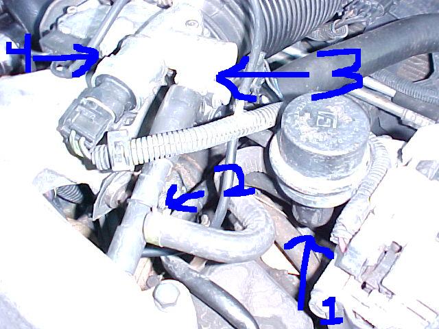

Ok, we're talking about this, right?

#1) PCV Actuation Valve (Don't know the exact name )
#2) T Fitting for vacuum source
#3) IAC connection
#4) IAC
In a nutshell - you do know the pcv system, right?
Positive Crankcase Ventilation. if your engine were totally sealed, it would actually pop due to built up pressure from various things - air heating up inside the engine, oil vapors from heat, all sorts of things. Basically, prevents your engine from getting bloated
Ever seen a PCV valve? It's a one way check-ball valve. When pressure builds up enough, the ball comes up, and the pressure is released.
The vacuum valve helps that, since the RPMs stay up in a stick shift when you shift (air pressure in the plenum has to be pulled through still) and pressure spikes up. The vacuum valve senses the vacuum pull, and helps pull the crankcase vapors out.
It has nothing to do with the AIR system. the AIR system's ONLY purpose is to inject extra oxygen after the exhaust comes out of the head, to help light the cat quicker for emissions. That's why I removed my AIR system after I removed the cat.

Doward circled it in the first picture he attached. That's the deceleration valve. And as I said before, it's on the 5 speed, because when you downshift the throttle valve is closed and the vacuum in the intake is too high, so the deceleration valve allows air to bypass the throttle valve to decrease the vacuum.
But whatever the function, the fact remains that it can cause backfire if it's not operating properly. My question was, what is a definitive test to see if it's operating properly? I'm going to replace the valve anyways, I can get it for $13CAD. I just want to know out of curiosity. BTW, for anyone looking for this valve, no one makes them anymore, but there is a warehouse in the US that has stock, so you can get it through Chev.

I just want to know how to check to see if it's operating properly
Could you use a vacuum pump to actuate the diaphragm/valve and another air supply to see if the valve itself flows air when it's supposed to?

I don't follow...

Suck on the actuator port , and see if air is allowed to flow through the valve passage.

Originally posted by camaro_junkie
BackInBlackGP: I just meant that we're not talking about the smog pump check valve at all.
I know. I was simply clairifying the location of the smog pump check valve...

That test will determine if it is working at all, but not if it is working properly, for instance if the spring/diaphragm is weakened.
