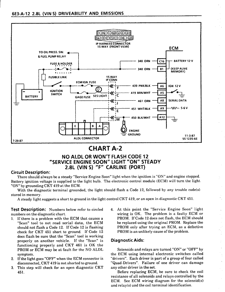

changed the ecm and prom. i checked the codes and only got 12 which is beginning of sequence.also before i put the ecm in the check engine light would flash fast with the key on. after i changed it it was on
steady

Okay,
check this trouble shooting chart out and see if it helps any.
