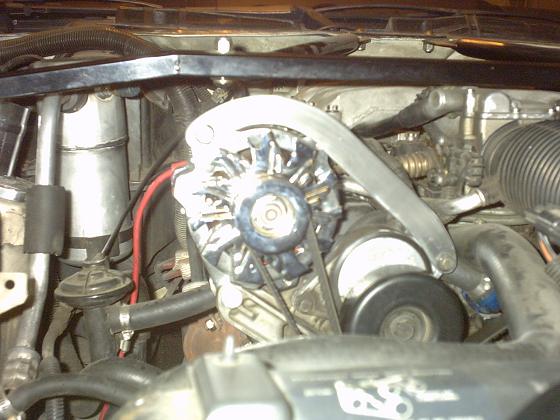

After lots of testing, The best combo I came up with is using the ASP crank pulley only with a 140amp alt with idle at 850 range. I can run the headlights and radio at night sitting at a trafficlight without any drain at all or dimming. 800 rpms still had just a slight progressive dimming.
This is a Powermaster TPI 140amp alt with a homemade aluminum bracket.

I have no clue, but it doesn't work as ASP claims. I even tried the ASP alt underdrive pulley with a 200amp alt. It was still discharging at idle and the amount of force the magnictic field generated by the 200amp alt to turn it robbed what HP I was trying to gain from underdriving it with the smaller pulley.
The thing that robs the most power is the waterpump. Hence whay I am going to an electric remote unit.
