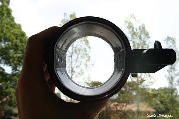

Thanks to Naft, I got a maf I can gut out. It arrived today, so I got it apart. Will start assy tommorow of a gutted maf.
Anyone care to see pictures of what one looks like all taken apart before I start assy?

Why Gut it? Because I'm MAP, and dont need the maf except for the clean connections on my intake, and its plastic so it wont get as hot as metal.

Why gut it, sorry... LOL, I see what you're doing now - although, you'll find that it WILL be a restriction still - it's a venturi style setup.
Might I suggest some thin-walled PVC pipe? Just scuff it with some 180 grit sandpaper, and paint as desired

I dont see how it will be a restriction? In fact, performance has improved since I got rid of the pipe.
I also didnt like how the pipe, or way a 3" pvc would fit into the snorkle.

Please explain how the maf being gutted, is any different then a tube of pvc?

You'll see... while it is 3" OD, the ID is like 2.5"!

didnt look that thick of material to me??
TB is only 52mm? which is like 2.04
I'll measure tonight.

Yes, that's very true - but do you want another restriction, upstream, even if it is less of a restriction?

Dale, is that a Delco, or Bosch unit?
Mine is a Delco, and you are right - 3" ID. The odd thing is, is that the unit I looked at at work, was a Bosch unit, and looked like it had a tube run down it, to make it 2 5/8" -
Now the weird part - it didn't have that central tube - just the flat board, with the fq film.
Also, I see you have the straight MAF connector - Alan, do you still have that one you had, with the 90º angled connector? I'd swear that that is the Bosch unit!
Naft, owned? Hardly... if anything, I think we're about to find out there are 2 different style MAFs floating around. That, or that reman'd unit was boxed wrong at work

I dont know the difference between the two. Its to dark now, but tommorow I will take some pics of my finished project. Will also compare to the unit I take out.
Their are a couple "lips" for like the screen, and connections on the back, but they were like 1/16 of inch tall, and I knocked them down very fast with a bit in the air drill.

Dale, yours looks like a Delco unit.. if I get a chance while running around in the turbo tomorrow, I'll grab a pic of the Bosch unit

i saw a tomco unit on ebay i think it was, the outer shell was tapered toward the middle and then it expanded to the other side. if the bosch unit is like that inside, it would make sense that the shaping is to direct the airflow . . . the circular piece inside would create a venturi similar to the tapered ID.

nice, now hack off the thing on the right for weight savings , that nose weight is ever so cruicial.

I debated on it. But I couldnt think of a good solid way to seal that area off.

That's the Bosch style I was talking about, Naft... without the pics, I couldn't tell which style he had
Dale, great job - should flow nicely
