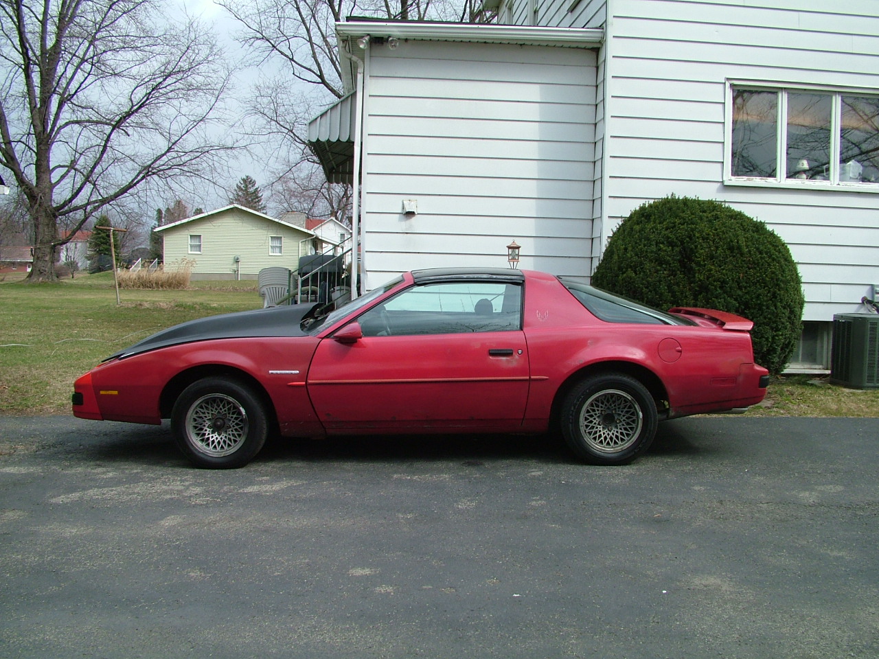

I'll be parting out an 88 Firebird this summer. I bought it for the drivetrain only. Going to put the SC'ed 350 in my IROC so I'll have to get rid of the Firebird. Not sure if I'll have enough motivation in me to put the LB9 in it or not. =)
Let me find a pic...
Driver fender needs fixed, passenger rocker has a hole, cracked windshield but the previous owner coated the entire underbody and engine bay. Feels like rubber, could that be POR15?, never used the stuff. Anyway, I'd probably just be happy if someone took it off my hands when I'm done with it.
