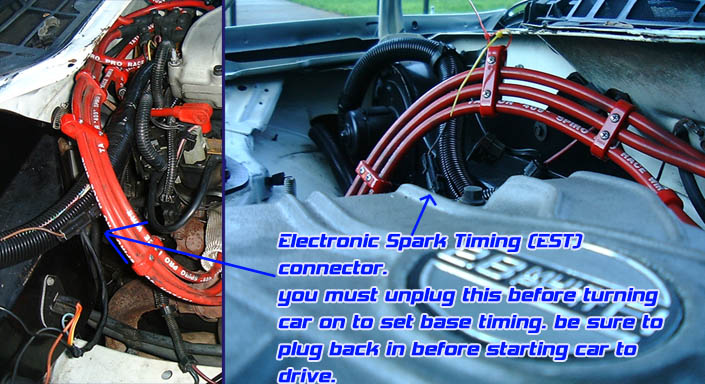

did u unhook the est wire before setting the timing???
if u dont and u hook up a timming light at idle it will read 20*+

the ballancer can only go on one way. i am betting on EST connector
EDIT* i made this for you.
