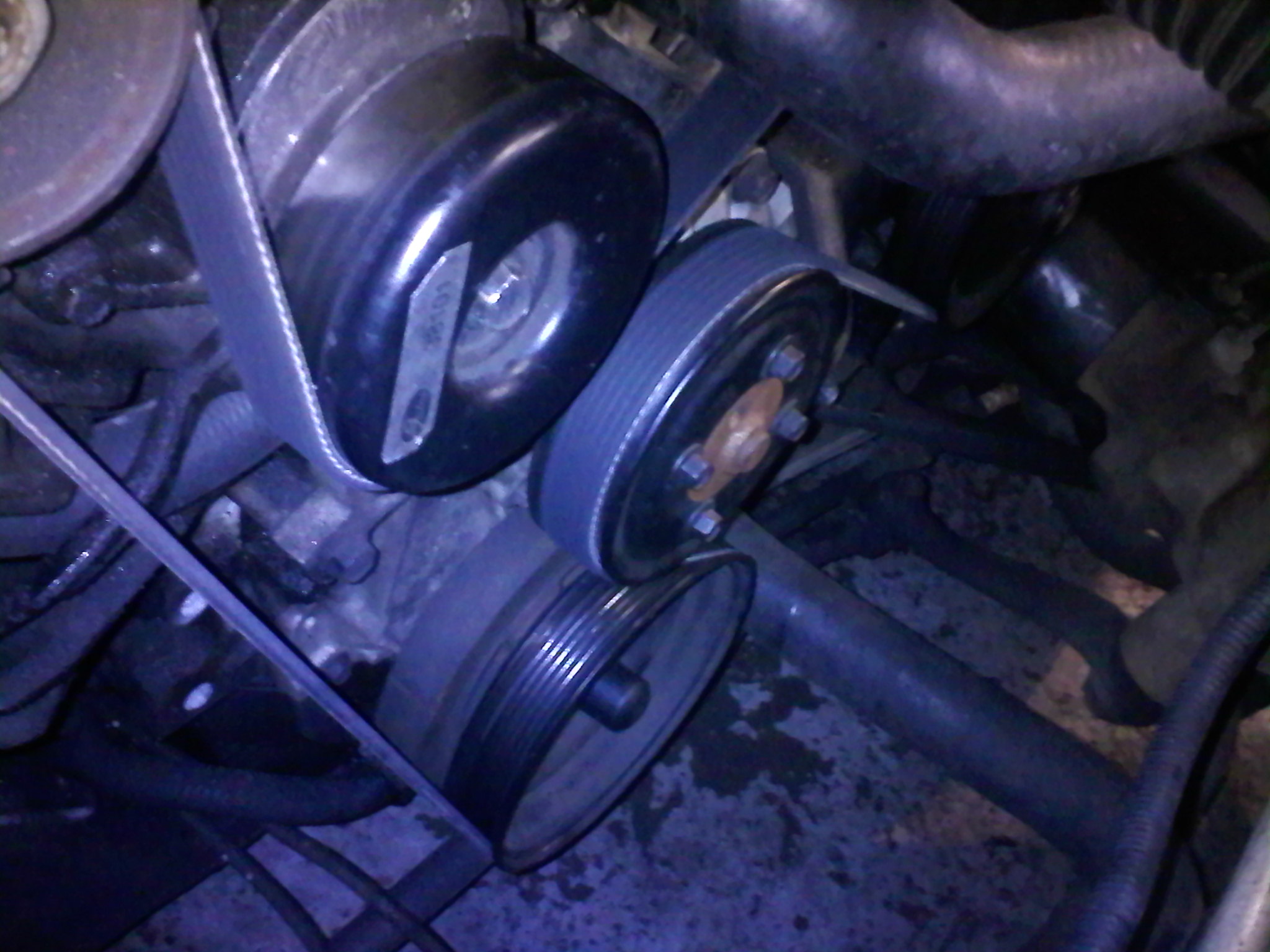

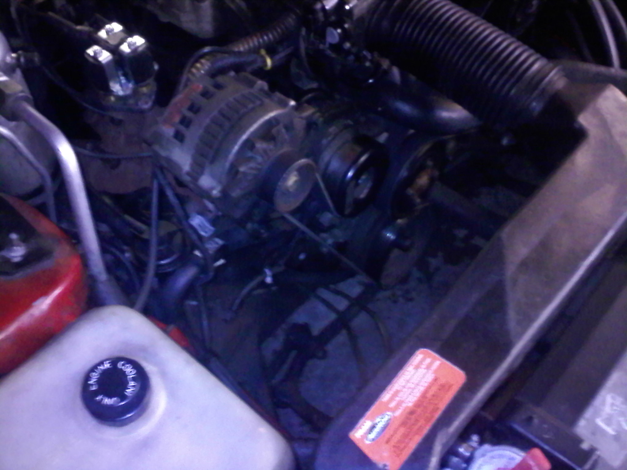

I just went and checked and yes the air pump is there. i just read that my state adopted californias emissions starting in 2009. (2) Motor vehicles with a model year equal to or later than the first model year for which new vehicles sold to Washington state residents are required to comply with California motor vehicle emission standards are exempt from emission inspections under chapter 70.120 RCW. I think that would make my car exempt from emision testing if I read that corectly?

Just tried following the air pump tubes. looks like to me its unhooked. It dosent run to the cat. also the cat on there is the weirdest ive ever scene it looks like its one right after another some kind of double cat? all the exhaust pipe after the Y looks much newer and has a magnaflow muffler so im thinking one of the previous owners put the new stuff on there and didnt hook up the smog pump?

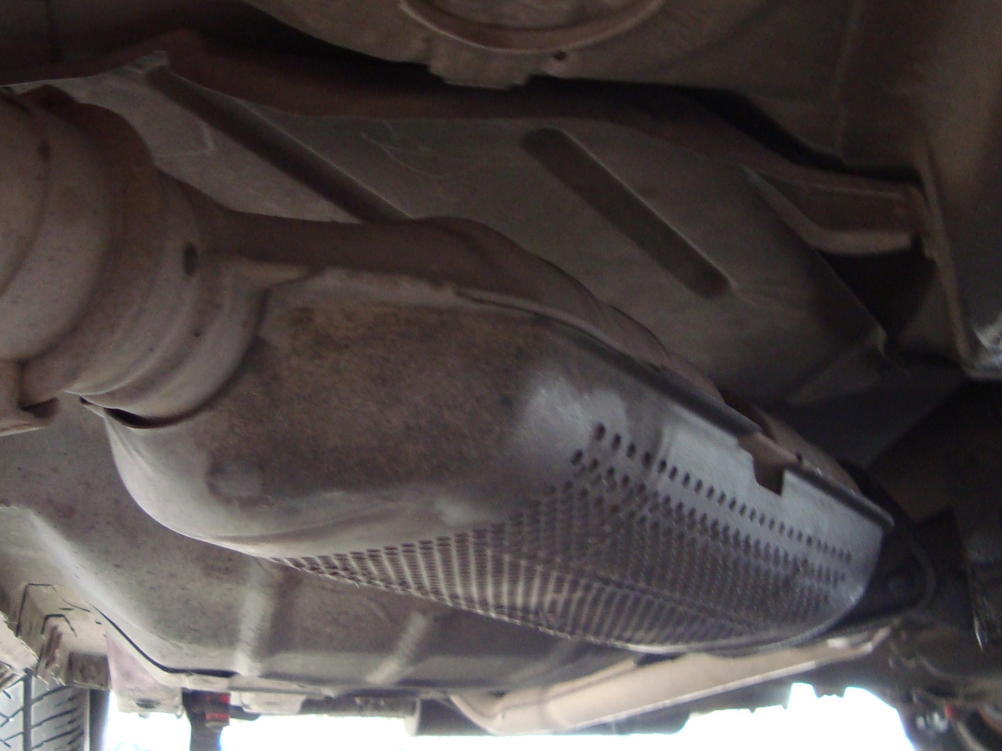

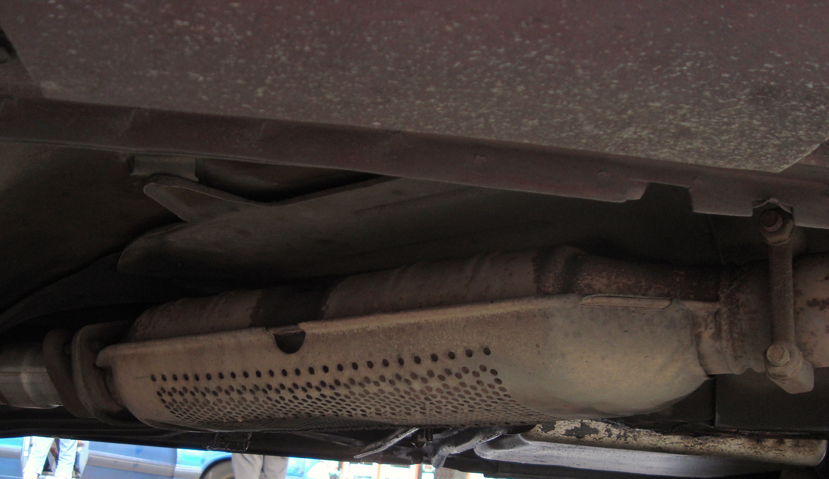

Could be a short, non-direct fit cat and a resonator. Would need pics to verify. However, if the AIR is disconnected at the cat, I'd leave it at the manifold just in case until you verify your emissions controls laws, or you find someone who will pass it regardless. Hold onto the headers until you find out for sure.

Ok I can post a pic later on today. I have to jack it up anyways to check out a transmission pan leak that has come back. I probably over tightened it. I noticed it while lookin at the cat.

Heres pics of the cat thats currently on the car.

Ok here they are. didnt notice upload had failed before I uploaded previously.

That would be a factory dual monolith cat. Same thing as the companies put out today but bigger. That cat doesn't appear to have an AIR fitting on it, so you may be able to get away with not using the AIR stuff. Just make sure to take all of the brackets off and hide the divert valve connector really good. If the car passes emissions the way it currently is, you won't have any problems. The replacement belt you need is a 915K6 or equivalent.

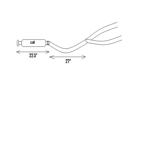

BTW, can you measure the length of that cat for me, from the flange to the y-pipe? I haven't been able to figure out if my cat's short or the y-pipe is screwed up... The whole exhaust from the cat back to the tail is out of alignment and hits the heat shields by the axle (that noise just sucks) if it doesn't hit the front seat belt receiver bolt...

No problem! the cat from the rear flange to the front clamp is about 22.5". The Y pipe from the front flange of the cat to where the passenger side manifold welds in is about 27".

Made a pic
