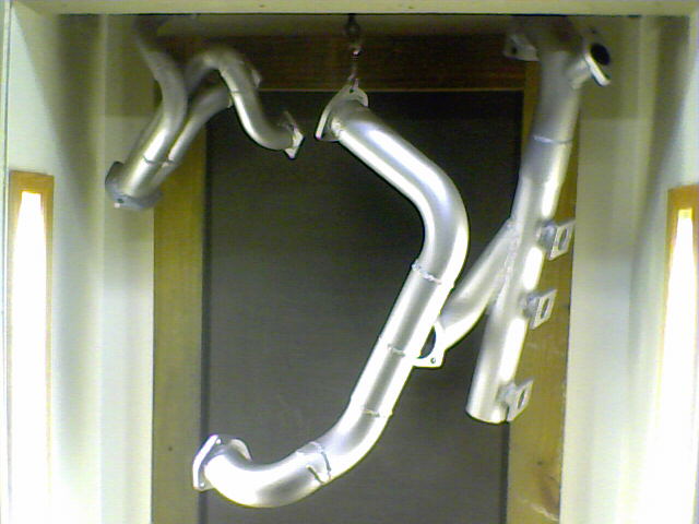

What about header paint?

look into techline coatings, they offer a coating that will work on the headers and it will cure with the exhaust heat. i used it on all my turbo piping.
http://www.techlinecoatingswebstore....minum_4oz.html
header paint for you will not hold up to the standards i feel you have for the engine appearance.
powder coat will work on every part of your engine however...as everything on mine is powder coated. block is aluminum and the accents are a candy teal. oil pan and motor mounts are black
Attached Thumbnails examples of a painted V6 block-exhcoat.jpeg   examples of a painted V6 block-motor-mounts.gif   examples of a painted V6 block-new-coating.jpg

header paint is horrible.
