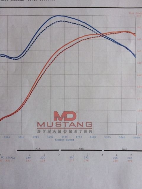

277WHP @ 6000RPM & 300WTQ @ 4500RPM
-Stock 1994 Camaro block, crank and rods.
-3.4 DOHC stock pistons (10.85:1 Compression ratio)
-Supernatural Monaco Camshaft (Solid lifter camshaft)
-Stock CNC Iron heads with oversized valves (1.8int & 1.5exh) with stock stem diameter (11/32 not 7mm like the aluminum heads).
-1.6 Aluminum full roller rockers
-Supernatural Funnel Ram intake with 58mm TPI Throttle body.
-Custom headers and Short exhaust. (Flame thrower)
-Distributor ignition (Upgraded to DIS after this Dyno)
So, with stock engine parts and some ingenuity you can make power with this little engine! Turbo would be following the trend and too easy. Imagine if I decide to go turbo!
Its not just about the power, its also about how fast that power is delivered for faster acceleration!

I think your dyno is a bit optimistic...
There have been many, many NA iron head builds and most BARELY crest 200 HP, and they have a LOT more done to them than what you list here, though your intake IS unique and I bet it probably works well, but not well enough to have an extra 40 to 70 HP over other builds.

I completely understand you SIX, I get reactions like these from people very often. Specially when is from someone they've never heard of that has done something impossible according to common practice.

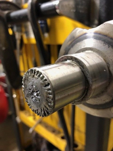

Drive train failures I've had after installing this 3.4 In the 1st picture It killed the tripod in the axle. After installing 2 new axles then I cracked the case of the transmission.
And after installing an F23 trans it just sheared the long axle. As you can see parts can't take the abuse like you RWD folks can. You guys are blessed with all that RWD
beefy rear ends. Imagine if I go to a dragway with sticky asphalt, I'll brake again!!! I wouldn't mind going to a drag to see its potential but I'm afraid I'll break something else!
At least in road racing is less stressful on the drivetrain. I just talked to a local shop that makes a set of axles that I can use that can support 700hp but its $1000 bucks!
I'll have to break my piggy bank!

I had the day off today and took the car to the dyno for the first time on E85 but since some of you accused me of tampering with the dyno I think I will not post anything here any more.

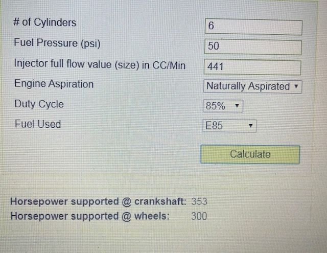

And then I ran out of injector and then I called it quit. Also It didn't want to enrichen when I comanded more fuel. Like the pump was giving up or the filter was plugged.
I can work on making that torque line flatter. I can still squeeze a couple of ponys more once I upgrade the pump and injectors.

It gained about 60lbs/ft of torque @ 3000RPM and about 50lbs/ft of torque @ 6000RPM compared to the previous dyno!
304WHP@6000RPM
309WTQ@5000RPM
Overall I'm pretty happy with the results!

You think I'm talking about bench flow numbers only... AND are you ACTUALLY suggesting that the actual flow through a head has no bearing on what an engine can produce? HAHAHAHAHAHA
Like I said You're NOT making the power you think you are, the iron heads ON THESE ENGINES, no matter how ported, no matter how worked, other than like I already said to completely reshape them with welding them up, no matter what other parts you use in NA form, just can not support the kind of power you're claiming, period, end of story, just CAN'T happen with the way physics and fluid dynamics work. With some form of power adder yes, but not in NA form. The port shape is terrible for promoting air flow into the cylinder no matter what kind of tricks you do before the head flange or after the exhaust flange or how much you squeeze the chamber. Resonance will only do so much and I believe your intake has helped, but no where near the amount you are claiming.
Again, many people have built much more involved, and stout engines than you're claiming, and have not been able to get anywhere near your numbers.
Nothing in that article has said anything I haven't or supported any claims you've made. The only point it makes is that the port flow numbers are not the entire story, but they are a LARGE part of the story when it comes to making power. Like anything it has to be a package, but you can't magically make 25 to 40% more power than anyone else has made just because you may have a different intake or cam than someone else has used.
HP is made by getting more air crammed into the cylinder along with more fuel. The 60 degree V6 iron heads just can not support the kind of air flow needed for the horsepower you are claiming, if they could, there would have been many of these engines already making that kind of power for a long time now. Even GM knew the limitations of these heads and is why they recommended using the FWD heads, where race rules would allow (from their Engine building manuals, starting in 1987, when the FWD head was introduced).
Take your car to the 1320 foot long dyno, post your slip and vehicle weight and that will be a MUCh more real indication of the power you're making. A video of the run will a good idea too. It's very easy to use the wrong correction factor, and you or the dyno operator may not be doing it intentionally, but I very much see that as being the case here.
Reply 0
Dec 26, 2019 | 12:08 AM
Re: 250WHP NA Iron Head
Wait... I see how you're getting such high dyno numbers... you're doing pulls in 3rd gear... Try using 4th, which is almost 1:1 (0.94 for the HM282, which is what I assume you're using, I didn't see any mention of the trans you're using), and that will give a better indication of the power you're making.
Also trying to use Superdave's car as a "wrong parts" bench mark is only hurting your story. His combination was never fully optimized and I do believe a better intake that was designed from the ground up for ITBs would work far better than the setup he had (it used a stock LIM, which has poor runner designed for ITBs IMO), and a better exhaust system that used tuned length headers for his desired RPM range would have helped as well. Those runs he made with the air filter housing in place, which he said really choked the engine, but didn't want to drive around without a filter. That was also wheel horsepower through an automatic trans, so he was very likely over 300HP.
Reply 0
Dec 27, 2019 | 06:10 AM
Hes using 3rd gear on a manual to dyno??? Well thats strange... what's the ratio...1.38?
Reply 0
Dec 27, 2019 | 02:09 PM
It's not uncommon for people with manual trans to dyno tune in 3rd gear because it's easier on the clutch. Ram clutches actually recommends that for my dual disc clutch. But if you're going to post numbers on the fridge for mom and brag to your buddies, then you better get in the right gear (1:1).
Reply 0
Dec 30, 2019 | 10:26 PM
Quote: It's not uncommon for people with manual trans to dyno tune in 3rd gear because it's easier on the clutch. Ram clutches actually recommends that for my dual disc clutch. But if you're going to post numbers on the fridge for mom and brag to your buddies, then you better get in the right gear (1:1).
I've never heard of anyone using other than the 1:1 gear or as close to with any transmission, especially since using a lower gear is going to multiply torque which will skew numbers, increasing them beyond actual. If any manufacturer recommended to me to use any but the 1:1 gear (or as close as there is), I wouldn't use that clutch, sounds like a shitty clutch to me, if it can't handle a dyno pull in the 1:1 gear.
Yes, 3rd gear is 1.38:1.
Reply 0
Dec 31, 2019 | 12:35 AM
Well, good news is from today forward you can no longer say you've never heard it.
You can tune the engine in Horsepower or Goatpower. Doesn't matter whether you're in 3rd or 4th as long as the engine is adequately loaded and doesn't spin up too fast. Comparing your results to other people means you need to be in 4th gear though.
Reply 0
Dec 31, 2019 | 12:42 PM
Quote: Well, good news is from today forward you can no longer say you've never heard it.
I've looked on the Ram Clutches website and any mention of chassis dyno there seems to be no mention of using 3rd gear for pulls, just that a chassis dyno will cause one of the highest loads on the clutch, which is a given.
Like I said, using any other gear than 1:1 (or as close to as in the trans you are using), skews the numbers, so they become meaningless and using a lower gear the engine WILL rev quicker than in a higher gear, hell might as well use first then, take all of the load off the engine/clutch... if the gear doesn't matter...
So in short it absolutely DOES matter what gear is being used, beyond just comparing to other people... but since the OP wants to compare to other people, it matters just from that standpoint, let alone being completely wrong way to test for power using a chassis dyno.
Reply 0
Dec 31, 2019 | 02:15 PM
I'd like to see some trap speeds... easy enough...
and from engineers themselves (informally) https://www.eng-tips.com/viewthread.cfm?qid=91122
Reply 0
Dec 31, 2019 | 07:03 PM
Quote: I've looked on the Ram Clutches website and any mention of chassis dyno there seems to be no mention of using 3rd gear for pulls, just that a chassis dyno will cause one of the highest loads on the clutch, which is a given.
Look, all I did was share a tidbit of info for people that might be interested. I actually use Ram's top dog street clutch and have more info than you can find on the website. I've had conversations with Mike Norcia about this too when I had my clutch rebuilt. It appears your first instinct is to argue, and thinking is secondary to keeping an argument alive.
As far as the dyno tuning, the problem again is your instinct to argue instead of think. You can't even recognize when we're on the same page for gosh sakes! And if that's the case, then how can I possibly discuss with you other details? So I'm checking out of this conversation because it's not profitable.
Reply 0
Jan 1, 2020 | 07:00 PM
Quote: Look, all I did was share a tidbit of info for people that might be interested. I actually use Ram's top dog street clutch and have more info than you can find on the website. I've had conversations with Mike Norcia about this too when I had my clutch rebuilt. It appears your first instinct is to argue, and thinking is secondary to keeping an argument alive.
Good for you, but I like to put an end to BS information before it gains any traction, and that's why I am replying to what you said (clutch manufacturers recommending using 3rd gear), it's not arguing, it's just pointing out errors of what you said. If you see that as arguing than most things people say are arguing. *shrug* I tried to find information to verify what you are saying and found nothing that would confirm that. I've not once ever read that, or been told that by anyone (except you), including clutch manufacturers or dyno operators, because it will skew the numbers, I've always heard, read, discussed, watched, etc that the 1:1 gear is the one to use for power testing, and have done so in my own vehicles.
I don't see us being on the same page other than to compare one engine to another to be in 4th, which agreed with you on..., maybe I should have said at the end "I agree", but I didn't think it was necessary... *shrug*
Reply 0
