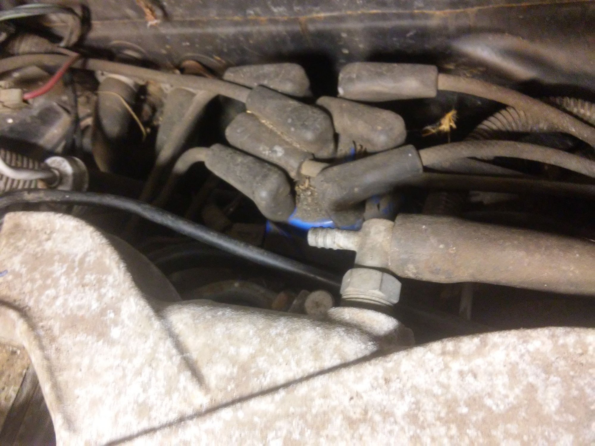

Ok so I have been working on my 89 firebird. It ran well when I parked it.... In 2013. Now that I'm working on it again I discovered a vac line missing that I'm pretty sure was there when I parked it. The vac line goes to the rear of the intake manifold on the passenger side.
It has what appears to be a t connector on it that goes to the brake booster I believe.
But where does the other end go.

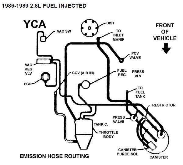

I have a vac line schematic but it just isn't making sense to me atm.
Any help would be greatly appreciated.

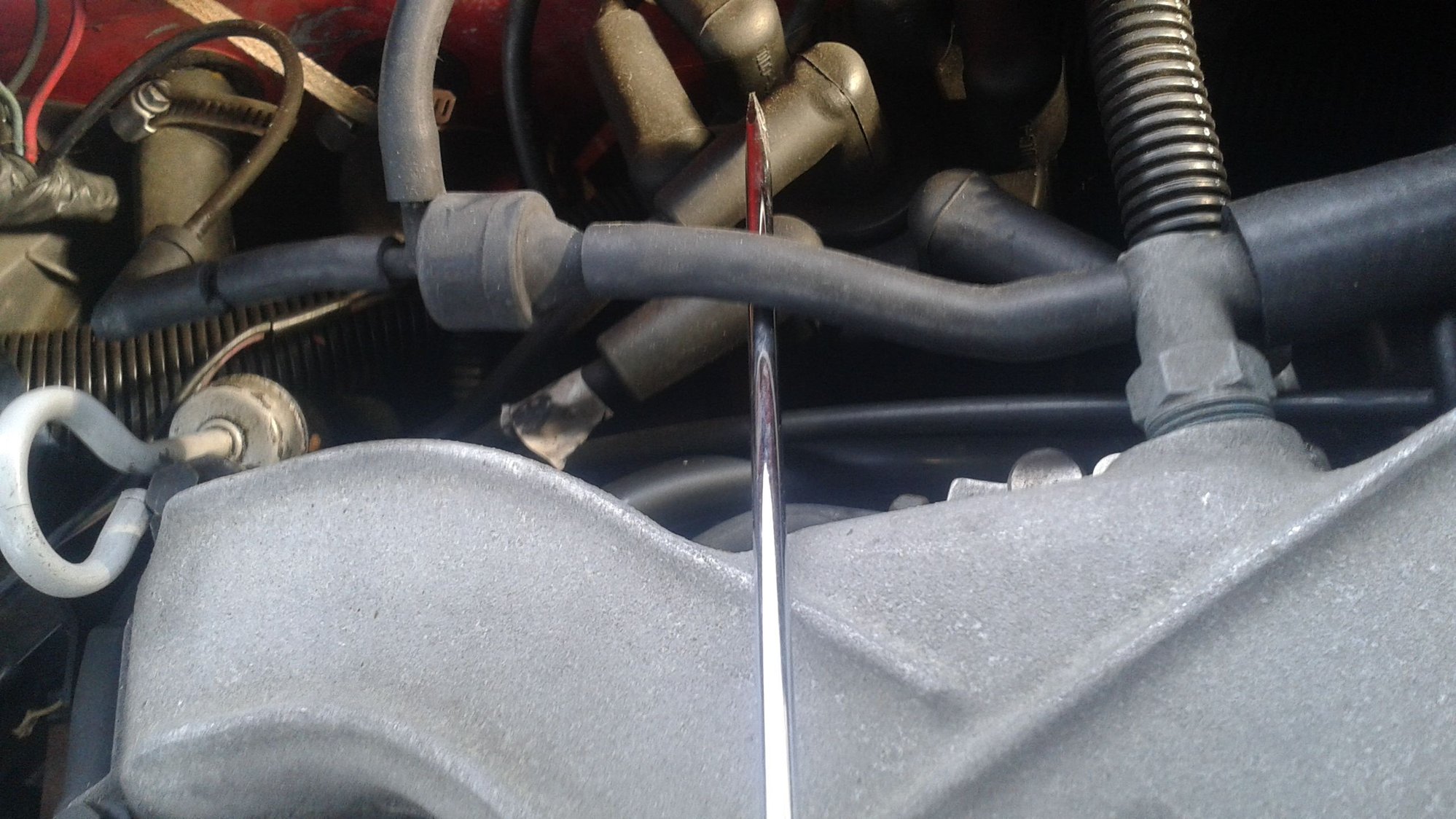

The photo is from 88 2.8 Firebird. The missing vacuum line on this goes to a tee that splits off. One side of the T has a small plastic tube that goes into the wiring harness and into the car for the heater control. The other side of the T goes to the cruise control vacuum canister. You should be able to cap it off until the car is running correctly and deal with it later.

Thank you. now it makes sense. The car has received a new fuel pump, alternator, battery, and belt. She tried hard to run but it just didn't happen today. The few seconds it done run it sounded great, but it kinda acts like it's getting gas sometimes and Sometimes not. I'm thinking a fuel filter will probably be in order.
