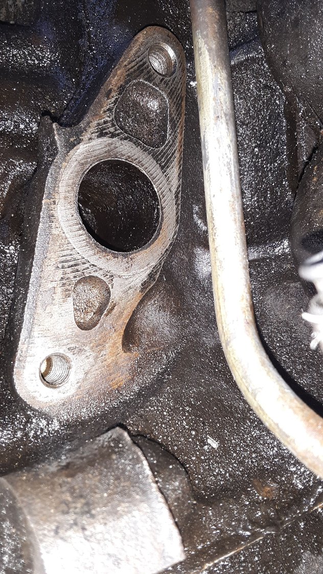

The tension created by the steel fuel line pressing against the FP, is making this impossible to do single handed. I'm going to have to get a second person to push and hold the fuel line against the block while I get the 7/16" FP bolt started. I can get either the lower or the upper bolt started. The upper one is the more difficult to get started, because of the angle from above the FP, in order to start the bolt. ( I can't get to it from under ).
Even with only a thread or two of the upper bolt holding the FP in place, I can't start threading the lower bolt, because the FP can't be wiggled enough ( again, because of the fuel line ) to get the bolt lined up and threaded into the hole. I tried tying a string to the fuel line, to hold it back from pressing against the FP, but the angle is wrong. All I'm doing is pulling the line down, not back, like I need it. Otherwise this job would have been done long ago. Aside from the fuel line, it's not that tough a job.
With FP in place that #&$@ Fuel line causes problems
Another shot, (further back) of fuel line, the bane of my existence.

Just curious, can you disconnect the fuel line at the carb to give some "wiggle room" down at the fuel pump, and then reconnect the line at the carb once you've got the fuel pump installed?

Hopefully that should give you all kinds of play at the fuel pump end to get it hooked back up
