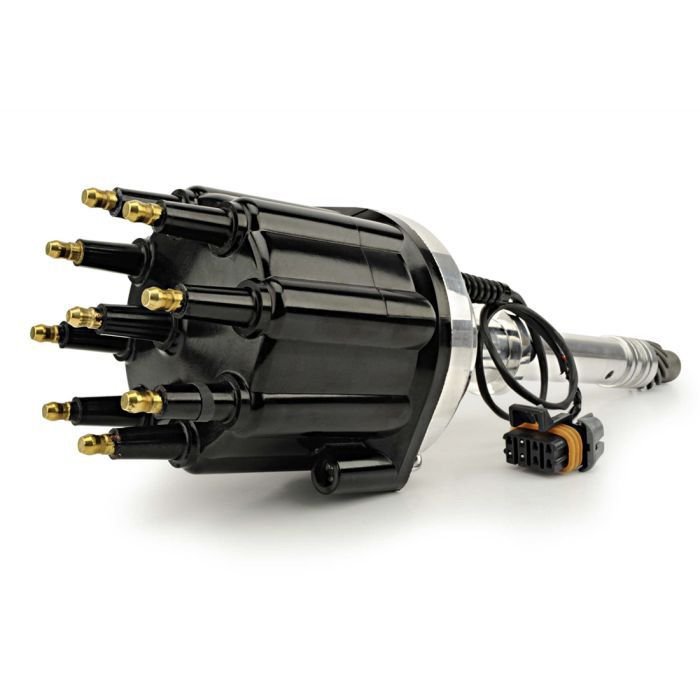

- FAST's Dual-Sync Distributors
- FAST's Crank Triggers
So here in lies my question, HOW can I adapt this, or WHICH would I use?
They do not make a distributor for V6s, but the one for the V8s look almost identical to mine (it's for a Small Block Chevy). How likely is it that I can take the ignition control module from this V8 distributor, and adapt it to my V6's distributor?
The other option is a crank trigger. They offer this for the small block Chevy:
So the question I have is... can this be used on our V6/60s? And my second question... if not, does the 3.4 V6/60 in the 93-95 Camaro / Firebird use a crank trigger, and if so, can we simply adapt that one? It looks to me like the only thing it's looking for is a pulse... ON / OFF.

Copy/paste:
Your distributor should have a 4 way connector and a 2 way connector. The 2 way should just be factory wiring to your coil. On the 4 way:
  1. Dig Gnd connects to the Black/White Wire in the Distributor Connector on the EZ harness
  2. Bypass will need to connect to a Red/White 5v wire from the ECU. Fuel Pressure sensor lead might be the easiest place to splice in.
  3. Hall Crank will connect to the White RPM Input wire in the Distributor Connector on the EZ Harness
  4. EST is the Electronic Spark Timing wire. It will wire to the Brown Points Output of the ECU, but a digital relay or transistor needs to be in-between to convert the Ground Switching Signal into a Positive Switching signal.
He said that if I go with the 6EFI, then I wouldn't have to worry about trying to convert that signal, copy/paste:
"The MSD box, like a 6EFI, is the Easy button. At that point, you just hook up our Points output to the Points input on the MSD. Our ECU triggers the MSD at the correct ignition timing and MSD takes care of firing the coil. Still hook up Batt Pos and Neg to your module in the distributor and R from the Module will connect to the White RPM input to our ECU. You wouldn't have to worry about wiring 5v to the Bypass or wiring EST at all."

Originally Posted by 82-T/A [Work]
Yes, the signal from the ICM, which is a ground-signal, needs to be converted to a digital Positive Switching signal for it to work with the FAST system, according to the tech.
Copy/paste:
I understood exactly what was described by your earlier post and that will NOT work, it WILL destroy the ICM, if you use it to feed the ICM, this outside of what the 6EFI was intended for.
The output from the ECU is a ground trigger, and that is what the the ICM needs. At most you MIGHT, and I highly doubt it, need to add a pull up resistor to this signal, a 10 cent solution.
Again, this is my experience with FAST, the "tech support" doesn't understand know their product and especially don't know how to deal with even slightly out of the basic install uses.
Can you tell me what these are? If they do not involve creating my own wiring harness from scratch, sitting with a laptop and having to reflash PROMs, or going to the dyno to "dial it in," then I'm definitely interested. I have a feeling you're talking about Megasquirt... and honestly, they're just not there yet. Megasquirt is great if you don't mind the time investment into getting it working properly, and either working with a dyno owner, or making many WOT runs up and down the road with data logging and constantly changing the values.
Thanks!
Megasquirt, Holley, MaxxECU, ECUMasters, Haltech and many others.
I don't understand the "money is no object", but you don't want to actually invest in getting your car to operate at it's peak.
Like I said I have used FAST in the past, which includes the EZ-EFI 2.0 and it's absolute garbage IMO, for the price you should have the option of manual tuning and there isn't.
I've used/tried "auto tuning" from a few manufacturers and NONE actually tune the VE table fully to be optimum. I do use auto tuning somewhat often, to rough in a VE table when I am working by myself, but this just gets the VE tables in the ballpark and always require manual tuning to dial in the tune. There isn't a single system out there that has any sort of auto tuning function for spark timing and IMO, spark timing is where you can really dial in the way an engine runs. Yes, tuning the fuel side is important, but can be pretty forgiving IMO, where as a properly tuning timing table really makes for an engine that operates smoothly. The EZ-EFI only has a 3 point curve that leaves a lot to be desired.
Holley is a better choice over EZ-EFI if you want "auto tuning", but the Holley still has the ability to manually tune, which you will want to do, even you think you don't right now. It has a basic setup wizard that allows for very basic function, similar to the EZ-EFI, but again can be much more finely tuned with software/laptop later. Holley has harnesses, which are OK, that could be close enough for your application, but because it's a Fiero, will require some level of modification anyway, as I'm sure the EZ-EFI harness will, and there is no hackery with an additional box needed, it will directly interface with the GM ICM, with FAR better support than most other companies out there. Holley's closed loop is hands down the BEST closed loop functionality that I have ever used.
Again, if "money is no object", then paying someone to build a harness and/or tune the engine shouldn't be an issue. It sounds to me like either money is an issue or you don't want to have anyone else work on your car, and are not willing to spend the time to learn a valuable set of skills.
For the other comments, this isn't about someone making a different choice, it's about relaying my EXPERIENCE, since automotive electrical and specifically EFI installs and tuning are what I do for a living, and pointing people in the direction(s) that will serve them best, but what they say, and by also knowing what does and doesn't work well. The same system doesn't work for every application, which is why I use a variety of systems for my client's needs, it's just most of the time a Megasquirt will serve them well, other times, a Holley works best, sometimes an ECUMasters fits the bill better, or a Haltech.
I'd like to know what you feel is lacking with Megasquirt. I have used different versions of the MS on many applications, and it has always worked well, and in many cases has more features than more expensive or recognized ECUs. The only thing I'd like to see added is native hardware support for DBW, instead of adding on a module to do that (Holley or Haltech are my go to for when that is needed). Built in transmission support is not something I really need often, and go to a Holley ECU for that generally, or add a Microsquirt to an MS system. Honestly, you sounds like many who say the MS is lacking and I suspect you haven't looked at them since 2010 or so, when, yes they were lacking and I avoided using them then, but the current MS3 offerings, especially the Pro versions are VERY capable, and are constructed well.
Either way, if you're stuck on the EZ-EFI, yes, it will get your engine running, but I really don't think you'll be happy with it in the end, next to no one I have spoken with or had contact with that has used them has been happy with them, and I come into contact with a lot of people regarding EFI installs and swaps. The ones that say they are happy I don't think understand how much better their engines can run, especially when I see them fire up and they are sputtering and rough, but hey, they idn't need to pump the pedal before it started, so that's good, I guess? I have one car upcoming that has an EZ-EFI system on it (1.0, not that it really matters), and it's being switched to a Holley Sniper, because the EZ-EFI hasn't ran right for a long time, maybe ever, and no matter what is done, since "tuning" the system is very lacking, it never really improves, and that is a common experience with these. Again, the firmware for the EZ-EFI hasn't been updated since 2010, which tells me they don't care about improving the system, and just go on the "if it runs, that's good enough" idea. It's an outdated system that has long been surpassed by many other systems out there. Hell, even FiTech seems to have a better handle on how to make a system actually perform, I haven't used one yet, but even the FiTech has the option for manual tuning, and they have MPFI based systems as well.
