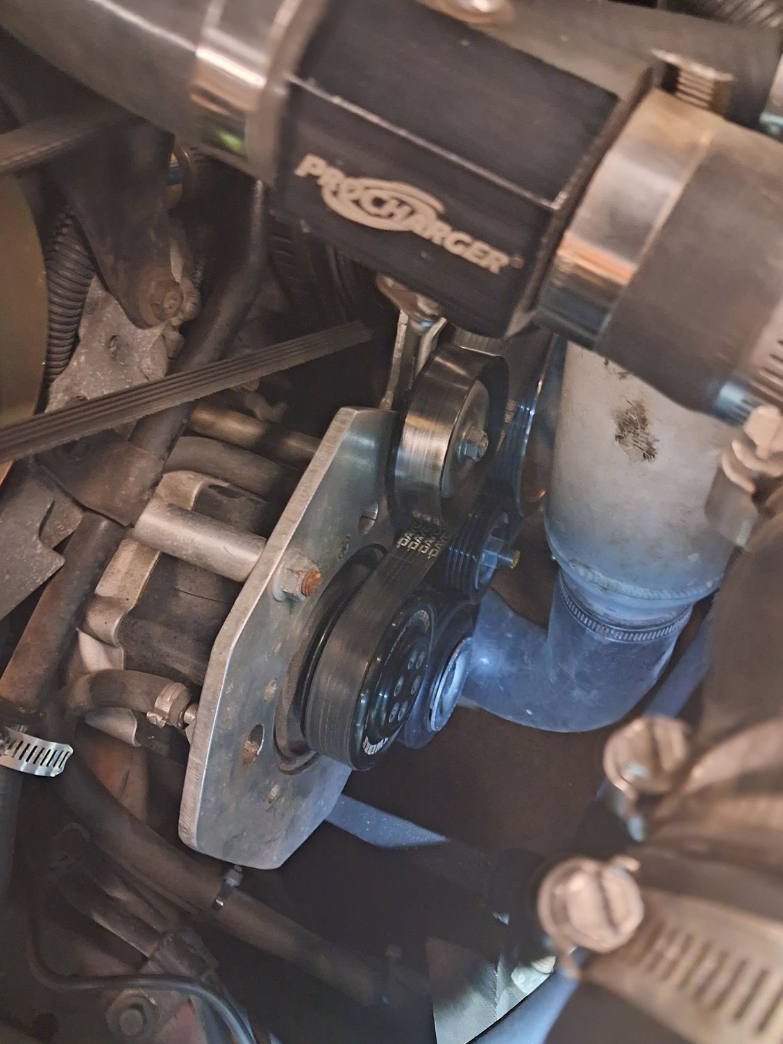

I supercharged my 3.4l-swapped '91 Firebird a few years ago. I removed the smog pump and installed a Vortech V3 in its place. Since that post, I've dropped the pulley size and am making about 6.5 PSI max boost. The build has over 12,000 miles on it and has been trouble-free so far! Other than the supercharger, you'll also need larger fuel injectors and a way to tune the car. Flashing ROM chips or installing a Dynamic EFI system are the two ways to tune the stock fuel injection system. A wide-band 02 sensor is also very helpful I went through 2 different wide-band systems that turned out to be inaccurate and failed very quickly. I finally settled on a Spartan 3 v2 from 14point7.com and that has been reliable so far... Knock on wood.

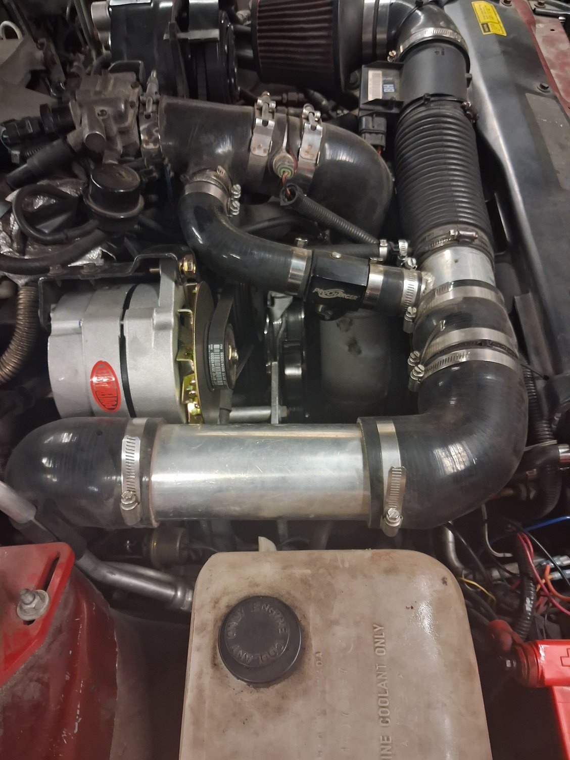

I added a Rotrex supercharger in place of the air pump. I had to fabricate everything, and am running a liquid intercooler. I am going to run a Holley system to tune it because it bucks under boost. I have been running it for 2 years but back off under boost.

I got mine back in 21 from ebay someone bought it and could not use it. I got it for around $1500.00. I not sure what I got into it. I will try to post some pictures later.

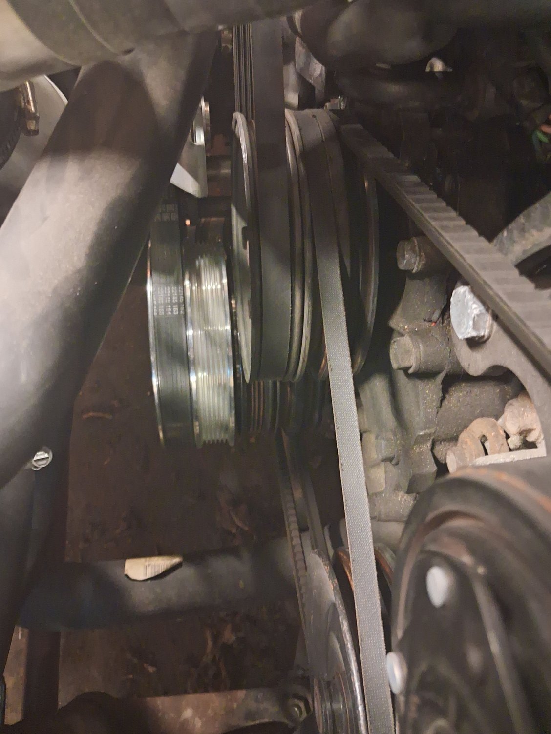

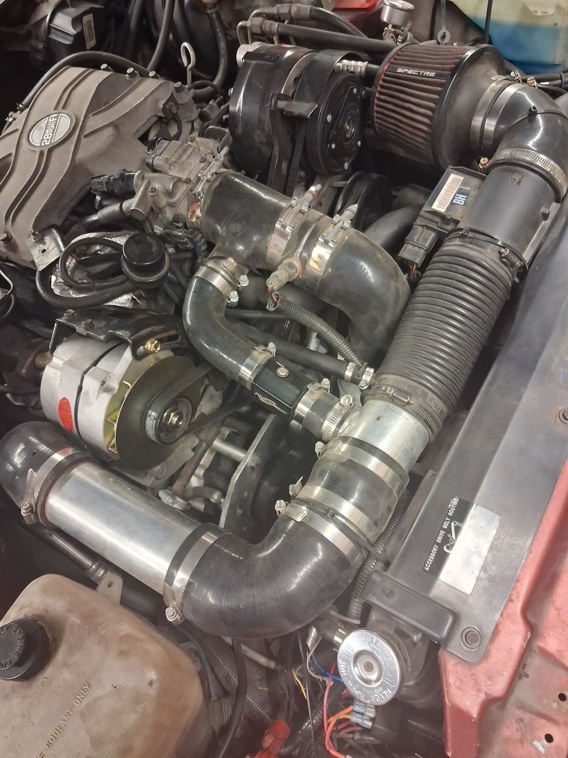

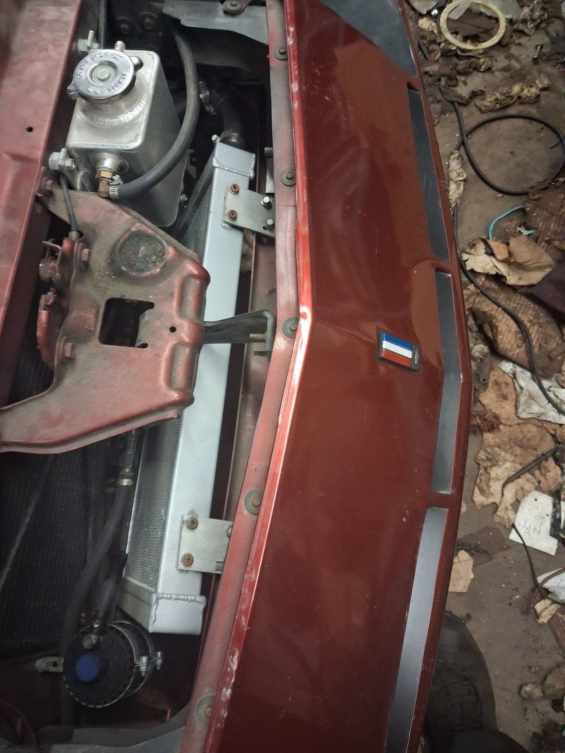

Hear are some pictures of my supercharger.

Good lookin install Dana, cool that you were able to keep AC on it! Hope the ECU swap goes smoothly for you, that car is gonna be a ton of fun

Thanks, the only thing I had to do to the belts was run the alternator just off the water pump. It originally rand from the crank and the water pump, it would have been in the way of the supercharger. This car did not come with ac, I added it on. It is a fun car it is a 5 speed, it will be more fun one I tune it.
