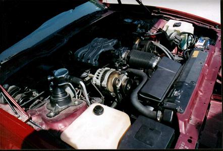

Um, TomP's right, I have a 89, and the dirty air comes in thru a slant which leads to the center of the filter, and then the clean air goes toward the outside of the filter. Funny, I changed it, a few days later, on the inside of the filter closest toward the MAF sensor, it was DIRTY already, so I rotated it.

If thats correct then the 88-89 V6 firebirds got slightly mistreated by GM... The first thing I'd be doing if I had the old style intake ducting is to upgrade to the later hardware. I'm still not convinced this is accurate, I'll have to research it the next time I'm at the junkyard.

Kinda hard to see, but my car has that really restrictive intake. You can see the filter lid is the kind with the slant.
