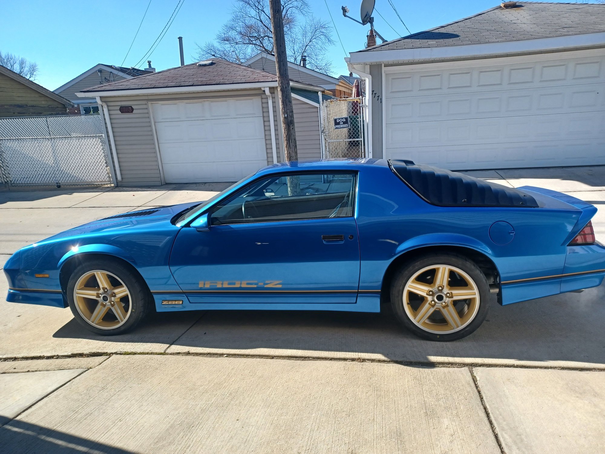

I just purchased a set of aftermarket 18x8 IROC wheels for my 86 IROC. I know the stock wheels were marked fronts and rears. These are not. Does it matter how I mount them? Also do I use the factory rear spacers that are on the rears? Thank you.

The factory 16" wheels were marked front and rear because the wheels will hit the tie rod on the front and needed a different offset. The 18" wheels will clear so it doesnt matter

Got them on today! Just trying to figure out how to secure the center caos right.
caps I meant.

Very nice car! Great color.

Looks nice. Do you have a link to this wheel? Haven’t seen the gold in 18”.

They dont make them in gold in 18s. I actually purchased the silver and black 18x9s had them stripped and powder coated silver and gold
