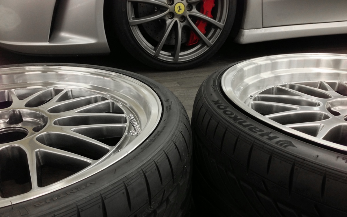

That's not half bad. The pic I seen was actually 20x10.5s on 255 35s , which looked super stretched. I'll attach the pic. How much difference is a 255 35 to a 255 30? Because I have a quote for 460 for a set. And yesterday evening I got a quote for 560 for a set of 275 35s. Me being lazy on top of wanting to be able to rotate my wheels I'd rather just get a full set of the same size tires. So I guess it comes down to how bad would a 275 look in the front as opposed to how a 255 would look in the back.

255/35/20 is 27in tall
255/30/20 is 26in tall
275/30/20 is 26.5in tall
if you wanted a square set up i would do 275/30/20 all around and deal with the rubbing in the front which may not even be an issue depending on how good you are with measuring and ordering the proper spacers. i dont think this will look bad at all, i just rather do staggered on a muscle car
