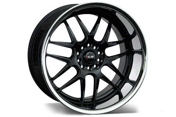

found these xxr 526 . i think im going
with these

Re: bmw wheels .
yea couple have those rims in the forum

Re: bmw wheels .
yeah i really like the way the xxr 526 look on the third gen .
