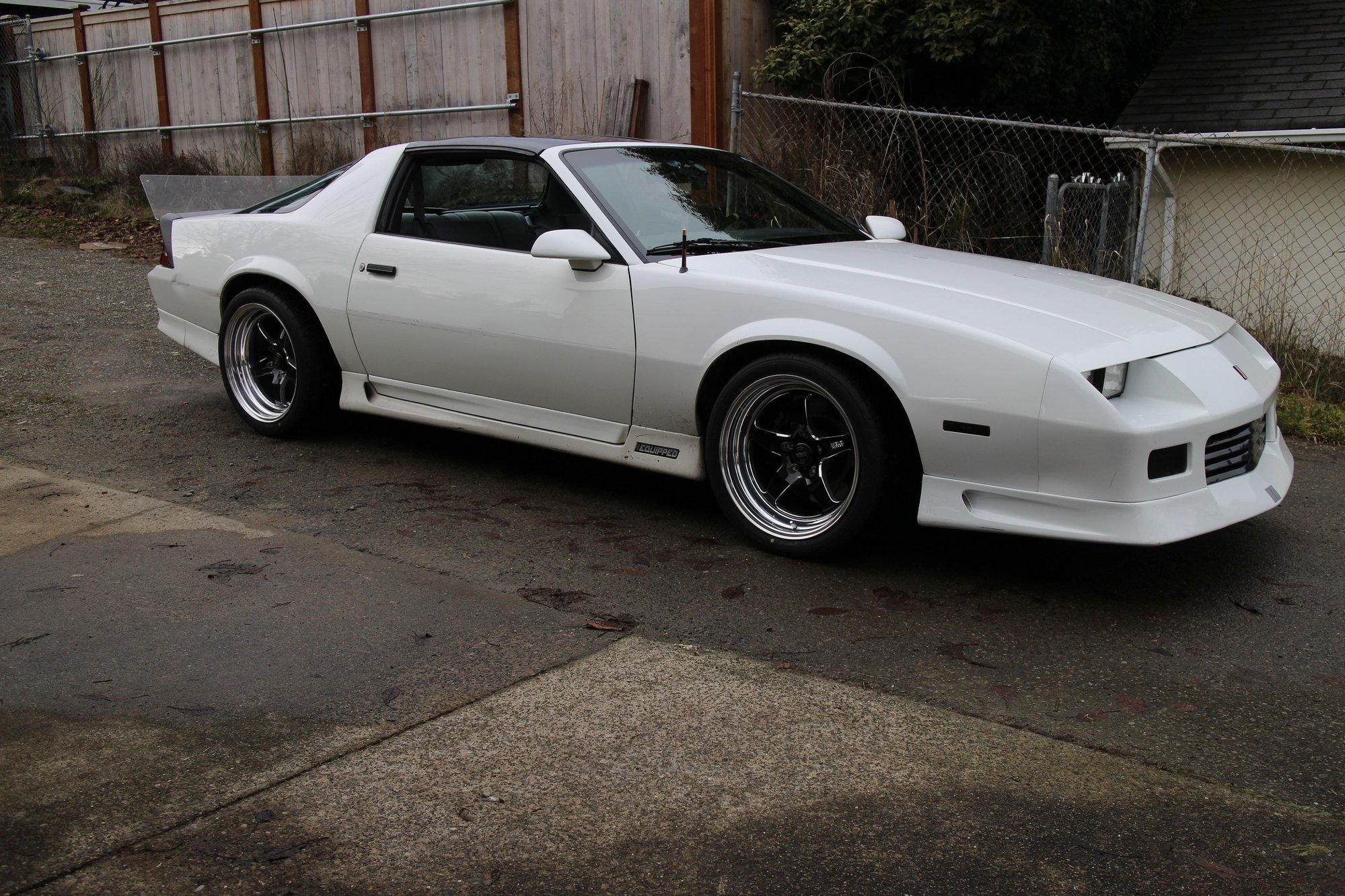

WELD RACING S71 18X11
The wheels on my 92 Autocross car with a unfinished 10in spoiler
6.6in of back spacing on all 4 5/8in spacers in the front to get the back spacing needed and still be able to rotate tires

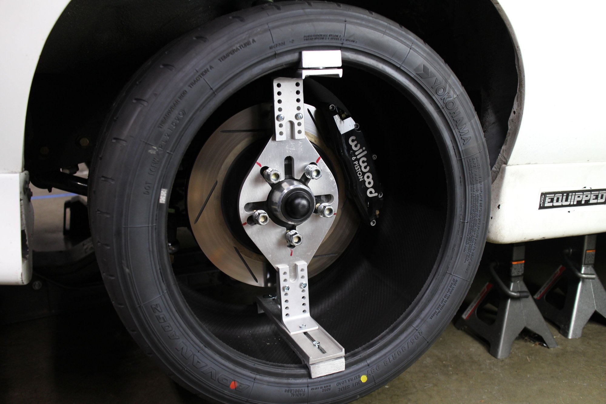

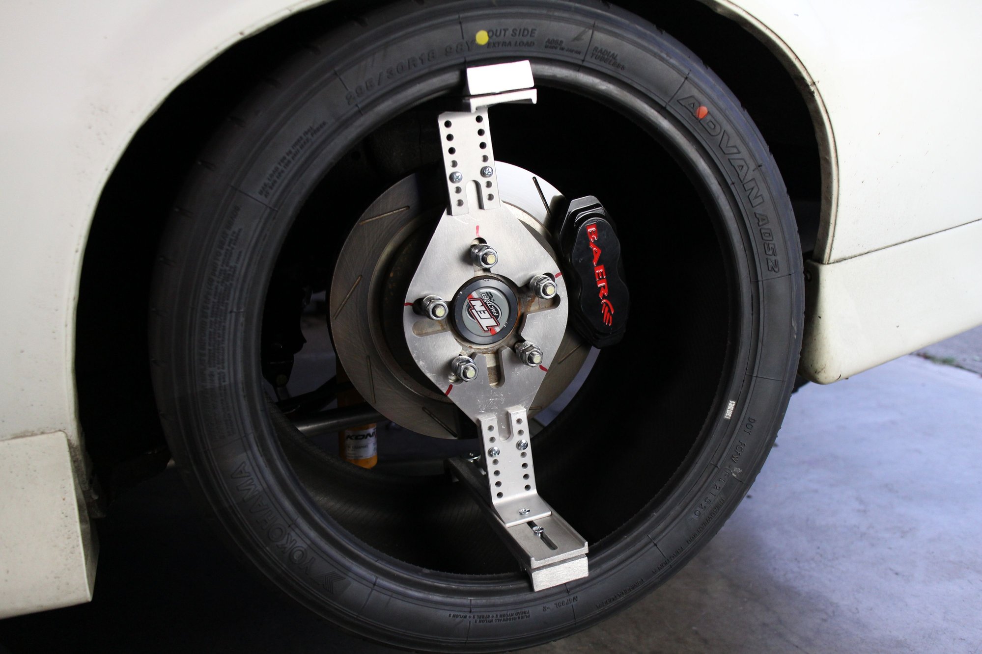

The first steps was to determine what back spacing would work with 18X11s and the tires i choose.
I used a very expensive (Wheel-Right) fitment tool
it can be rented for $50 if you can wait for one to show up

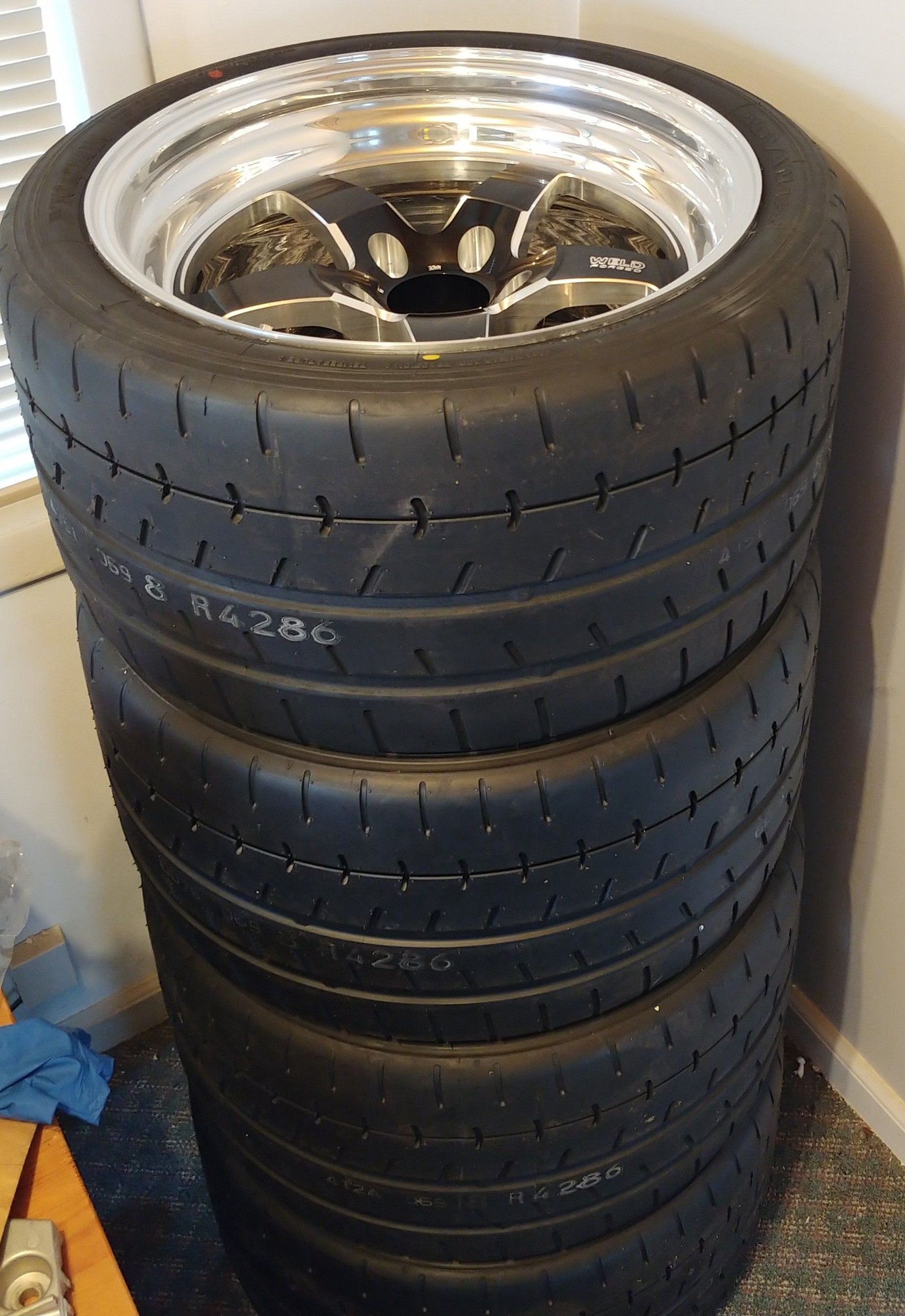

the tires are a 200TW Yokahama A052 295/30R18 that measure 12-1/4in wide
as with 200TW Autocross tires they often times under rate the width
these 295s are wider than 315 TOYO 888R and are about the same width of the BFG Rival 315s
6.0in of back spacing simulated for the front. Note that my BBU Wilwood brake kit pushes out track width my 0.300in on each side
rear set to 6.5in of back spacing, rear end is Stock track width

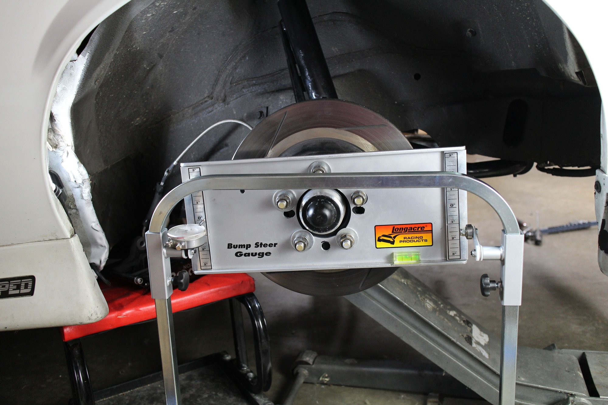

Bump steer kit was used to correct HORRIBLE bump steer from the 1/2in extended ball-joints
0.002in of bump steer, nearly PERFECT!
i'll be making a solid Stainless spacer to remove these ugly steel shims.
added some nuts behind the steering stops as an easy fix.
Bump Steer kit fits under the 18x11s with 0.955in of spacers. About 1/4in of room between the wheel lip and the bolt. Aerospace 12 point bolt
1/2in extended studs Via QA1 Ultimate ball-joints Bump steer kit is REQUIRED if you install extended studs.
Bump steer kit was used to get 0.002in of bump steer at TOTAL front suspension travel. nearly perfect. Race teams recommend no more than 0.010in at each inch of suspension travel.

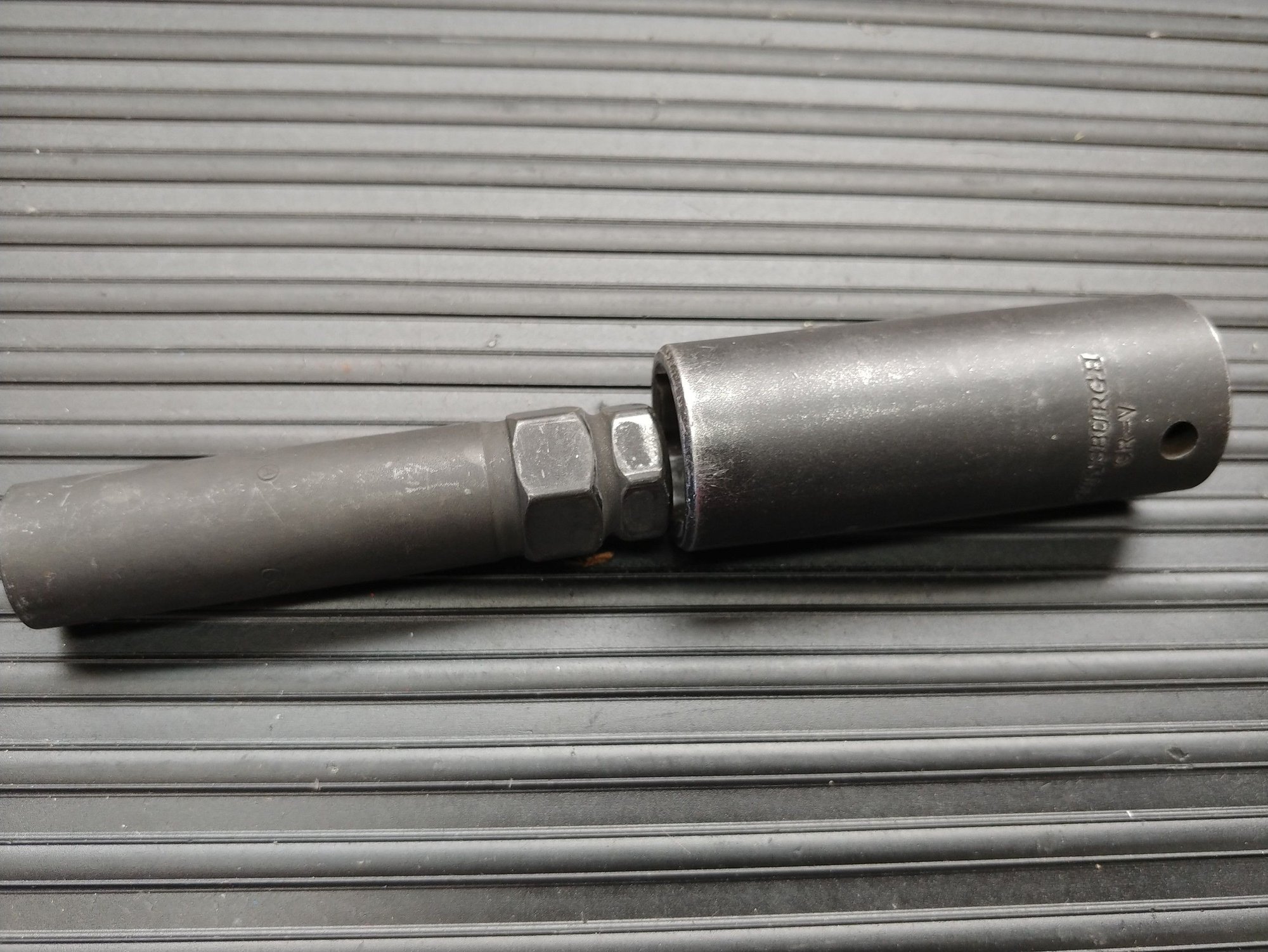

3in ARP studs are used with 12mm x 1.5 acorn LUG nuts with plenty of threads to spare
the lug nut spline socket has no 1/2in drive on it.
so it was welded on a 21mm socket for ease of use

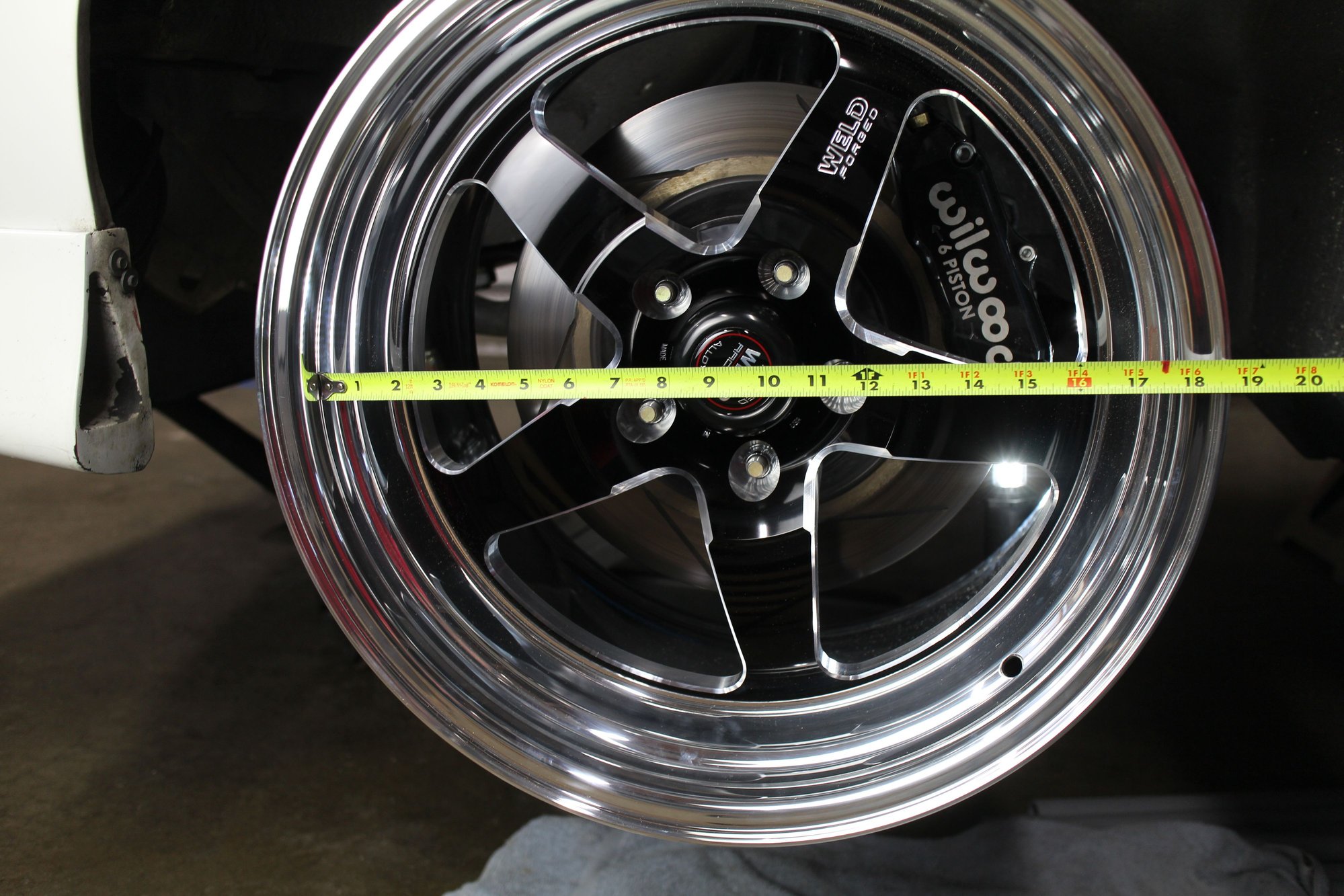

caliper to wheel distance is 1.5in with my 5/8 spacer. 1in of you ordered the wheel with 6.1in of back space

I used little 12mm x 1.5 acorn nuts as the WELD wheels have small Tapered seats.
The acorn nuts have a dumb socket
A quick pass with a TIG welder makes a single socket. Spline socket+21MM SOCKET

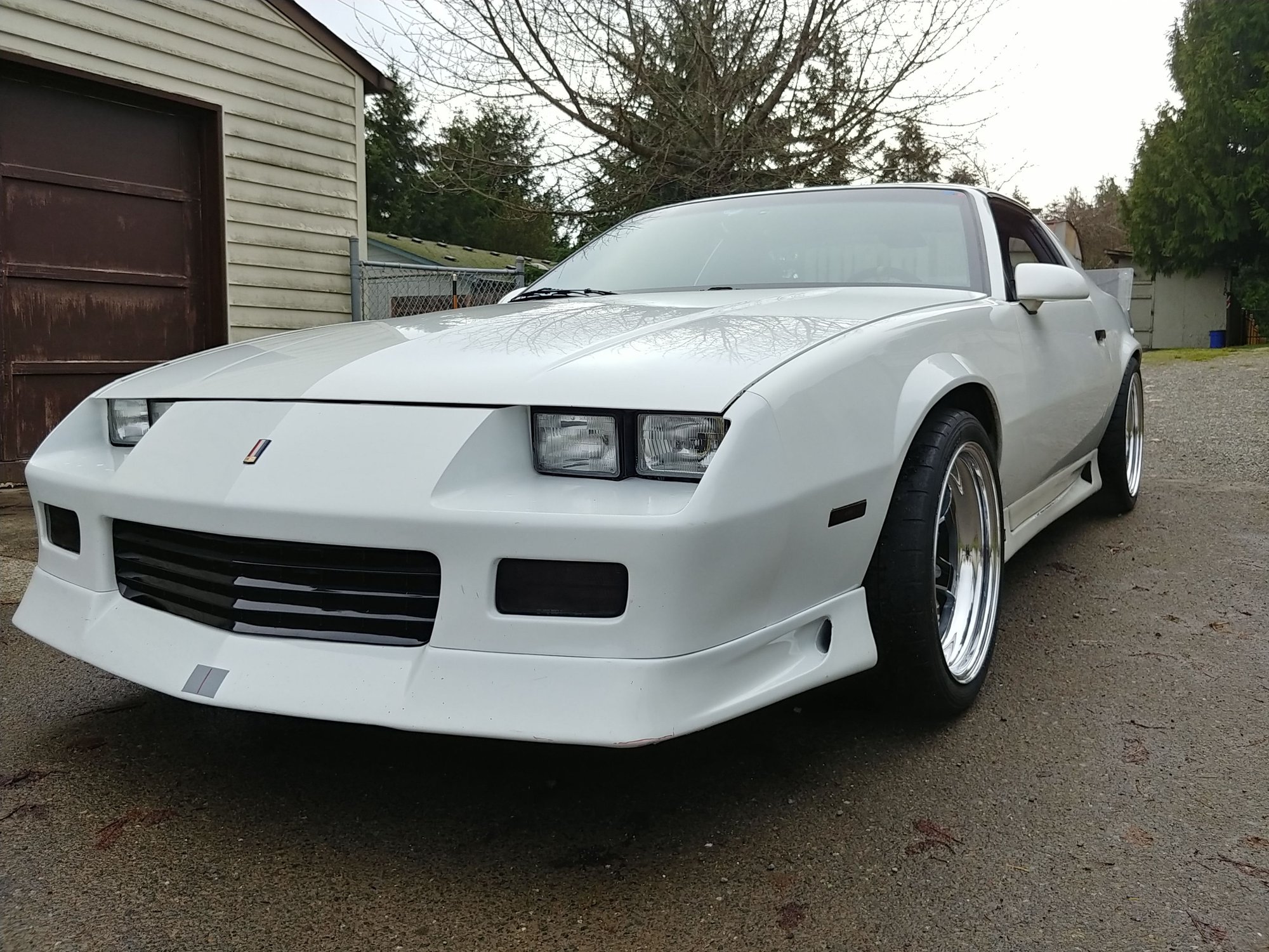

Some Misc Pictures of various things
tape on the bumper for chin splitter fitment
18x11 on the rear

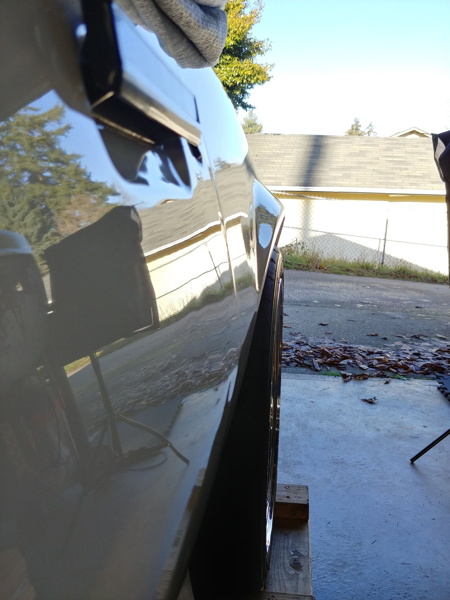

perfect fit on these 18x11s Autocross tires are awesome, but don't store them under 40F weather
on the bump stops
rear tires are about 1/8in inside the rear fenders

I have the 6 pot superlite Wilwood caliper.
It has 1.5in of room between the spokes
1in if you just used 6.0in of backspacing and no spacer like I did.
There's a pic if the distance posted

I have the 6 pot superlite Wilwood caliper. It has 1.5in of room between the spokes. 1in if you just used 6.0in of backspacing and no spacer like I did.
To be clear, both front and rear wheel backspace are 6.6"? and using a 5/8" spacer up front makes the backspacing equivalent to 6" ? Did you order direct from Weld? I noticed some online dealers don't let you spec 18x11 w/ 6.6" backspace. Can you share a photo of how you're keeping front brake lines away from the wheel. Thank you.

I wouldn't go any further than a 1/2in extended Ball-Joints. A 1in extended stud would make bump steer impossible to fix A 1/2in stud required lowering my bump steer kit nearly 3/4in. Extended ball joint will lower the car equal amounts to the extension of the stud.SO +1/2 stud=1/2 lower.
The a-arm stays in the same position, while the spindle/wheel are raised 1/2in
there are energy suspension boots that fit QA1 extended Ball-Joints. As far as the brake lines, I'm using a BBU Wilwood kit, with simple stainless lines. No issues with the lines hitting. The wheel is a 18x11 WELD S71 6.6in BS.(71HB8110B66A)Ur better off finding a 3rd party that orders from WELD.Summit or Jegs want $1,000 a wheel now, when in early 2020 they were $705.I got them from an eBay seller for $805 a pop.And even then I think I overpaid. Full custom wheels are in the $1K range so I feel like there are better options.
Earl's SS lines -3am With ground control KONI RACE double Adjustable 8611-1259 Struts. Line bolts in the same spot as sock.
QA1 Ultimate Ball-Joint with 0.5in extended stud. 0.200 and stock lenght are available and can be swapped in no issue.

Thanks for the info. I'll just go with the .5" ball joints then and take the rest of the drop with cutting down the spring... I'm going to be building my own weight jacks with something like a 800lb front 175lb rear but likely not this season. It's fairly cheap to build that set up at home, but the dampeners is where the money is and I'm already near my annual car mod budget with this spring's updates.
I'll mess around figuring out the bump steer by pulling the springs out, checking toe at ride height and then again under compression.

Extended ball joints in the front of a third generation f-body does wondering for handling.
not necessary unless you are 100% serious about racing however.
benefits:
1.
​​​​Raises front roll center and helps balance the car.
3rd gens front RC is too low, while the rear is too high. Making the RC angle favor the front.
Raising the front and lowering the rear RC helps a lot for mechanical grip.(think of a more flat line drawn across the car front and rear vs a heavily angled line)
2.
Keeps the A-Arm angles from getting Wonky and point upwards if you lower the car.
A-Arms should be parallel at static ride height at a Maximum.
Ideally still angled downwards like stock.
My A-arms are angled 3 degrees downward with a fairly low ride height.

My 92 is only used an an autocross car so anything I can install to shave off 0.1 seconds is worth it to me.
A-Arm angles that go upwards have a wonky camber curve and will cancel out any benefits of lowering of the Center of Gravity.
Also, lowering the car without modifying the RC; puts the front roll center theoretically underground.
I personally like how the extended ball joints make the front end more responsive to inputs.
Making it ideal for the fast direction changes of an Autocross course.
if I was racing on smooth road courses with gentle direction changes, I'd keep the stock lenght ball joint studs.
