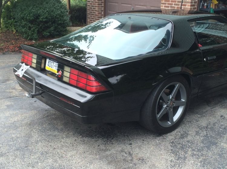

4th gen spec rear plus 5/8 slip on spacer

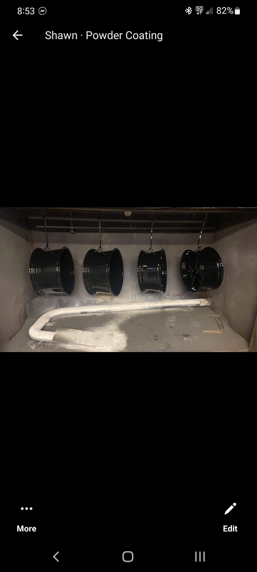

First off I wanted to say, beautiful car. Thank you for the picture. My concern was that I wasn't sure if the wheels would tuck into the fender well.
Powder coated gloss black

If 19x10 it depends on tire size some, but will have to hammer the front of the well to gain the clearance to really tuck them. I had the 5/8 spacer to get it about even with lip.
