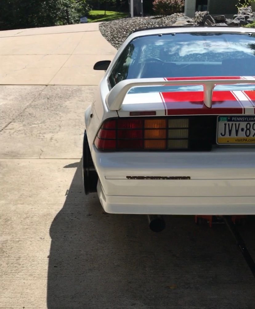

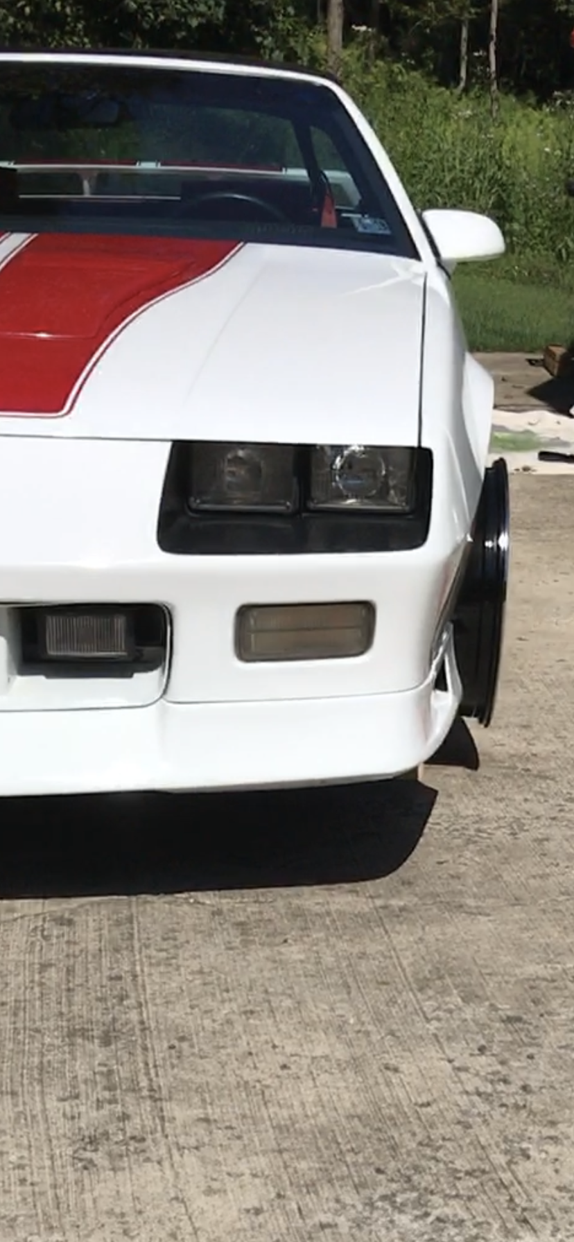

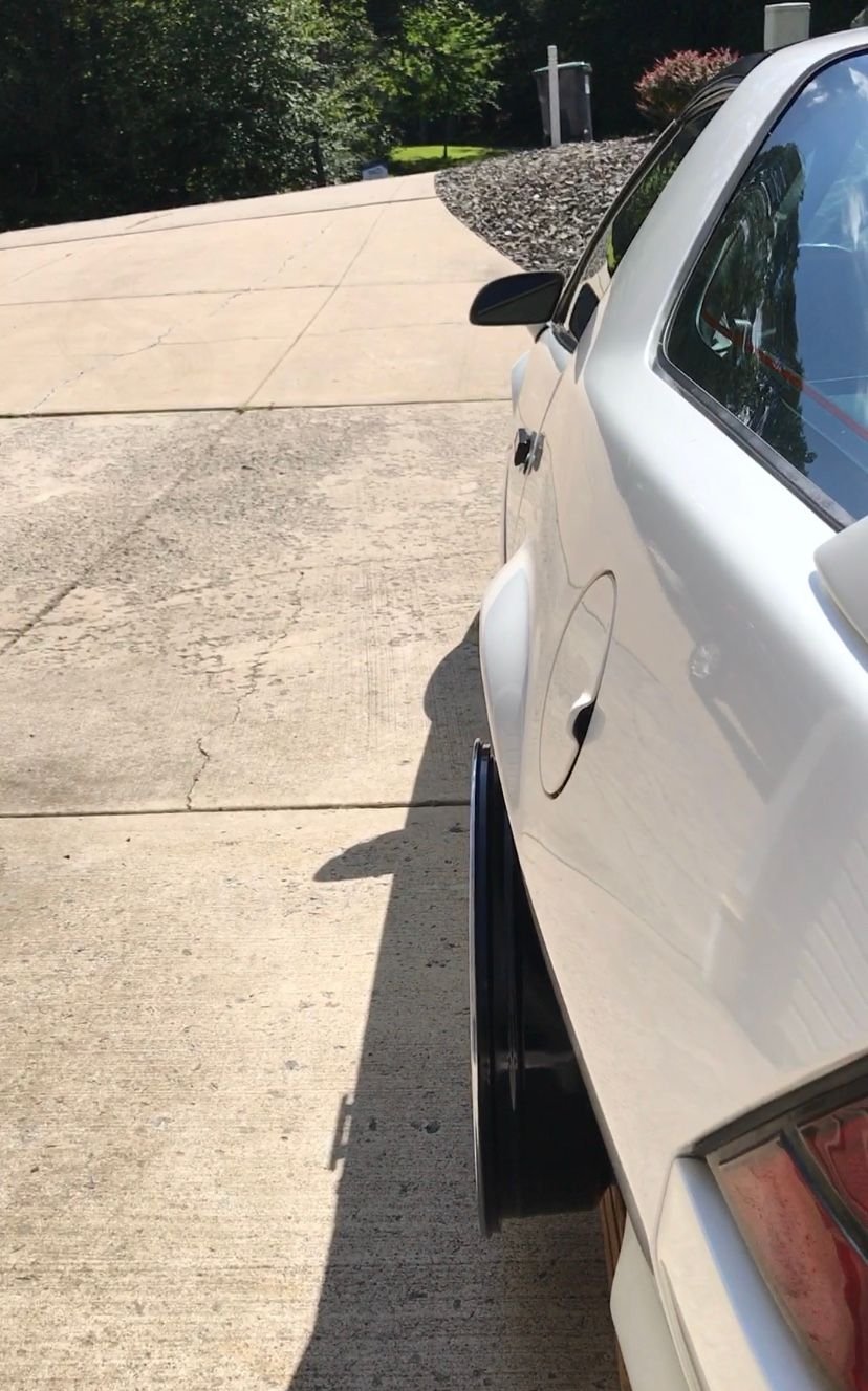

All of the 18x10.5 in the 5x120 pattern are +20 offset. The black car (dbltke) has a few more mods done to his suspension (lcarbs, camber plates, weight jacks) and metal clearance than mine, and his front tire is a 245 that is very stretched with a pretty heavy camber. The 2" spacers were for a set of 4th gen wheels I believe, with the XXR he ran a 1 1/4 front and 3/8 rear. https://www.thirdgen.org/forums/memb...ml#post5923612
The first picture is stock IROC wheel with the factory slip on spacer and 245/50/16, second is XXR (all 285/35) with no spacer, and third is with a 1" adapter/spacer. Front has a 1 1/4" adapter/spacer.
