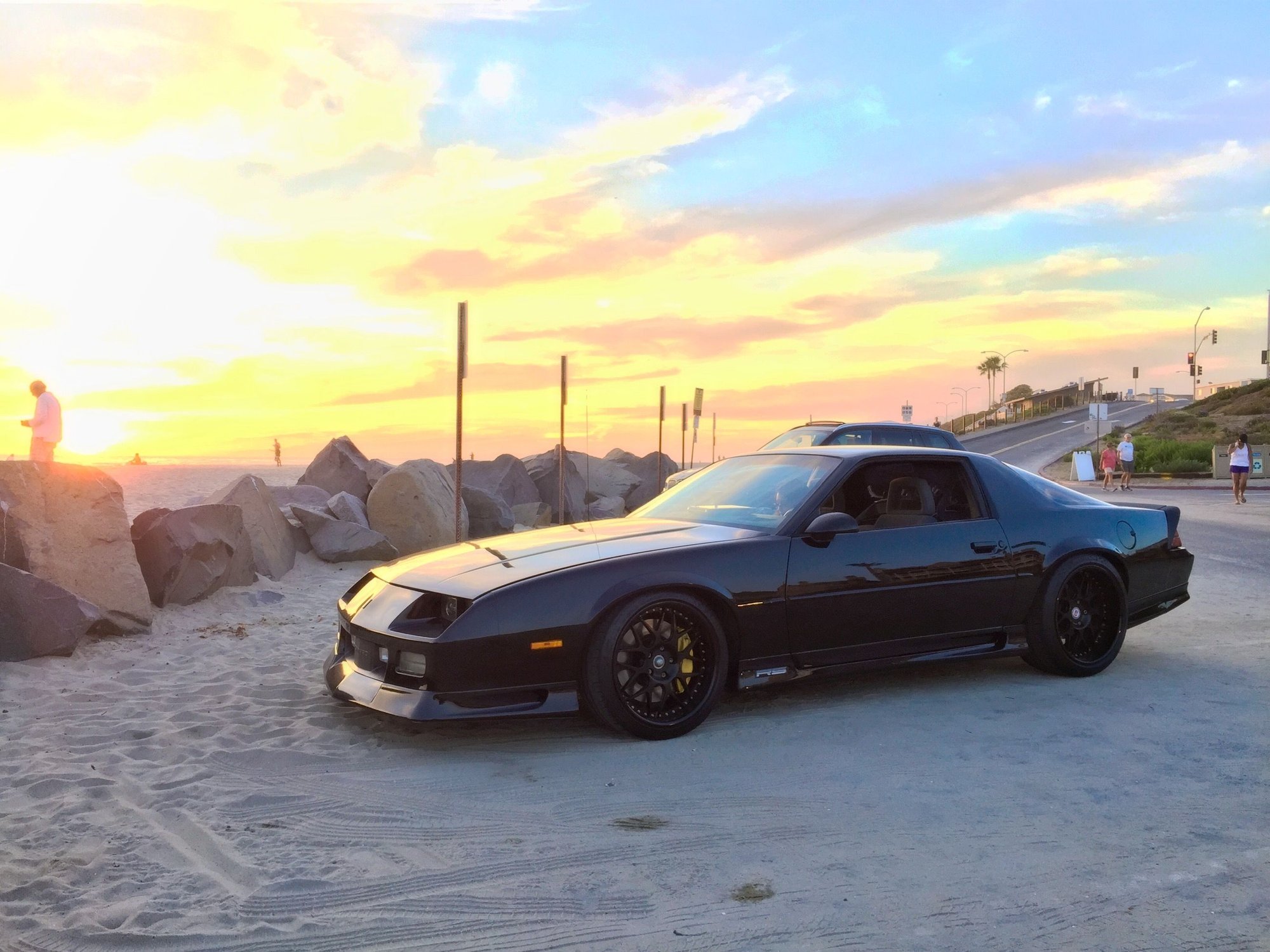

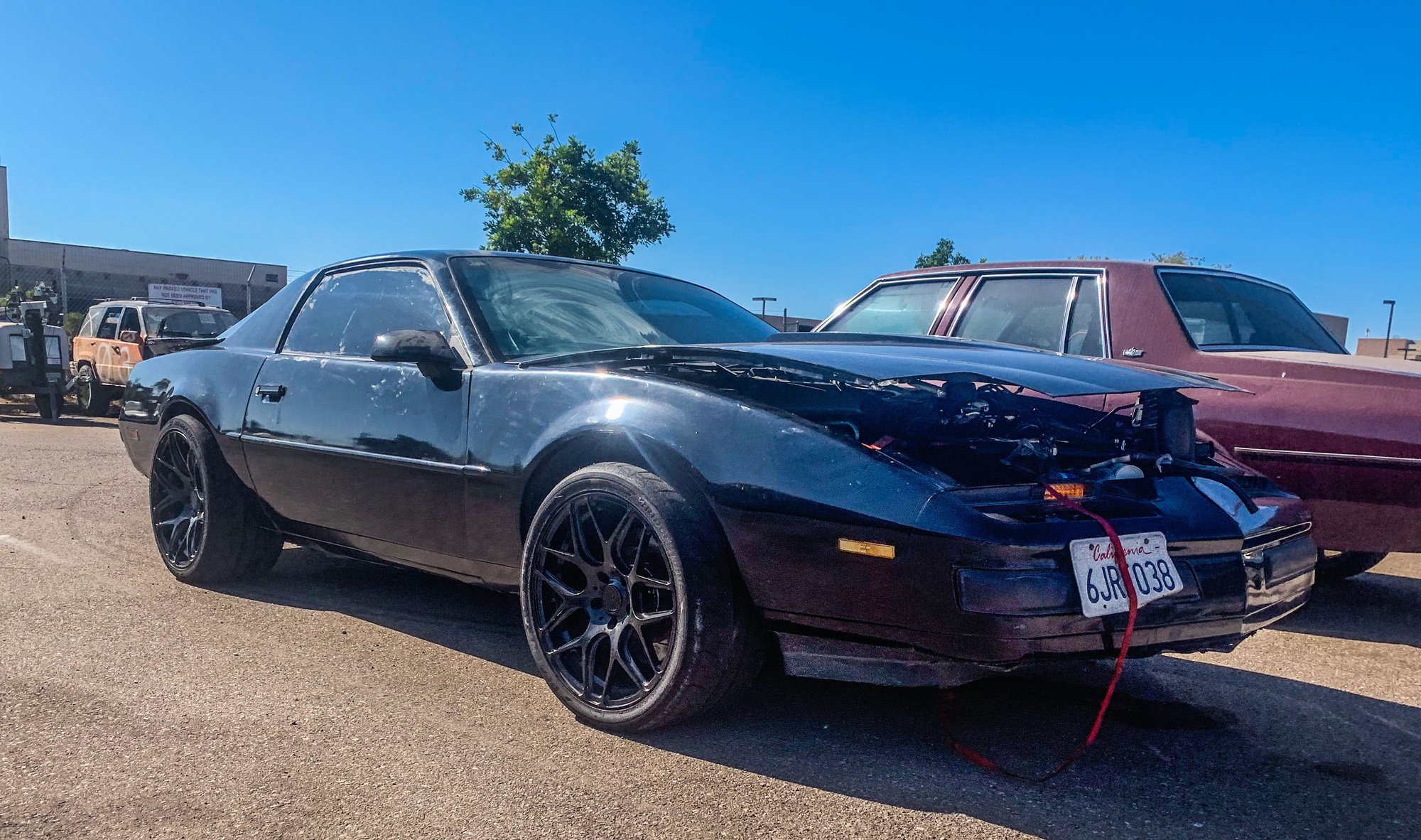

yes I’ve ran few 19s not on here much but I’ll post another project with 19x11 and 10.5
not here much anymore but I peep in from time to time now I may start to be active again on here when I can if you guys have any questions let me know
i played around with a lot of wheels and from lowered to not lowered square not square etc
I prefer taller tires as I feel it has better proportions and fill in the wheel wells better with out having to lower car significantly to pull off look
