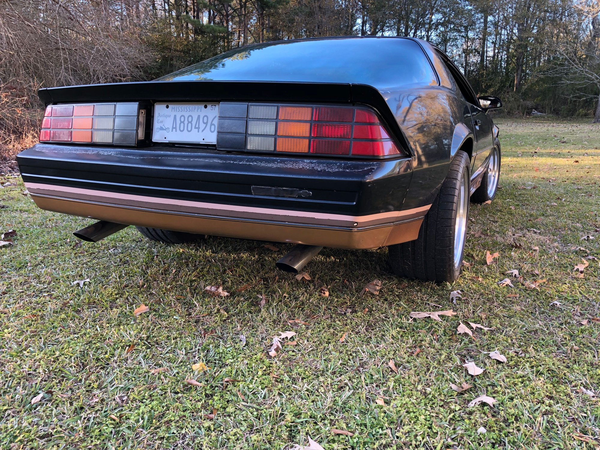

18x10's out back. Had them a long long time now, if memory serves 6.5 BS. No spacer on the rears, and you can barely fit a finger between the rim/tire and the wheel well on the back side. I wanted as much lip as i could get on the rim. Fronts are 18x8, baer rebuilt spindles with a 1/4 in spacer to clear the caliper. Minor rub on full lock. Hope this helps if you're still looking for advice
Would you happen to have any more photos? She’s gorgeous
