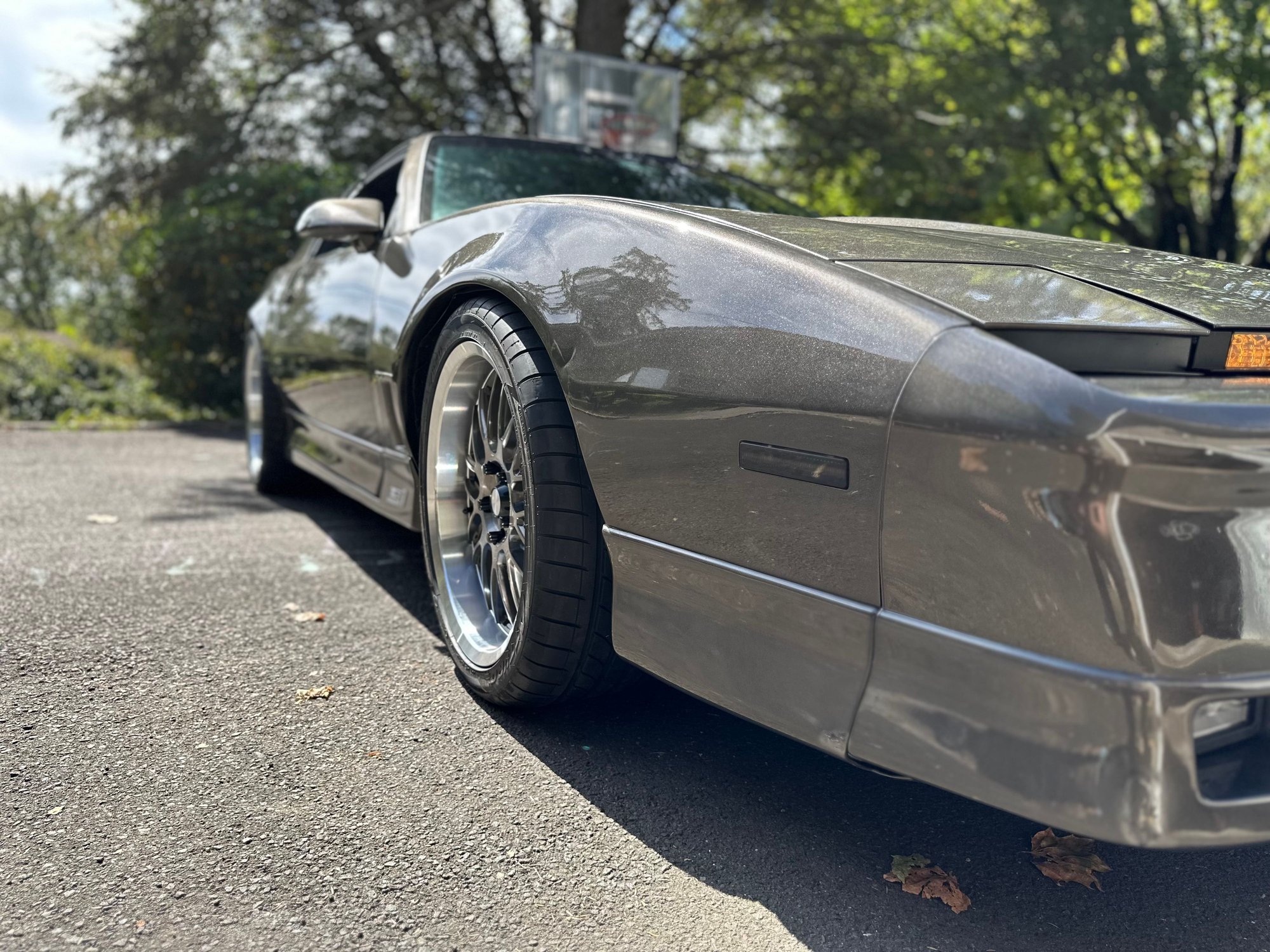

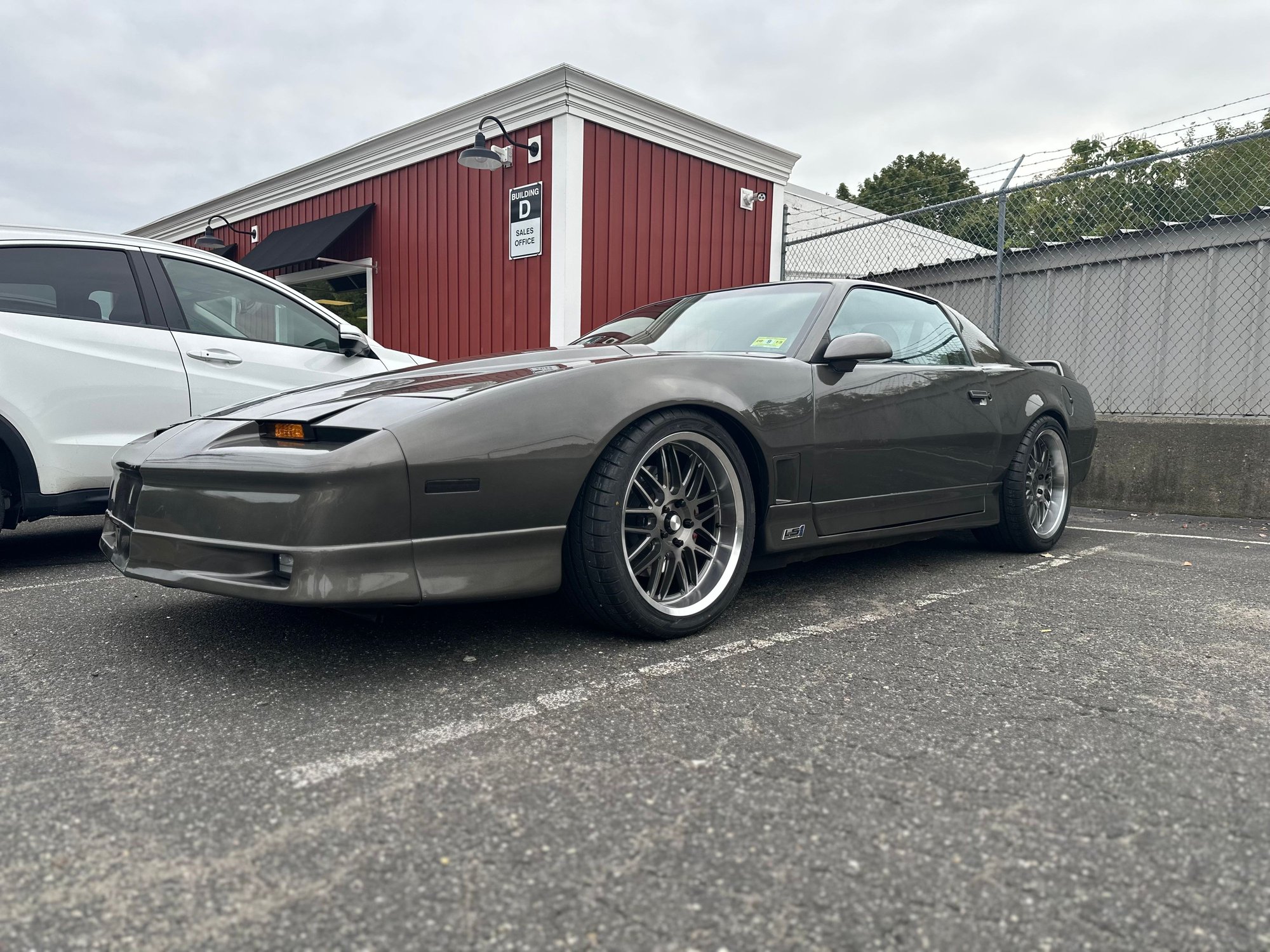

New wheels and tires are on. Went with 285/35r19 Atturo z850 summer performance tires. Backs bolted on no spacers and barely tucked. Fronts im using 3/4” or 20mm adapters for the 5x4.75 to 5x120 conversion and the 5x120 uses 14x1.5 studs so I picked up some cheap black tall ones but they are too big. I got short ones coming to replace them. I will color match the lug nuts and the front I had to get a dished center cap to clear the 3rd gen hub as it’s pushed in too far with the 3/4” adapter (I will color match that too). Car is lowered to 26” front and 26.75-26.875 on the rear. Less rubbing than I thought. I will see wear marks tonight and probably just loose the inside fender liners.

Fitment looks good from that angle. Those are 9.5" wheels with 20mm adapters? And I assume a big brake upgrade pushes the wheels out an additional 8mm? What offset are the wheels manufactured with?

That looks really good
19x9.5
5x120
+39mm offset
front I’m using 20mm adapter/spacer to convert to the 5x120 bolt pattern. I am running a BAER black label 13” rotor kit but I don’t think it’s 8mm difference. I did trim 3mm off the tip of the BAER hub wheel studs to clear the backside of the wheels which have 2.5mm recesses. The Baer wheel studs have speed tips so like 4mm of un threaded tip which is what I hacked off.
Rear is a crown Vic 8.8 which is 3” total width wider than the 3rd gen… basically the same as having a 1.5”
spacer on each side. I redrilled the stock axles to the 5x4.75 and run that with Dorman extended studs. I’m running no spacers on the rear, wheels are direct to the rotor.
put 40 miles on it today… very little rubbing. Prob just the liners and maybe the air dam. On bumps and stuff.
