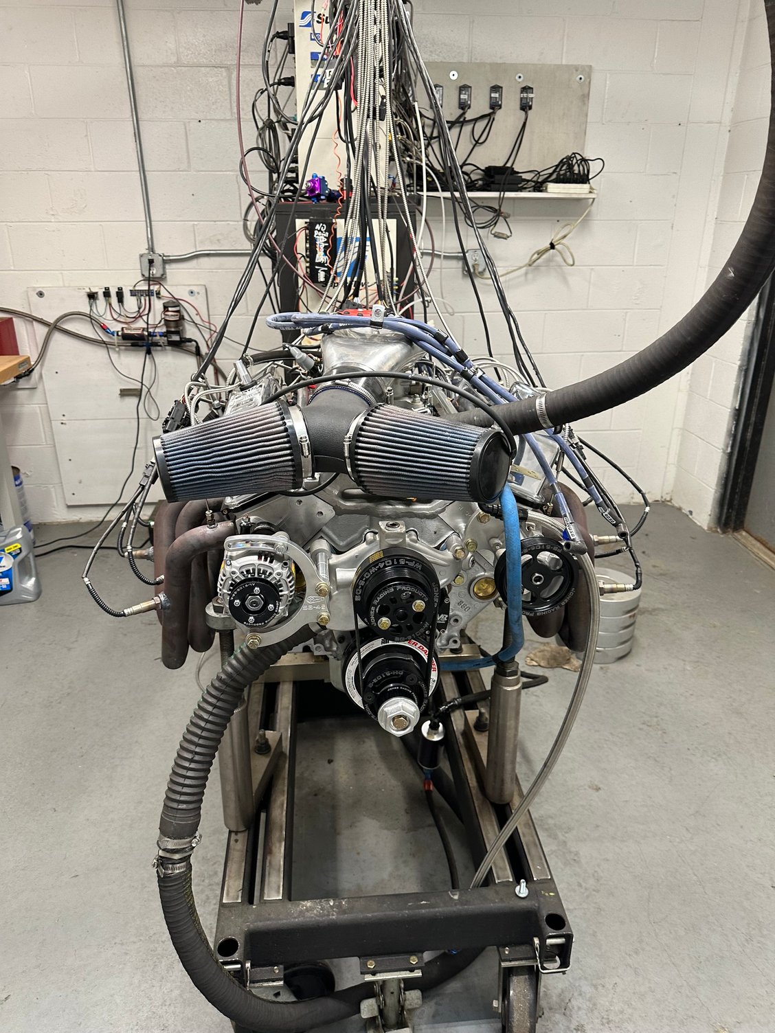

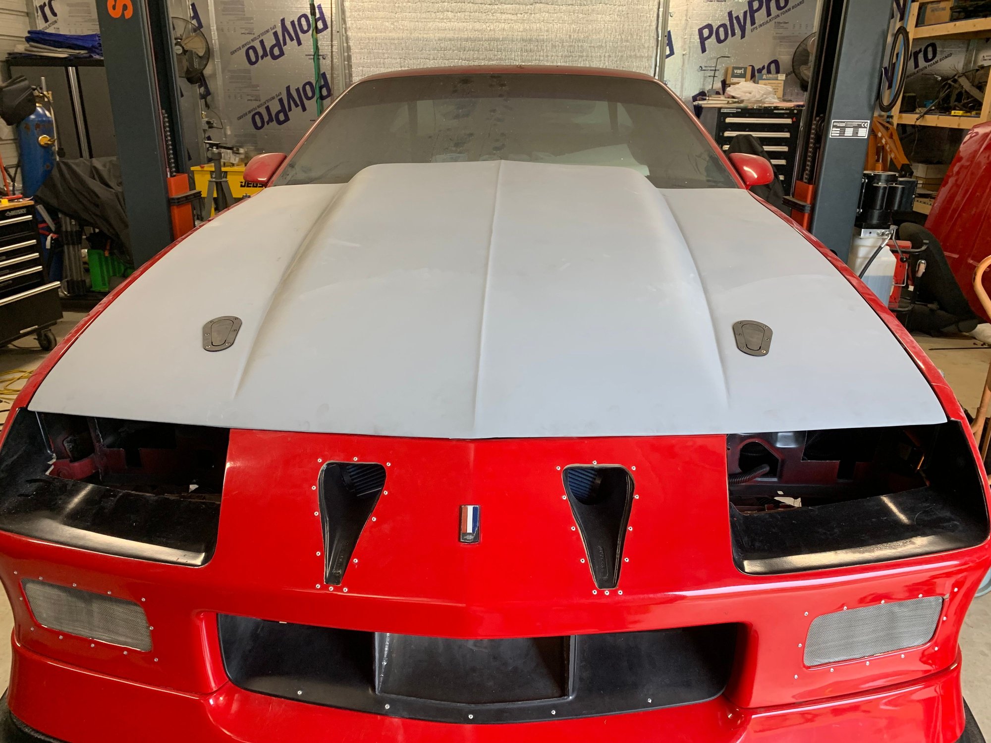

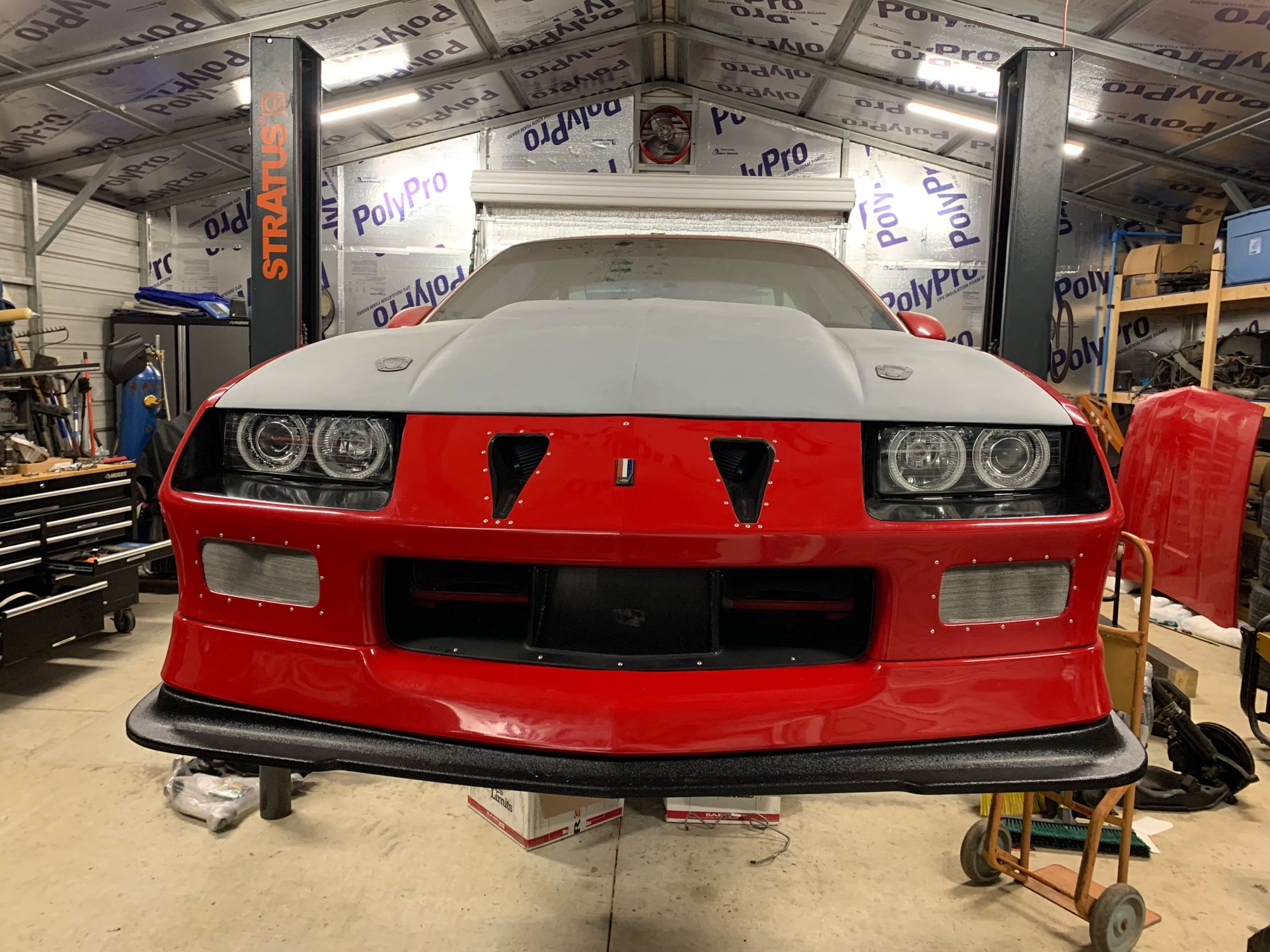

2002 Volant corvette intake and some other custom parts all 4 inch
Plus a custom made cold air duct into the stock bezel.

Interesting fab work.
That hat/bonnet on top of your fuel system is restricting your air flow and starving the engine for air at high RPM.
too bad it’s doing exactly as i built it and making power at the exact range that the cam manufacturers spec was at, I won’t be telling the specs of my build and am not saying I have a super motor by any means. But it actually does work for the rpm range. Btw this motor doesn’t even have crazy lobe separation, duration or lift. If I wanted higher rpm I would’ve done those things, but this is just a street motor. I wouldn’t be showing a real race set up when most people who chime are just blowing smoke and can’t back it up with real test data.

Originally Posted by Tombowman89
I won’t be telling the specs of my build ...
Because getting (only) 390hp out of an SBC is a closely guarded secret?

Your right? Not really but I’ll let you have this one since “sometimes you can’t teach an Old Dog new tricks”.
The numbers that matter are the columns CHP. CLB concerning Flywheel HP and TQ. Again I’m not concerned with my numbers because I already made more without even pushing and I compare that against guys like BPE, GM and whoever so sftu. There actually is more power potential with the motor but the ECU being used only allows fuel and timing adjustments at 3 different pedal positions in a Edelbrock ProFlo4 anyways. But I’m sure with your vast experience in reading dyno data would you even know where to find this at anyways.
