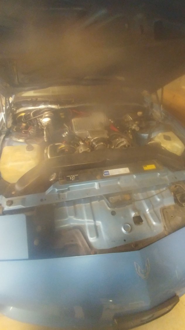

How much of a restriction is a superram with forced induction? Currently running a 358 with fastburn heads, zz409 cam and a superram. Heads and intake base portet to 1206 size. Its a blast on the street but im ready to boost. . i have a set of factory stock 867 pontiac heads that will drop compression and flow waaay mote but im afraid the superram will choke it. I can go single plane but i think im gonna lose on the tq side, and its primarily a street/weekend toy. Whats the experts thoughts? Open to any suggestions
thanks

How much power you want to make? With a centri blower pulley’d right, it wont be that much of a restriction and can extend your rpm range if boost is increasing linearly with rpm
did a d1sc blower on a 383 tpi motor and it was making 530whp/550 wtq by 8 psi and like 4800-5000 rpm pulling to 6000. At 4000-4500 i think it made 7-8 psi and by 6000 was making 12 psi. I wouldnt call it a restriction really, it creates a different type of power band and plenty to risk your stock block imo
single plane may make alot more rpm and power up top and make less down low
