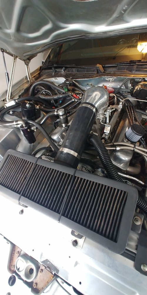

I been working on this car and its ready to hit the road in the next few weeks, dyno day on the 27th of April. Previous owner had lingenfelter intake elbow with 58mm TB on it and a stock rubber intake hose with why I dont know a 3"-2.5" pipe inside of it. Im sure it was choking it because he said at wot it still had a little intake vacuum on the dyno pulls. It made 440rwhp and 450 rwtq. Since acquiring the car I put on speedmaster 1200 cfm TB, extreme velocity intake hat 3.5" opening with 3.5" intake rubber tube to the ram air box. It still has a sucking noise at idle but im hoping thats just this large 436 SBC inhaling profusely. I had a trailblazer ss that had a 4 inch intake but that was still larger than the stock throttle body yet that thing ran like an untamed animal 12.27@112 with just bolt ons. Am I leaving hp and tq on the table?! I'm hoping(460hp 465tq) it picked up a few hp as its running much better now that I fixed the injector timing(new 48# injectors also) in accel dfi tune, and the previous over had one of the fuel tables totally backwards and it would tip in terrible and stumble. If it dont put out the numbers ill take the hat off and run the TB wide open lol just like I used to do with 383 carb setup in my previous 88 GTA. Any one with a single plane efi with big cube SBC have any thoughts on this or some pics would help also.

Only one way to find out but do some pulls and check vacuum at wot. If if air fuel changed
ram air effect can overcome some lack of area. On a dyno run you dont have ram air effect so it may pick up on the dyno but not as much while actually running at speed down the track
but imo it needs all the air flow it can get so bigger is only going to be helpful. It wont hurt

I may run into you up there at some point (I'm in Central Jersey). I agree with Justin though, if you have access to datalogging, do a quick pull as is and check your kPa, then remove the intake w/bonnet and see if your kPa changed by doing another quick pull, and check to see if your air/fuel has leaned out throughout. Engine sounds very healthy...

....rather than a datalog, couldn't you simply check your dyno/HP numbers without the filter/tube/intake on it? -not that there's a good reason NOT to run a DL....

Well the results are in. Im not dissapointed or surprised but I didn't get a chance to pull the intake tube off for second dyno run and didnt get a chance to data log cause old ibm laptop takes too long to boot up. 420 hp 440 tq with heavy 19" wheels(70# ea.) which can drop dyno # 35 hp or more compared to light 17's or 15 " drag wheels.

Good numbers to start but without datalog or air fuel its hard to say if it can be improved.
im not sure i buy the wheels changing numbers that much but tires and gearing do change slightly so maybe it’s possible.

Previous dyno numbers in 2006 were with 3.23 or 3.42 gears in 4th gen rear on light 17" wheels with an aluminum driveshaft afr's in the low 12's.
Now its got a ford 9" -35 spline 4.11 gear steel driveshaft heavy 19" wheels but a larger TB. Peak HP and TQ are just about identical. With the new drivetrain losses if it had the old rear & wheels etc, im guessing it would have been in the 450-460hp and 470-480tq range. Both were on dynojets at similar times of the years so temp change isnt much of a factor yet every dyno puts out different #'s. Ive seen cars lose 20 hp & tq on dyno with 15# heavier wheels
Im happy for now and I'm confident I can run with 15" wheels with hoosier QTP's into the high 10 sec zone in the 1/4.

Yeah 9” has alot more loss. I’ve seen some cars not lose any power with different wheels tires. Lol it all depends
