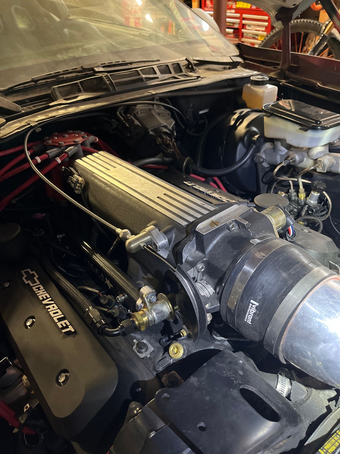

Tom 400 CFI's Avatar
Joined: Oct 2000
Posts: 3,231
Likes: 806
From: Park City, UT
Engine: LT1, L400
Transmission: ZF6, T5
Axle/Gears: 3.45, 3.31
Re: Offshore pro flo xt knockoff
Yep. I was thinking EGR plate, but this pic shows the idle control device on the side of the TB...
