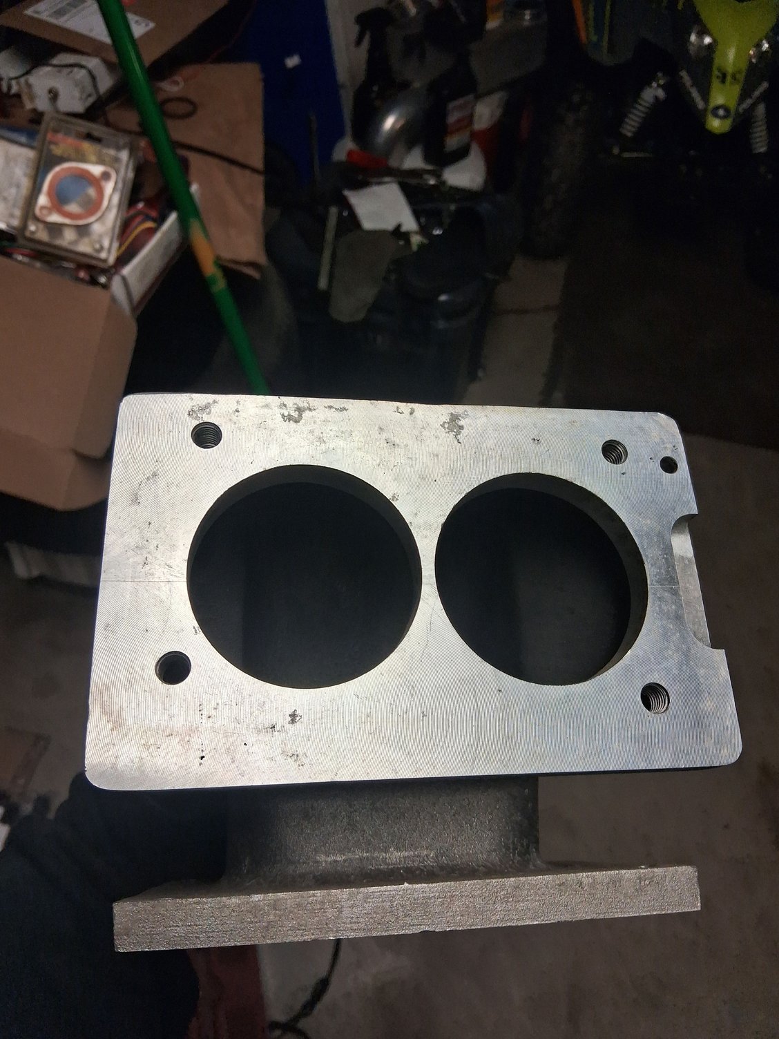

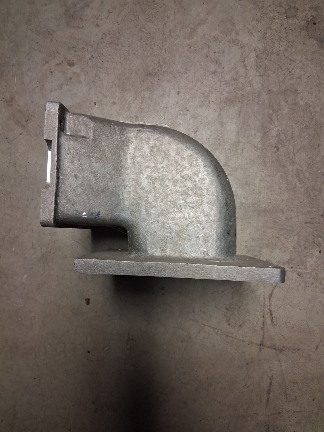

As a heads up (something I didn't think about at least), it probably won't be a 1-to-1 swap. Unless you can find a way to use the TPI throttle body, you'll likely be using an LS style.
That means different TPS and IAC connectors, different throttle cable, cruise control changes, new intake piping, and maybe some stuff I'm forgetting. None of that is unsurmountable, but it is extra work and stuff adds up. At least you don't have an auto - if you had to figure out a TV setup that was geometrically correct, hooked right to the TB, and cleared the hood, I'd probably say it's not worth it.
Also, you'll want to check hood clearance. Might be fine, but the single plane + elbow (or TB hat) is taller than you might expect.

I do have a tb elbow. Hood clearance may be an issue. I agree

Where on earth did you find that elbow?

I have quite a collection of oddball parts from over the years
