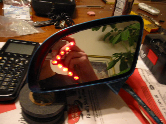

I was bored today and i decided to modify my mirrors on my car. I'm not done yet, I still need resistors to install it in my car. The passenger mirror is next. What do you guys think? I think I am the first person to do this.

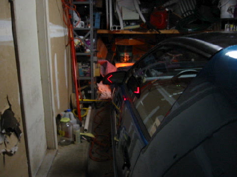

One in the dark...

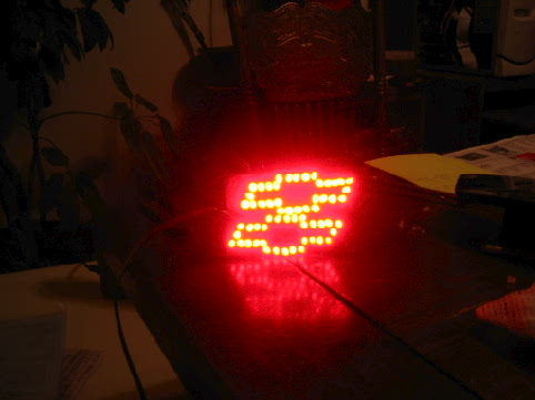

Ok, here is my other mod I did tonight. This one has been done before. Tell me what you guys think?

wow thats really awesome .. that looks so good ... nice work

mirrors=cool
brake lite=botched bowtie... looks out of place.

Thats pretty sweet dude. The mirrors are pretty innovative and the brakelight is cool too except for one thing, you have the Bowtie sticker on backwards
the left edge should be leaning back, not forward.

What does the mirror look like with the arrow turned off?

harry, that looks wonderful.
how hard would it be to do a set of mirrors?
i'm thinking i'd like to do a set myself over the summer.

how the hell did u do that to the mirrors?

hah i know exactly how u did that on the side mirrors, good idea.

Ok, Ok I fixed the bowtie. That was a dumb mistake.

The mirror looks completely stock when its turned off

I like the mirrors. I don't like the bowtie. Even after you turned it around, you didn't really get it very straight. But... the mirrors are definately cool.

i don't like the turn signals on the mirrors. i've seen that on a bunch of newer suv's.

They're cool and a safety feature, but I'd rather put turn sigs in my rocker panel GFX or something else. Like u said too many SUVs running around with the mirror lights...

I got the drivers side mirror on my car. Looks good. I dont' have my camera so i'll get pics up soon. I'm starting on the passengers side tonight. I'm thinking of writing a tech article on how to do this. I'm doing burnouts4evers mirrors after i'm finished with mine, i'll take more pics of the process with his.
Here's how I did this-
1) Remove the mirrors from your car.
2) Some how remove the mirror from the plastic backing, buy new ones, or drill the plastic backing with a dremel . The mirror has to be a 2 way mirror so the light will shine through. Which the stock ones are anyway.
3) If you bought new mirrors or removed stock ones, you'll need to cut a Chevron in the plastic backing.
4) Re-install the mirror.
5) Next I cut a sheet of lexan to hold the led's, i also cut it in the shape of a chevron.
6) Drill holes in the lexan to hold the led's
7) Solder the led's, and use the apropriate resistors.
8) Use Epoxy or some sort of glue to secure the lexan with the led's to the plastic backing.
9) Run wires from led through the mirror housing.
10) install mirrors back on car and wire up the mirrors to the turn signals
Thats a quick version of what I did. I used 1000mcd red led's, nine of them each mirror. I'd recommend use a higher mcd led because the 2-way mirror and how it darkens the led.
I hope this helps everyone.

Update- I got everything install on my car and its working fine. The mirrors look really good. The Led bowtie is pretty bright for using only 1000mcd leds. All in all i spent about $15 for 100 leds, and another 10-20 for glue, replacement mirror, resistors, etc. Next I am starting on burnouts4evers mirrors, gauges, and 3rd brake light. I'll take pictures of the process' if anyone wants to see them.
