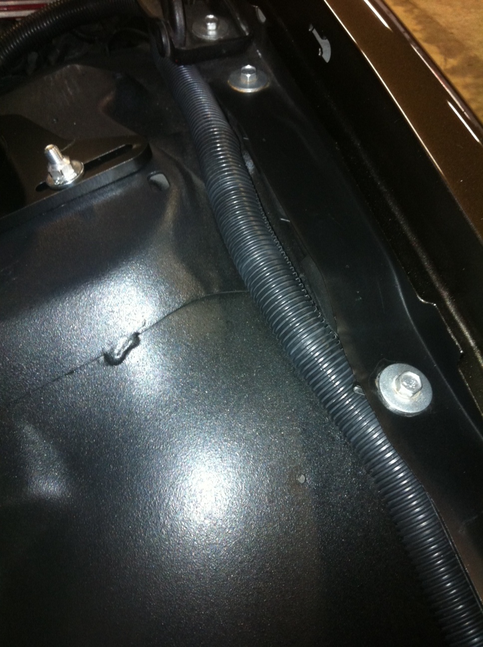

what did you paint the engine bay with?
Old Sep 11, 2012 | 05:07 PM
prossi's Avatar
Joined: Dec 2011
Posts: 197
Re: thought id share some engine detailing pics
first i took everything apart, sandblasted any pieces i could and then sanded down the engine compartment, i then painted it all satin black and after that i taped off what i wanted and sprayed the wheel wells, core support, hood hinges, and nose filler panel with a light coat of line-x premium. ive used it on several cars weve built and the look is really nice when sprayed a certain way. you have to almost dust it on with the gun instead of pointing directly and spraying, the texture comes out fine not like what your used to seeing with spray on bedliner coatings. the downside is you end up wasting alot of it.Heres a couple close up pics

nice engine bay, and your painter does very nice work. nice choice on the colour
