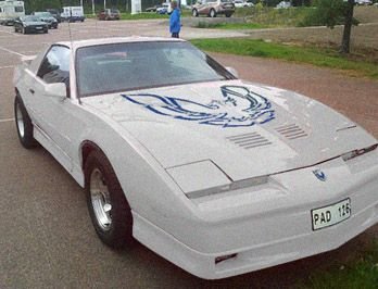

i have it as pdf, some different versions if You need it. Might have changed some tiny detail, cant remember. i went to a local place who cut it in gold vinyl for me. i think you can check it in my pictures.

Looks nice!
Wow, that's different. You too NCC-1701, er, 2539 or whoever
I always thought the white/red & orange trim as well as the white/blue trim late 2nd gen Z28's were sharp, so I wouldn't mind seeing what an orange or blue bird on a white car looks like. ANYONE?

Quick and dirty photoshop on laptop
