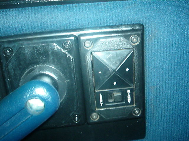

Speaking of adding mirrors can I add this switch to operate the drivers side mirror.The 1 in in the middle works fine but only for the passanger side,I thought it would be easy to just bypass the drivers side mirror to that switch I found in a 82 camaro,what do you guys think?I havent wired anything yet ,just wanted to see how it looks 1st and get your opinions

While in the spirit of ball busting, his information isn't exactly accurate. The 88 SC had body colored side view mirrors, as did the Berlinettas.
